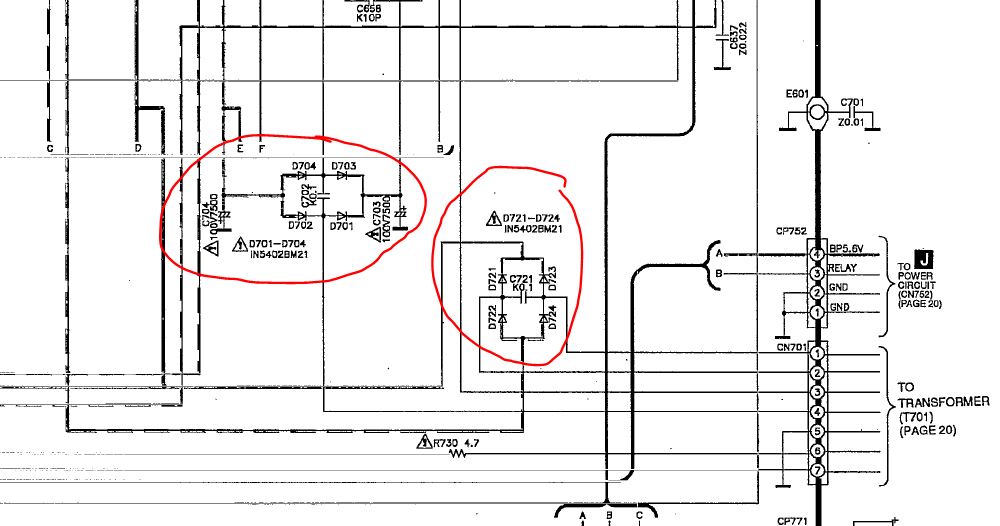

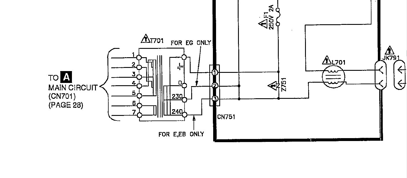

The transformer was shown on one diagram, the circuitry it connects to on another page as I recall.

I don´t understand why do I need rectifier if I want to use it with a board, that accepts DC current, and this power supply gives out DC. I understand this is needed, if I would use toroidal transformer. Am I correct?
Now coming back to not understanding the scematics. Yes I found where the power supply is, but I cant figure out the outputs. I got 5 pins. I understand the first one is -12, the second one is +12, fith one is ground, but I can´t figure out what are 3,4 and 6,7.
Did a little scetch.+ and - are probably not correct. I used LJM L15D pro schematics.
The mains transformer gives out AC voltages. These need to be rectified (changed to DC) and then smoothed out to give clean DC before they can be used to power any audio circuits.
If you apply AC direct to an amplifier then it will just instantly blow itself to pieces.
This shows the transformer and the power supply. The reservoir caps for the first diode bridge are off the page. That looks to be a low voltage supply for the small signal parts of the receiver.
