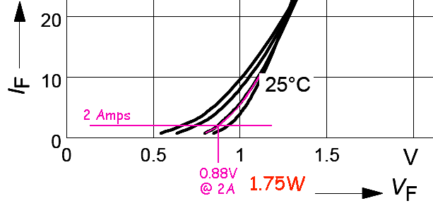

At 2 Amps the forward voltage is around 0.9V. So 1.8 Watts.
Thermal resistance, junction - ambient, leaded RthJA - - 62 K/W
So 1.8W*62C/W is 112 degrees C rise, easily 140 deg C in a warm room inside a warm box.
This will burn flesh at a touch.
Tjmax is 175 deg C so it is technically within ratings.
Um . . no, the power dissipation is right there in the data sheet -- Vf * If -- about 3/4 of a volt at 1 or 2 Amps. So about 1-1/2 Watts, which a TO-220 package can dissipate with no, or minimal - say a short 'flag' or some such - heat sink, and stay well below the 175C temp limit.

...The graph needs a little guess-timating 'cause the part is so massively overrated...
Yes, we squint, but we may be squinting smaller than the factory draftman felt he was paid to squint.
Squinting too small, I now claim I see 0.88V at 2A. 1.75W. Yes, a naked TO220 can throw this for many hours. But don't put your finger on it! Or bet that it will be problem-free for years. IMHO, the failure of a slow-cooked rectifier may be Dead Short, smoking your transformer. Maybe while you are away, panicking your lover or dog.
(Yes, voltage drop is lower when the chip gets HOT. The effect is small and I prefer to ignore it for added conservatism.)

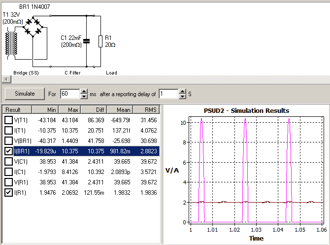

BUT: if the load is really 2A *DC*, the RMS value of the spikes is higher. PSUD figures 2.9A AC RMS for a 2A DC demand. This is pushing 2.5W-3W which is early-death for a naked TO220.
