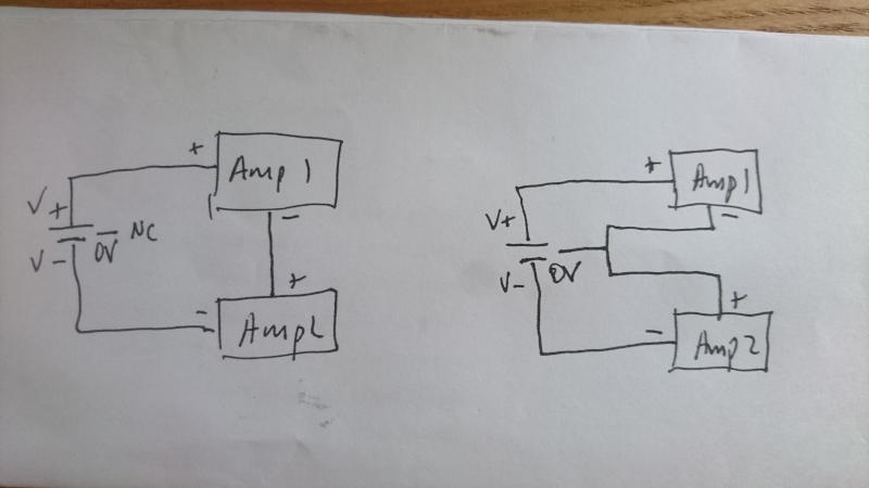

The way I see it is that the two loads are in series so they should get half the total voltage if resistance is equal. The only thing I'm not sure about is if I should be connecting the 0V to the amps or not.
Two tpa3255 based amps at 51V. I should be able to adjust the supply to +-51V.
Option 1:
Source V+ -> amp 1 V+
Amp 1 V- -> Amp 2 V+
Amp 2 V- -> Source V-
Source 0V not connected
Option 2:
Source V+ -> Amp 1 V+
Source 0V -> Amp 1 V- and Amp 2 V+
Source V- -> Amp 2 V-

I'll never run the amps full power - I do live in an apartment and my speakers can't handle that much power anyway so power requirements are fine. Attached is a schematic of the two possible ways I can think of to connect the amps and power supply, not sure if that's what you're asking for.

The amps appear to have balanced inputs and outputs? If so, I think it should be possible (the second drawing, the first I'm not sure about) I'm not familiar with class D amps though, hopefully someone else can set you straight. Proceed with caution.

The danger is surely if audio screening is connected to amp -ve?
And also any sensing or control you might add.
If so then joining screens together (perhaps through connected equipment) will short the amp 2 supply. You would need to ensure this was never possible.

NO, you can NOT.
As described, the main output is a split supply, you can choose between +/-45 to +/-72V but that does not change the main problem that the main output bis: +V ... 0/ground ... -V.
See:
In addition to the main differential output, it has one more low-power differential output, +-24V at 200mA and one low power 24V 300mA output. All outputs are isolated from each other
So he has:
a) ONE "differential", I think they mean "split" and description confirms it :
b) ONE "differential", I think they mean "split" and description confirms it :
c) ONE (single) 24V
A/B/C are separated between them but all 3 wires in any "differential/split" supply are galvanically connected.
So you can connect one amplifier from o/ground to +V but you CAN NOT connect theother from -V to Ground , even if "inverting connections" becaiuse now its own +V will be Ground but its ground will be -V ... how will you send signal to it?
The second "ground" will be 45 to 72V DC below ground, the moment you join both grounds more than sparks will fly, think an arc welder instead , destroying everything, and even IF you used a transformer to separate grounds , the second amp will have a very dirty ground ..... if at all.

Two completely independent circuits could indeed be powered as you suggest.
We are concerned that in real life, when connecting the amps to your source equipment they are no longer independent and something will make a very expensive and potentially dangerous BANG!
