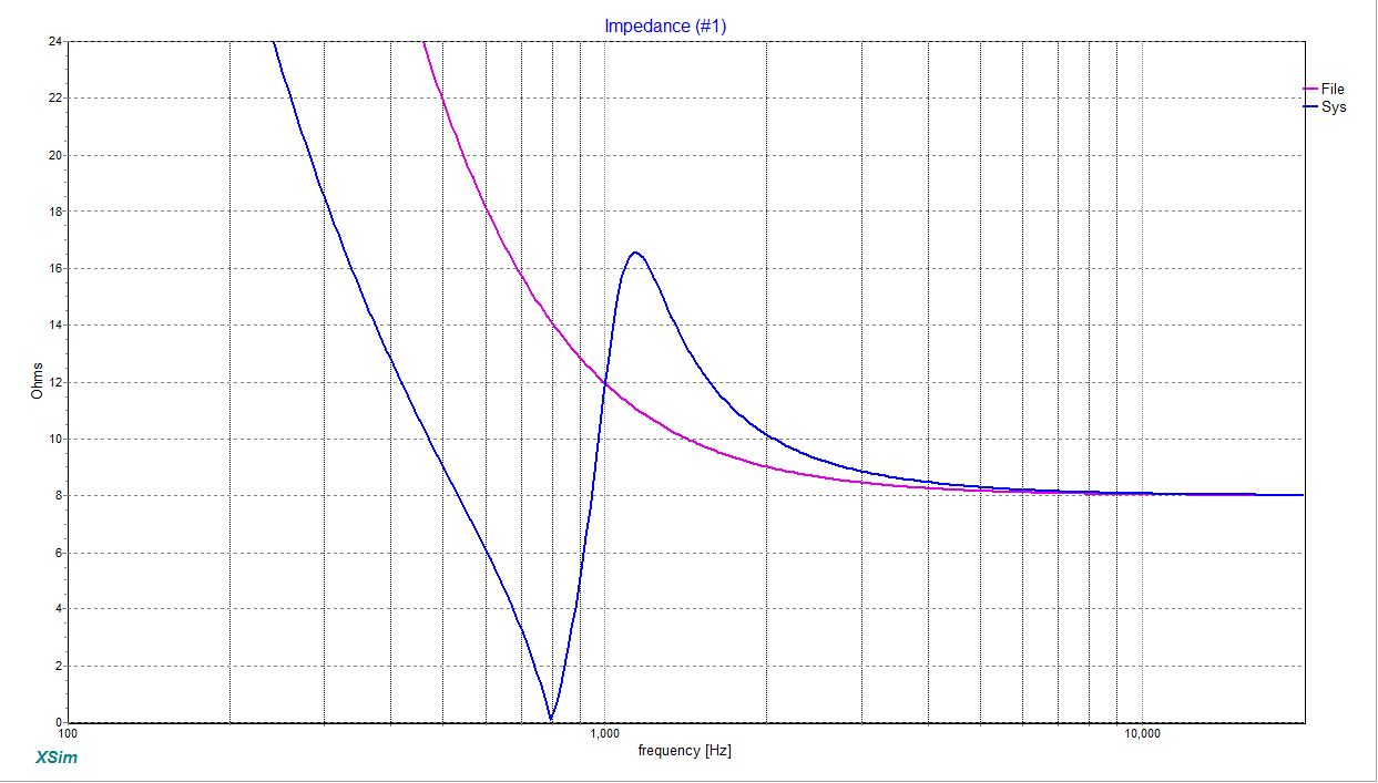

Yes, don't worry. De-solder the wire which is on the outer diameter of the bigger inductor and lift it up from the PCB.Ok thanks for the tip. Are you certain that de soldering the large inductor is safe?
You're welcome. I would have disconnected something easier instead of the inductor, either a particular wire or the capacitor. The effect would be the same, but I don't know if this is possible in this case.
Just to help make the point I've simmed the possible impedance issue from not connecting a woofer. It's probably not obvious that disconnecting something actually causes a lower impedance.
