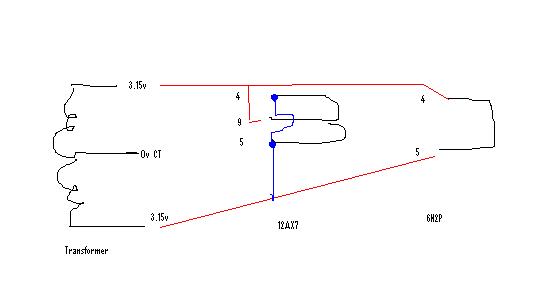

What v4lve suggested was using a switch to allow the use of a 12AX7 or a 6N2P in the same socket. My response was I need to wait for my new Tx with 6.3V heater supply because I didn't think the switch idea would work with 6.3V C.T.
Attached are sketches showing what I think v4lve was suggesting. Will all three examples work?

All three diagrams are wrong.
(1) applies 6.3V to a 12AX7 heater wired for 12.6V.
(2) does not provide a complete circuit as one leg of the secondary is left floating.
(3) applies 3.15V to a 6.3V heater.
I have described what is needed for both types of valve. Combining them is a simple exercise (hint: it needs a two pole switch). I am not convinced that a diagram would help, as I am not convinced that the OP and those seeking to help him can read diagrams.
