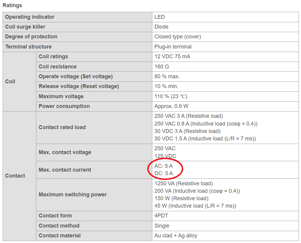

Btw, an electronic question if anybody knows: I remembered I have a bunch of Omron MY4IN 250V relays with 12V switching left after previous projects (home automation before Z-Wave and 433 mHz, when I needed to switch relays to turn on and off lights and other stuff). They are four channel double throw relays, so one would take care of the whole business. The contact current is rated at 5A, as you can see here:

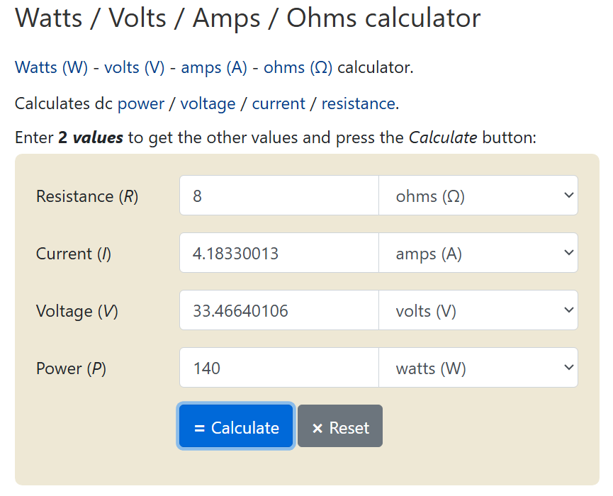

Is that enough to stand the wattage from the speakers? The most powerful, Yamaha amp is rated at 140 wpc, but I have never used it on full blast, I think the neighbours on the other side of the fjord would probably call the police then... 😂 I have no idea how to calculate watts into amps with speakers, since I have no idea of the voltage.
You don’t need the voltage. You have impedance and power: from those you can calculate volts and amps. P=V^2/R and P=I^2*R.
@ejp, thank you! Cryptonite for me, I am totally hopeless with math. But I found a calculator for that, I didn't even know that was possible. If I am correct, this should work nicely:

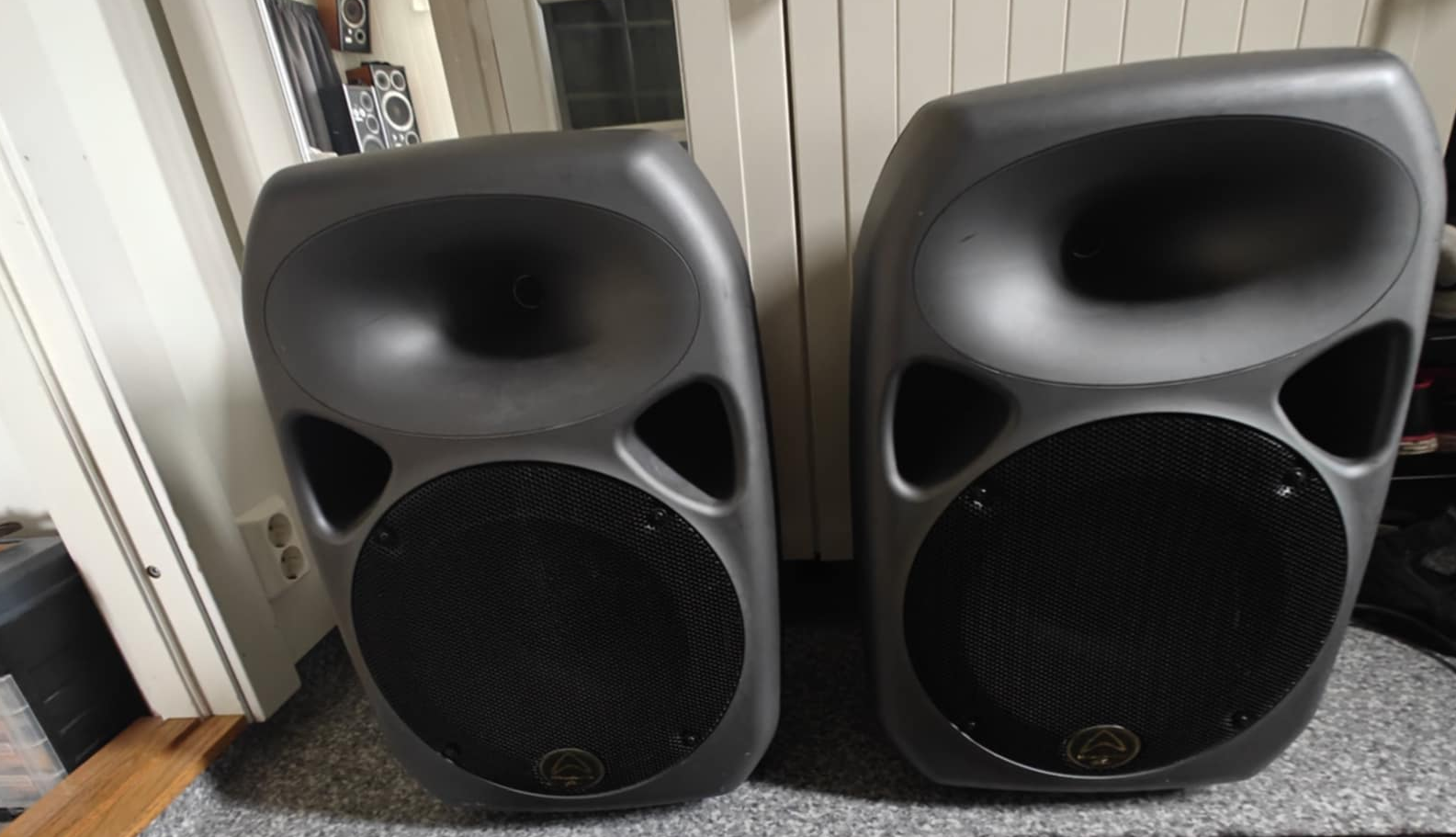

Btw here are the Wharfedale 12" PA speakers. Great for parties! Note the mirror image upper right of the Wharfedale E-series speakers that are part of my home theater/music setup. I have 16 of those in different sizes in my HT setup, with four Wharfedale active subs and four JBL (the outcasts of the setup) as height speakers in the ceiling! 😎
