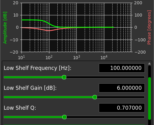

Can I call this a 3.5-way system?
Do you plan to apply a shelving filter like this?

Adding? I'm not sure what you mean (*). I'm sure it could be done but I'm concerned it might cause some damage if not done the right way. Maybe you could draw a diagram...
I suspect you mean equalising, in which case it would not make a 3.5 way.
* Filters are usually strung in series and sent to (for example) a single output...

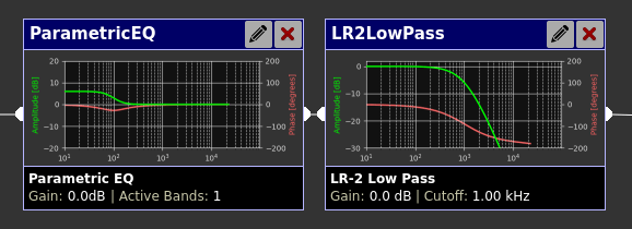

Reactions: presscot
OK I think I've got it now. You want to boost the sub100 Hz signal in the speakers.
It's just a 3-Way then.
It seems to be like the right image.
Bass below 100 Hz aren’t boosted, but are filtered by an active crossover.
My image is an active crossover.
