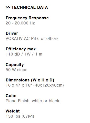

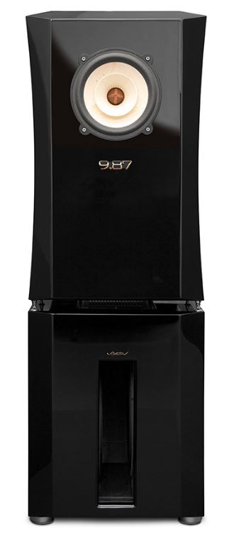

I found this system Voxativ 9.87 costing about US$40,000. You guys think a speaker system can be built to sound similar to this and I DON'T mean a clone. The website is Voxativ 9.87 SYSTEM.
One image and tech spec are attached.
Initial Thoughts
Full range driver already available: Tang Bang w8-1808 or 1772 or equivalent or similar
Ripole construction: Readily available.
It can be built based on combo passive xover and solid-state driven ripole OR active(DSP) xover. My initial thoughts it will sound quite good and outlay costs low or quite manageable. If not please explain. Thanks for your input.
Initial Thoughts

The Look of 9.87 is achievable ask a carpenter or craftsman to make one, less $5000/pair? A lot of leftovers for drivers. The main thrust of this project is to build a high-quality sounding system with adequate aesthetics, look is NOT a priority.

Haven't heard live but heard them played on Youtube difficult to judge on Youtube. I don't intend to 'duplicate' the sound and what I like is the speakers' configuration/topology. I have experience with building Full Ranger(different make of FF will give you different sound characteristics) and Ripole and I think I can make them work well together. The final sound with wide/open(particularly FF in bipole mode) with very good bass extension, the overall sound will BIG and WIDE.
One good feature about this project is that you can either spend a lot of money ie the FF driver(Lowther, Sonido)) or on the cheap eg Alpair 10.3. The Ripole is can be built too without costing heaps, there are plenty of Very cheap 15" woofers floating around, and the sound will astonish you, they will give you around 30-150 Hertz without too much effort.
