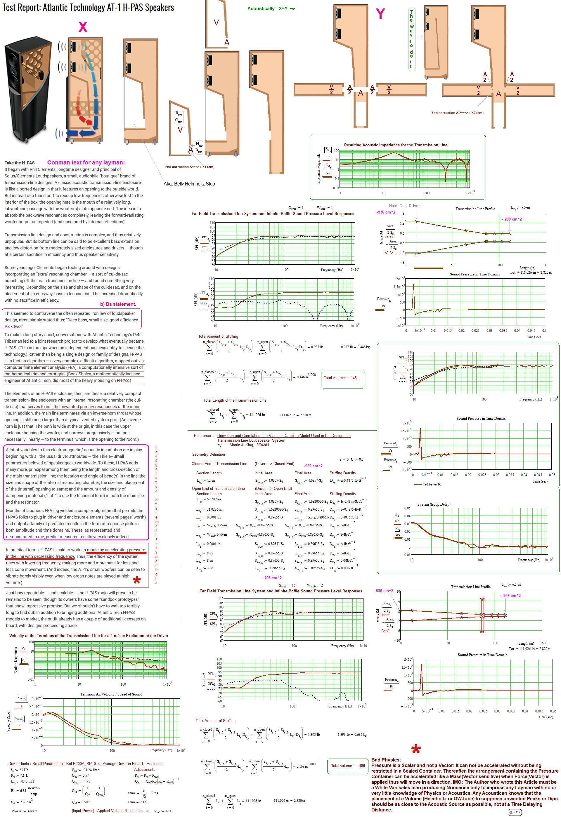

will the SH3 model with a 3 segment back loaded horn work for this type? I'll assume part of the point of this cabinet might be to avoid fill / damping material (? - Phase Research did not have fill)
Hi freddi
Yeah i've seen it before. Looks like a TL with a stub. So HR should be able to i expect
hi Zero D - here's a really crude sim - I'm not sure how to best assign values to the image above. That stub is a big proportion of Clements' designs.
freddi
I don't think the shape of the stub should make any/much difference. I would expect the volume to be more important.
Good comparison between both boxes though. But, i don't see much benefit with the H-PAS !
