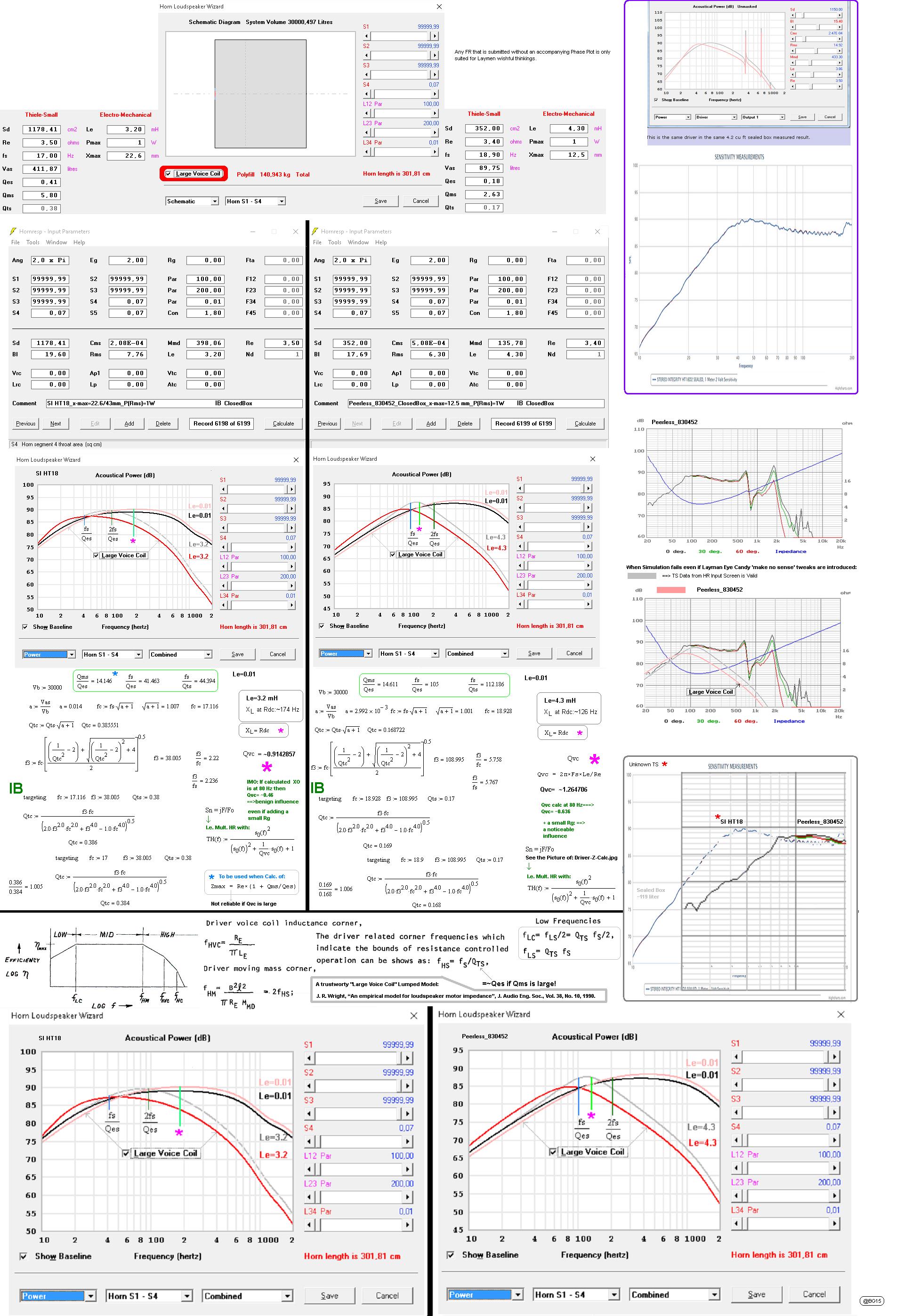

Hi All,
FYI, Op.s Driver in a T-TQWT:
b🙂
That response looks more or less spot on for my personal preferences of what I usually aim for in a modeling program response! when looking to put in into a car. The dip between 40-50 filled in nicely as that's where my car contributes the most gain. Odds are that will play flat or need cuts well down to 20hz lol. Now the question is, can a enclosure with those specs be wedged into the shape I need!

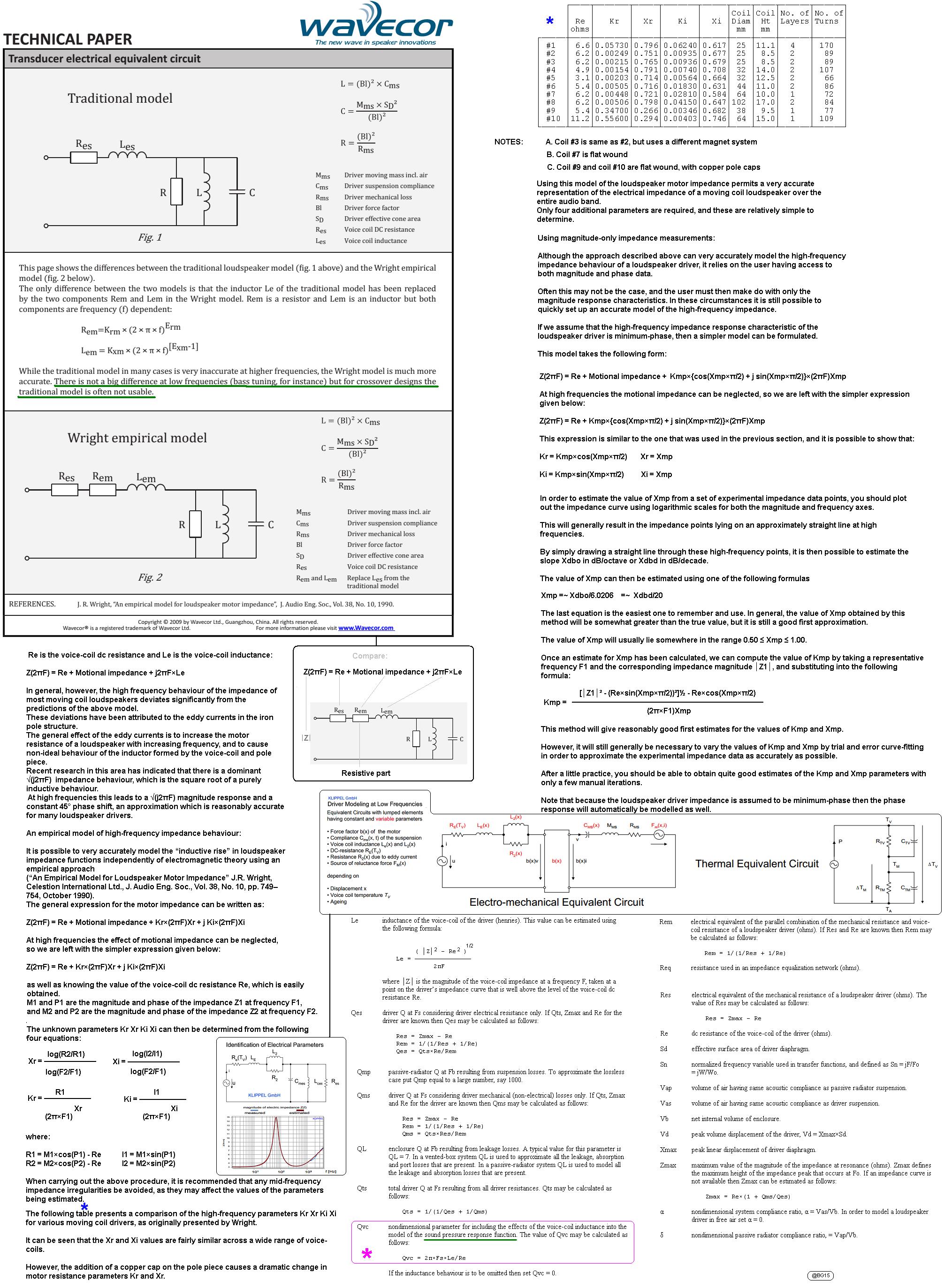

The specified Le in the first post is unbelievably low for a driver of this type. Not sure what to say. I definitely wouldn't build anything large or complex without testing it. If you could stick it in a sealed box or even on an OB (for that matter even just propped up with no baffle) and measure the response and compare to expected response you would know. If the measurement matches a sim it's good to go. If it's got any peaking or inductance humps where they are not supposed to be you need to account for that in your subsequent sims.
I don't think it's going to measure as a sim would indicate.
At the very least, can you measure t/s yourself and see what's going on with Le?

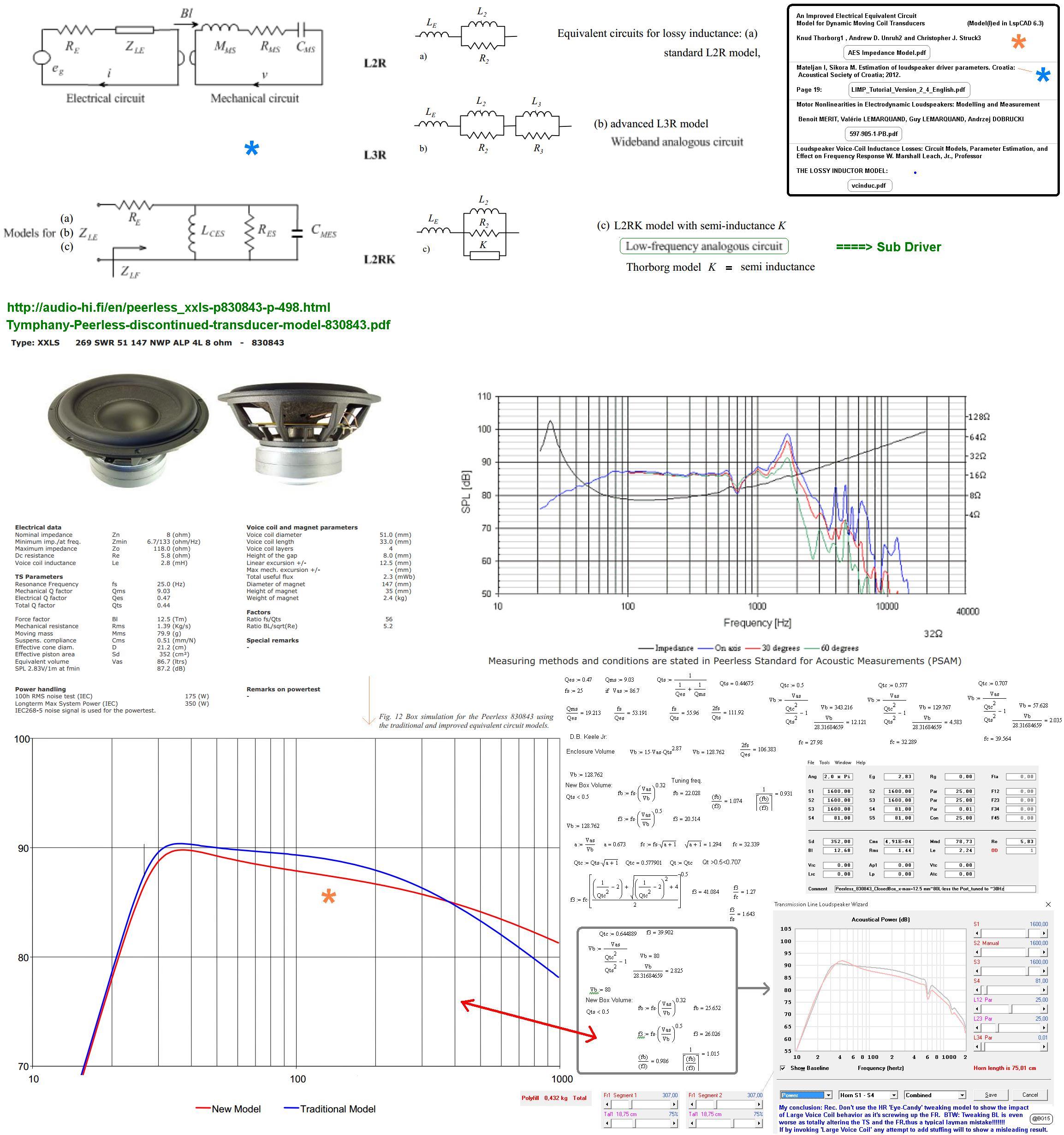

Hi All,
Agree with T3mpest regarding the Driver Z behaviour and if the Driver is measured before data is entered into HR and the difference TF between the simulated and measured is multiplied to the former:
The last FR graph would then please your Eyes...
I will not and haven't used the 'Large Voice Coil' feature as this feature should be placed at the Input Screen if to be believable.

I see you underlined "there is not a big difference in low frequencies" in the Wright inductance paper. All you have to do is look through data-bass measurements of this type of driver to see that there are indeed massive difference in the low frequencies, especially with resonant enclosures like ported boxes and tapped horns. Sims don't match measurements with this type of driver.
If you want to use the input screen to account for large coil inductance effects you can do what I do - change Bl on the input screen. My sims match measurements much better than sims that do not account for inductance. Have you read my paper? I tested 22 drivers and compared to data-bass measurements. The adjustment works every time, even on tapped horns using this type of driver.
As for your first two attachments I have no idea what you are attempting to show, as usual there's a lot of numbers with no real explanation of anything.
I do however understand "Layman Eye Candy", a phrase you used quite a few times.
I invite you to show a simulation of a tapped horn with this type of large coil driver that comes even remotely close to a measurement. I have done this and presented my findings. If you are unable to do this I don't think you are on solid ground to call me a layman. Try the Othorn tapped horn with Mach 5 Audio UXL. Good luck with that. Let me know when you get a sim that's remotely close to what Ricci measured.
My proposed method is not perfect, it does have flaws but it allows you to get a simulation that will match a measurement much closer than without using it. I proved this when I simulated EVERY SINGLE MEASUREMENT that data-bass had with this type of driver and compared my sims to the actual measurement.
