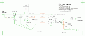

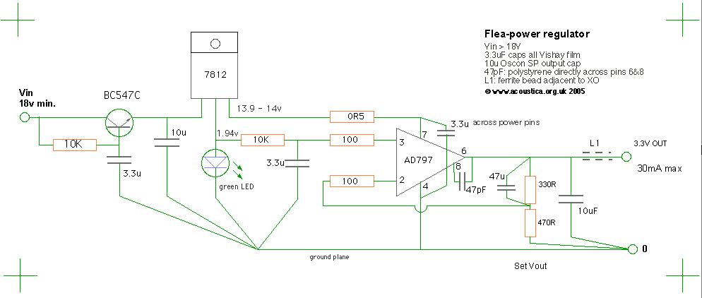

I'm going to attempt to build a EZDac and I would like to use a Flea to get the most out of the circuit. Any help is appreciated.
This is the thread that ends up the Flea thread.
http://www.pinkfishmedia.net/forum/showthread.php?t=18014
Below is the circuit.
Cheers George
