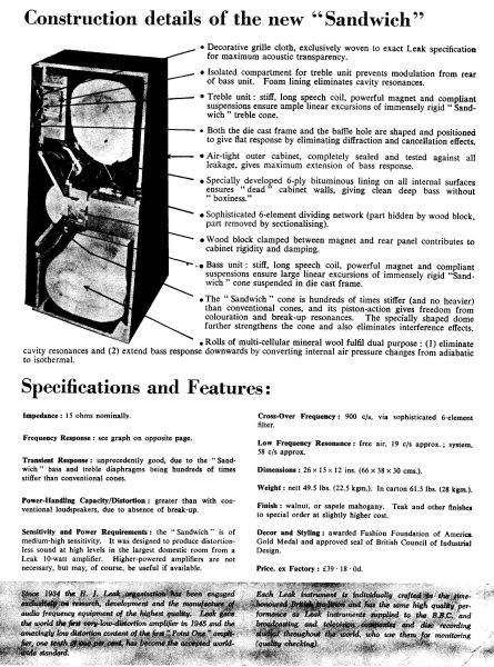

The Leak sandwich was a great idea. Why is the technique not used today? I am aware of only Focal who use the concept. I suspect it is labour intensive and hence costly. Basically 2 strong sheets of material sandwiched by a lightweight space filler. The wooden dehavilland mosquito aircraft used sheets of plywood sandwiched with balsa wood for its wings.
Here is the original publicity blurb
