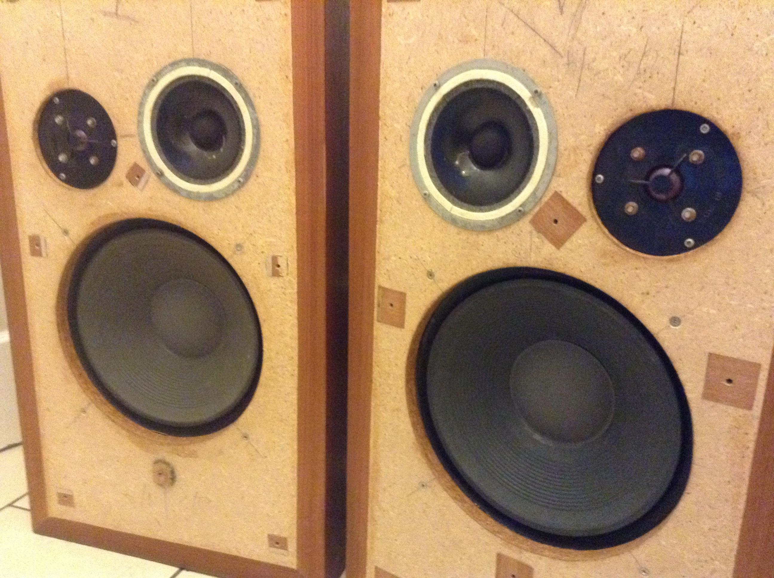

i have inherited these from my late grandfather along with a rogers cadet amp which is faulty and a shed load of other bits and bobs musically related.
i like the sound of the speakers to be honest they are large beasts and sound pretty good but cannot find a makers mark other than made in england on them..
be good to get some info to at least know what they are, look forward to hearing from you

Sure looka like a Goodmans 12” woofer. Hidden in the cyclinder is an open-back midrange, and i’d guess from lookin gat the magnet thise could be the purple dome tweeters.

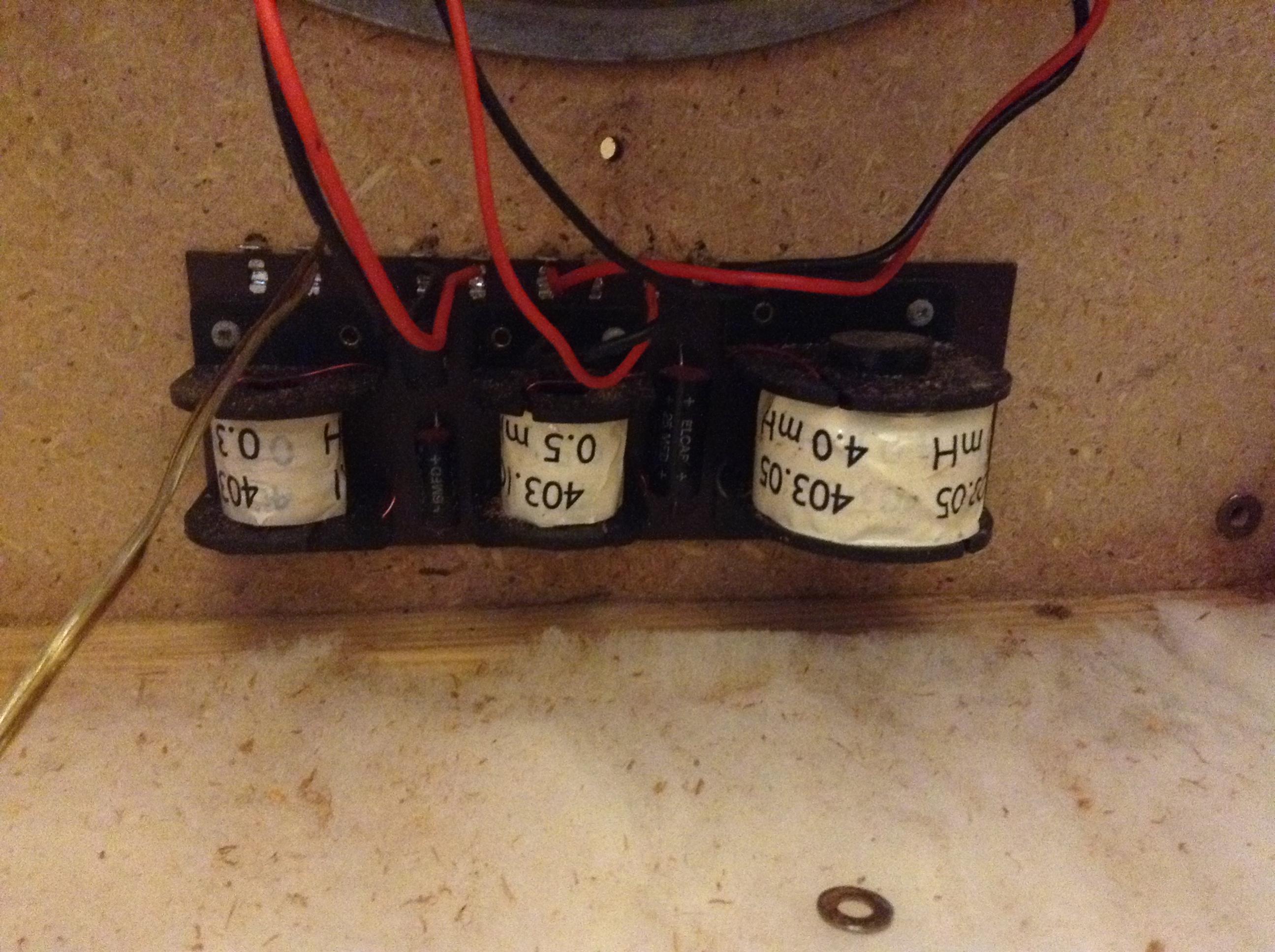

The simplifed crossover network compared to the commercial model shows that these speakers were made from a Wharfedale kit.
Also, the cabinet is home made and not the commercial version.

You will almost certainly improve the sound by replacing the tired, old ELCAP capacitors on the crossover board with new non-polar electrolytic capacitors such as these from Wilmslow audio.they are large beasts and sound pretty good

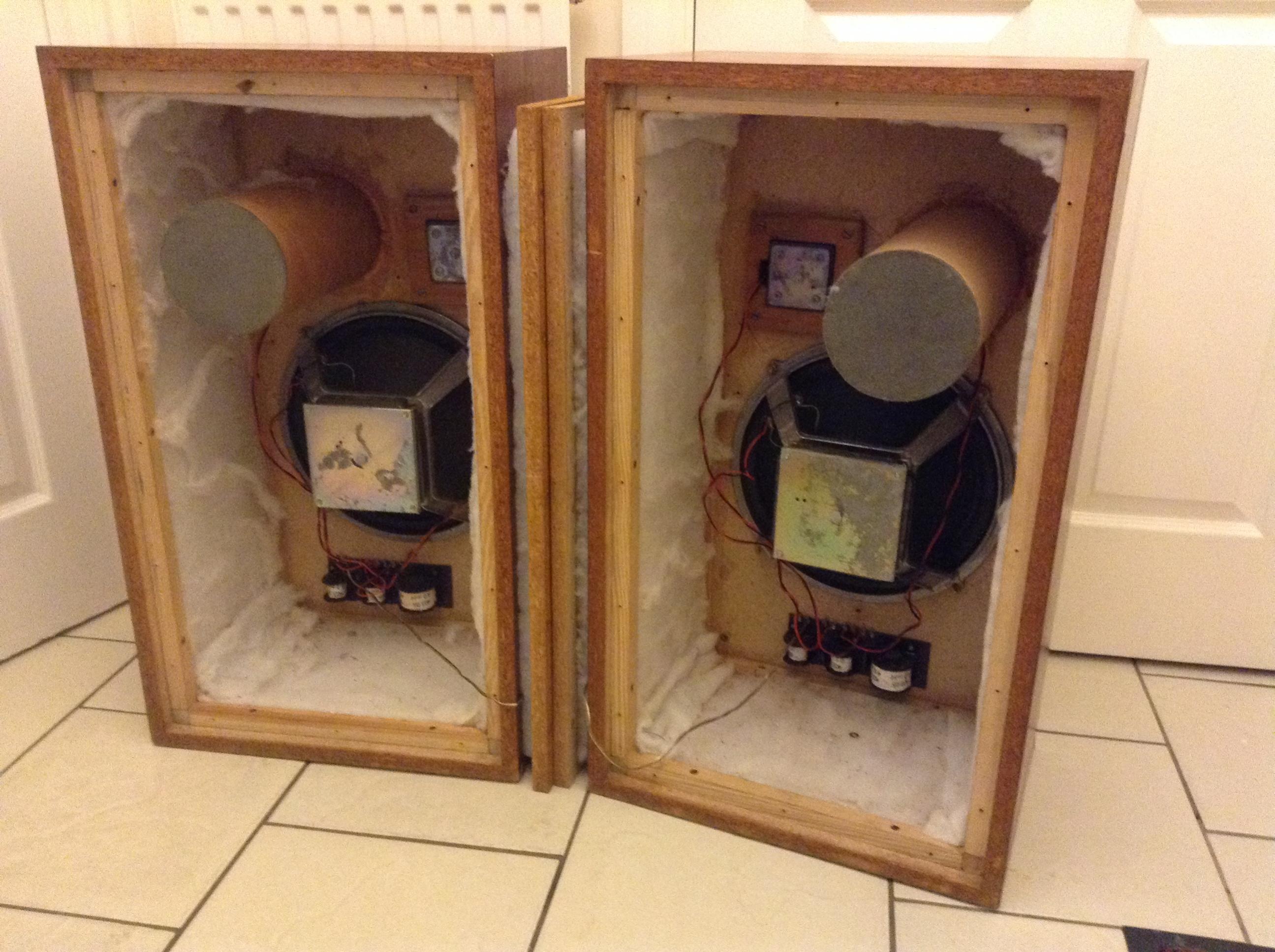

According to my calculations. Half a polyester dovet shoved in each one should be about right
6tog or so. not tooo much.. just enough.
My factory built Dovedales contained a loose filling of BAF wadding. When I investigated it, there was just enough to cover the four sides and back of the cabinet as in the OP's cabinet. The woofer crosses over to the midrange at 600Hz so absorption of mid-range frequencies by wadding in the main cabinet shouldn't be too much of an issue. However, there is always scope for experiment!
