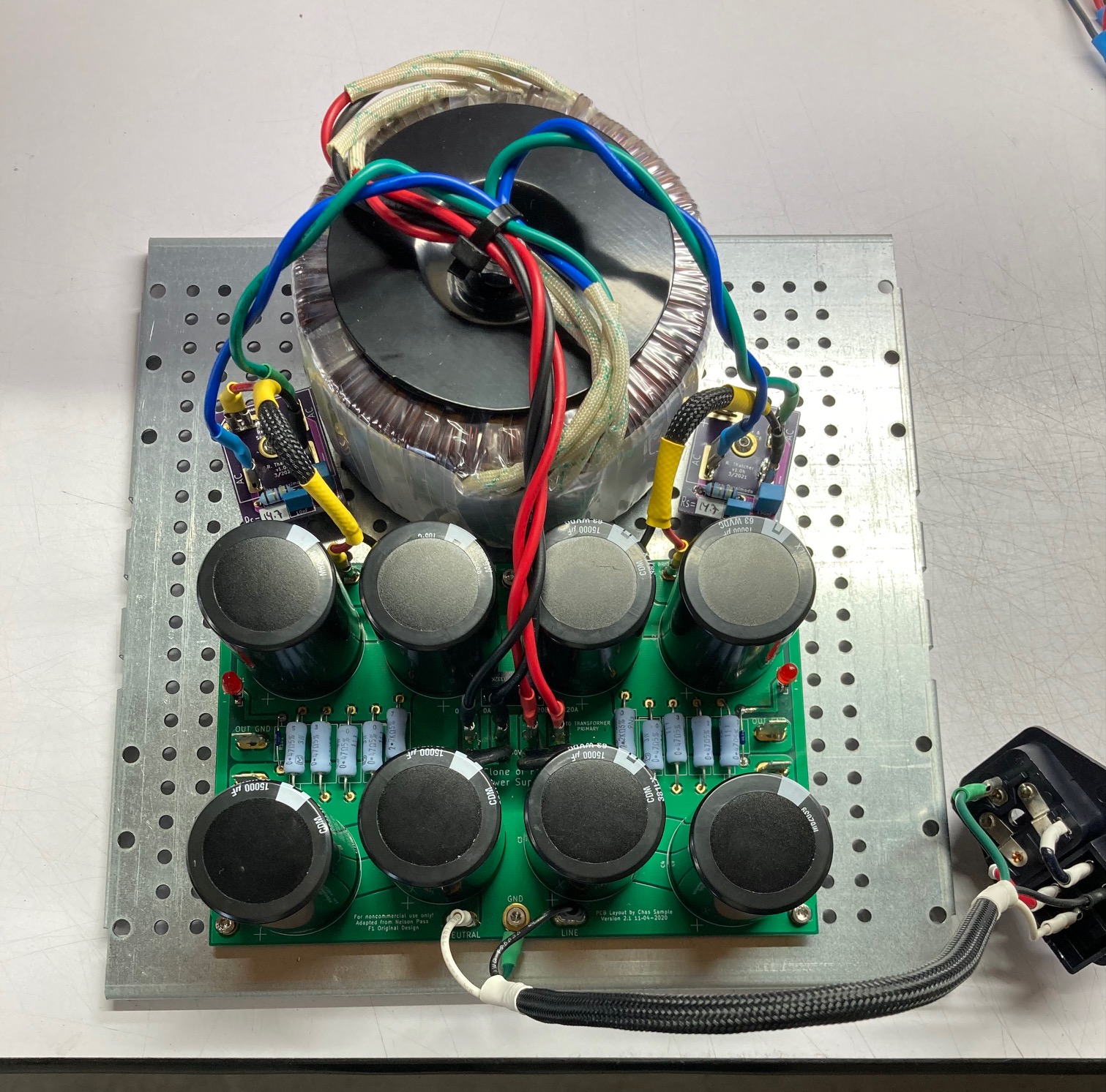

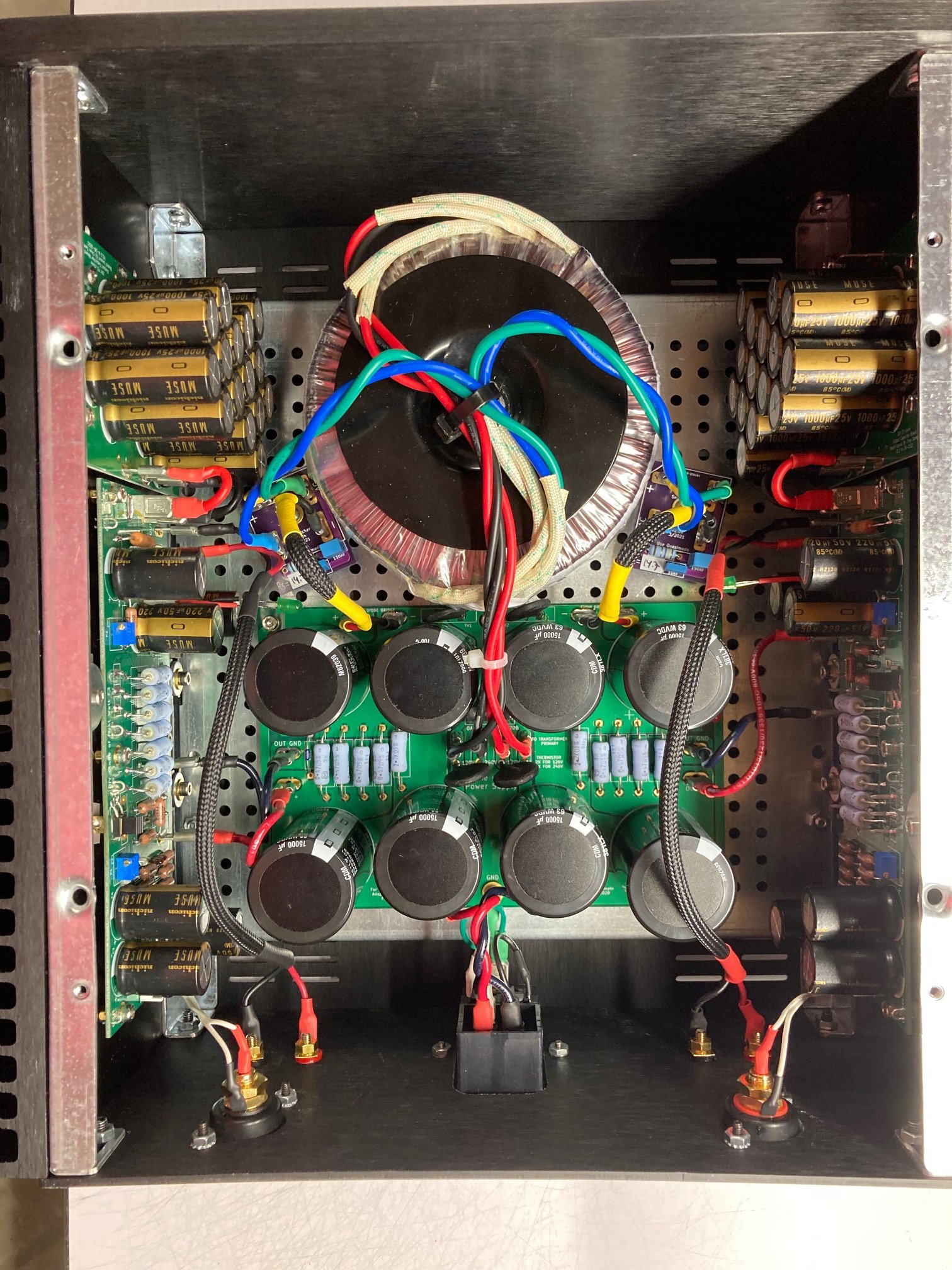

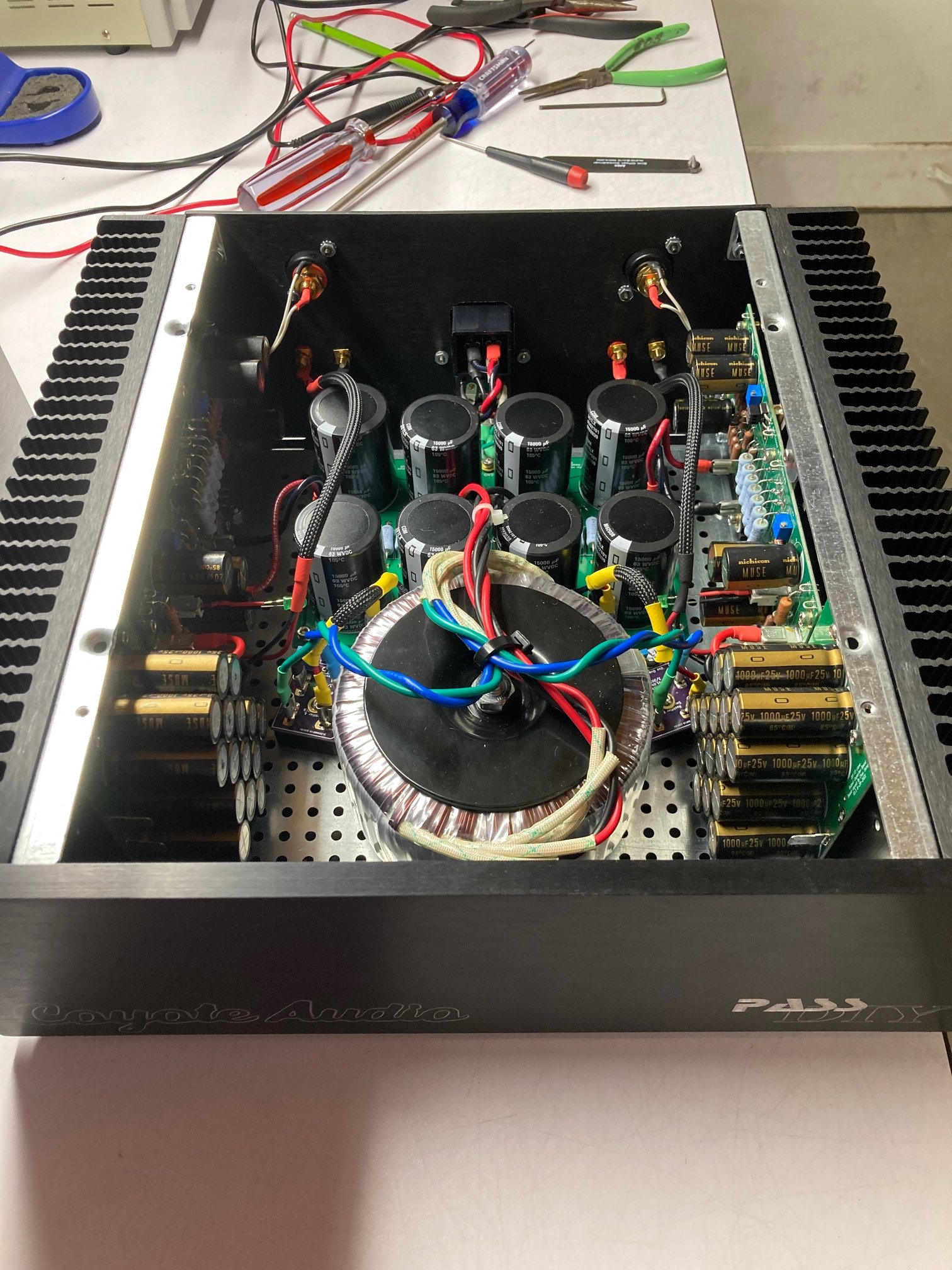

I stuffed my F3 clone into a Mini Dissipante 3U/300 chassis with a base plate to support the trafo and PSU. It's a very tight fit and you need a special slim right-angle screwdriver and a lot of patience to get the screws which attach the faceplate to catch their threads. I'd built this amp first in a 4U Deluxe chassis before I moved it into this one.
The heat sinks get hot (2-3sec touch) but not hotter than the sinks on my ACA. I run it at a bias of 1.4A rather than the FW spec of 1.65A.
