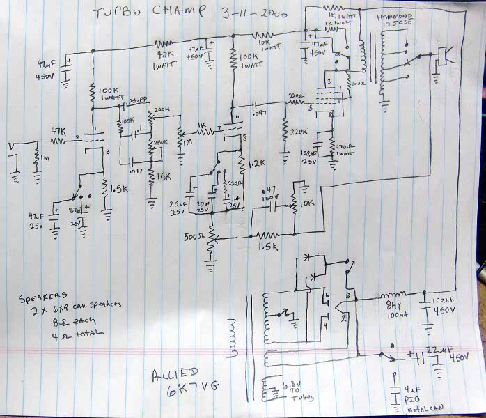

Here is the schematic of amp I called the Turbo Champ. I built a few of these in the late 1990's. No two were the same, and this schematic was drawn up after the fact, and may not exactly match any specific amp.
Many were made with car stereo speakers obtained cheap when a local K-Mart closed down. A couple were made in traditional 6V6GT on 350 volts style, but most ran a Chinese KT88 or Sovtek 6550WA on 450 volts. They were LOUD!
Each had some unusual combination of switches and pots to make it different from the others.

i was just thinking about KT's like an 88 or a 90. and for giggles i was looking at a 150 xD
you mentioned 3K OTP would be better but what about runing an 8 ohm cab in the 16 ohm tap? i used this trick in the past to get better primary impedances for the tubes i was using.
anyway with a 5k Primary, this trick would bring it down to 2.5k which is closer to 3k then 5k
thoughts?
thanks!

That works. I have a 20 watt SE HiFi amp on my bench right now. It is using a big 5K Hammond with the 8 ohm load on the 16 ohm tap.
The OPT in most of the Turbo Champs was a multi tapped Hammond 125CSE. There was a switch to select every tap, as each had a different sound. Be wary of going too far the other way, running 8 ohm or higher speakers on a 4 ohm or less tap. The light loading on the tube can allow too much voltage to build up in the OPT when the amp is driven hard into clipping. Sparks inside the OPT can ruin your day.
An "8 ohm" guitar speaker can be 30 ohms or more when driven hard at its resonant which usually falls in the guitar's frequency range.
Remember also that the bigger tubes require a bigger power transformer to feed them, both for the heater winding and the B+. Single ended amps are rather inefficient. To get 20 watts out of one, you will need 50+ watts of B+, maybe 450 - 500 volts at 100mA or more.
