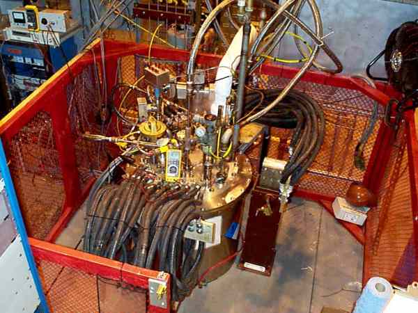

It is a very easy thing to produce a loop voltage within even a 535 mcm conductor. It isn't a conductor size/IR drop issue I speak of..it's intercept of time varying flux within the loop.
What I detailed was not a hearing test, but an electrical one..to see if a result was even there, and if so, if it large enough to be of significance w/r to the audio signal. (not ppm, but percents..)
These are 535 mcm cables, BTW:
Cheers, John

But Sully, that looks like your experimenting with a superconducting subwoofer voice coil.

We find that a 30 kiloamp burn in during cryogenic treatment helps..and, as a side benefit, everybody's arthritis goes away for a week.
On the down side, all the computer monitors change color, so we have to switch to plasma's.
Would you believe the physicist guys look for 1 microvolt signals in that mess of 535 mcm cables while they're pushing tens of kiloamps?? We have to use really tightly twisted pairs; shields at 5 to 7 tesla are rather useless, and reduction of pickup loops is critical.
Cheers, John

MR scanner will do that for you too...Must mess up compases, wristwatches and ATM cards too.
