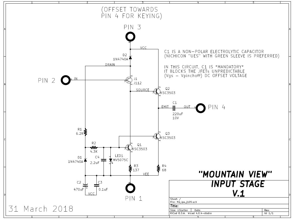

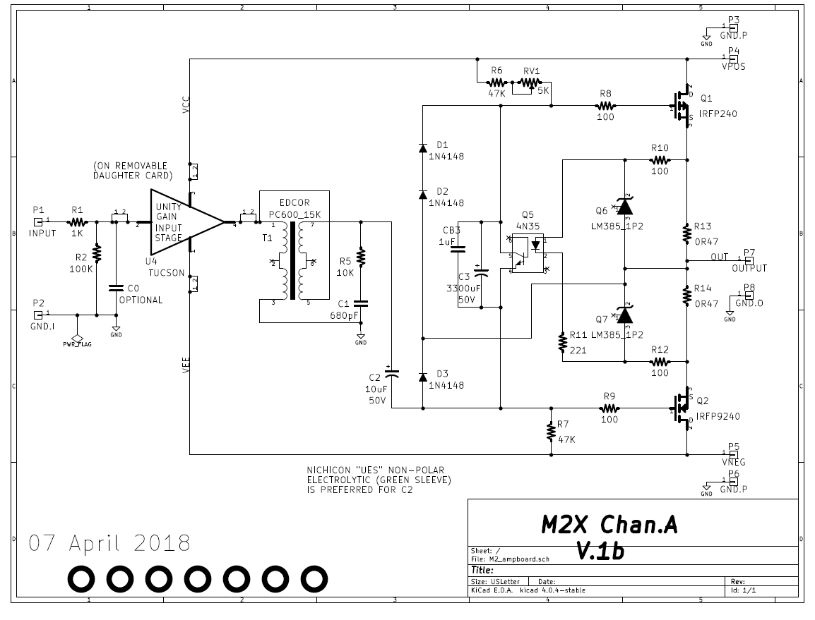

I'm using the J112 N-channel JFET in the input stage of a power amp, specifically in the M2x "Mountain View". The J112 is a chopper JFET, the big bold title on its datasheet says N channel switch yet it works really well in the amplifier application I've chosen. For what it's worth.

Figure 1 below is the First Watt M2 power amplifier, designed by Nelson Pass. Notice that it is a Class-A circuit with no feedback.
Figure 2 below is the (removable) input stage of the amplifier, using a Chopper Transistor (J112), designed by me. Notice that it is a Class-A circuit, single ended, with no feedback.
I have also attached the datasheet of the J112 chopper transistor.
