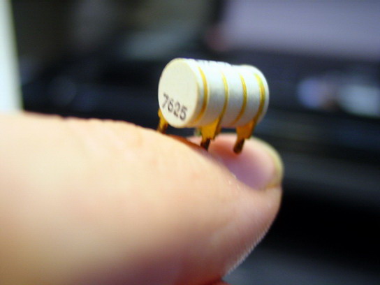

Does anybody here have experience with small ceramic planar tubes ? I would like to use a 7625 planar triode but can't find a socket for it and the G.E datasheet doesn't mention any specific socket for this tube. It has small lateral pins (different from the 7077 who needs contact springs) which could be easily soldered on a PCB but I'm afraid to damage this (very expensive) tube by overheating it. Looks this tube was designed to be direct soldered into the circuit but I'm not sure. Your well informed advices are welcome.
Hold the pin on the top of the pcb with pliers while soldering underneath.
This will prevent heat reaching the tube.
Might be a two person job tho.

Tubologic, on the datasheet linked to by bigwill, it says "envelope temperature at hottest point: 250ºC".
I think soldering will be a very risky thing to do. Those metal-ceramic joints are very fragile indeed.

60/40 tin-lead solder melts at 183C. Tube seals won't reach the temperature of pins - should be fine. Don't use this if you must be RoHS compliant though... lead free is generally soldered at 250-270C.
Datasheets says Printed Circuit Board solder slugs:
Base Side contacts
Filament Vf 6.3 Volts / If: 0.24 Ampere / -: Indirect /
Description Ceramic and metal high mu triode intended for low-level audio applications. PCB solder lugs. Mu 80
