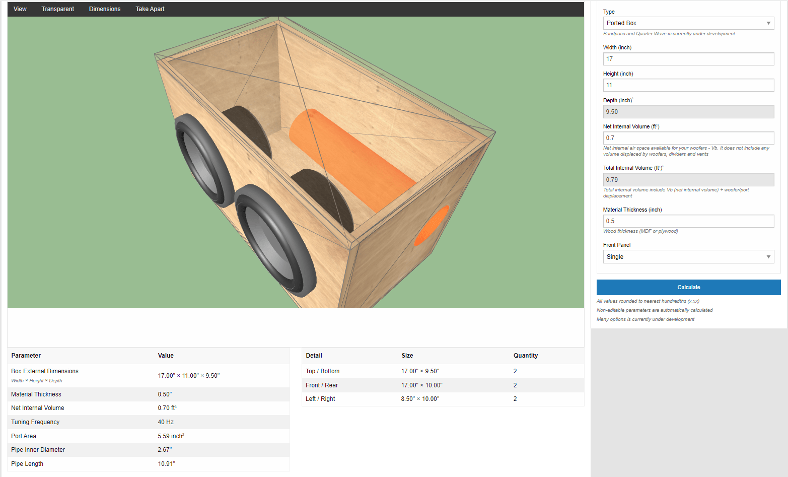

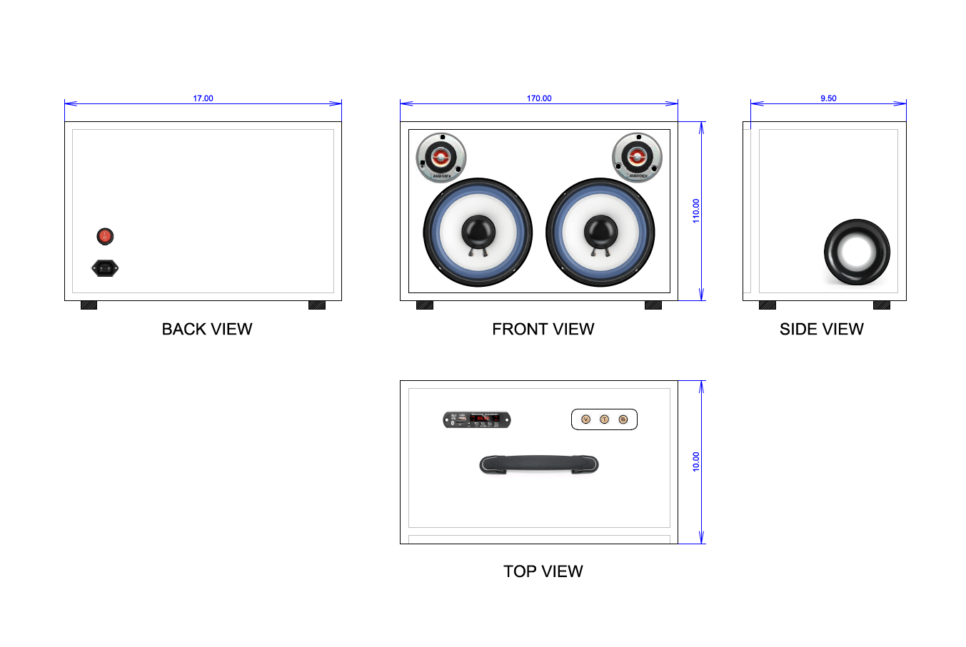

Hi I am working on a Bluetooth stereo system, please help me with these doubts.
1. Fs of my woofer speaker is 63Hz, so can I tune the enclosure to 40Hz or low?
If no, at what frequency should I design!
2. Two woofers can share the same enclosure volume, since they are same spec and receiving the same signal?
3. Adding a speaker cloth cover in front of the port hole will affect the bass output and tuning!!?
Woofer spec: 6inch 4ohm woofer, 40Watt RMS, Peak 80Watt, 2Nos

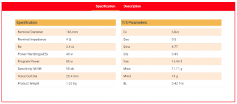

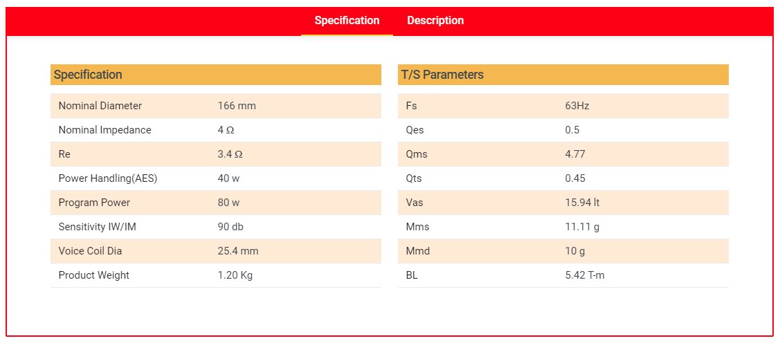

Fs= 63Hz, Qes= 0.5, Qms= 4.77, Qts= 0.45, Vas= 15.94ltr
Tweeter: 10Watt, 4ohm, 2Nos
Amplifier: tpa3116d2, 2*80Watt
Thank you

I'm trying to make the enclosure as much as smaller possible. The woofer Vas is 15.94ltr and the enclosure I designed is about 20ltr (17"x11"x10") is enough!!?
I don't want it too loud, instead prefer more bass and clarity. I will attach the speaker specifications I got below.

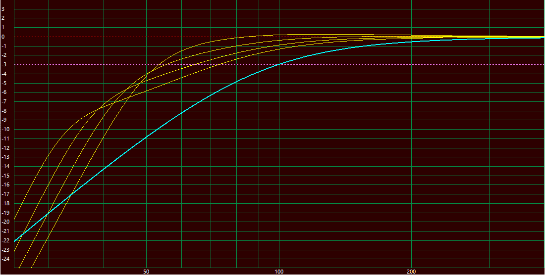

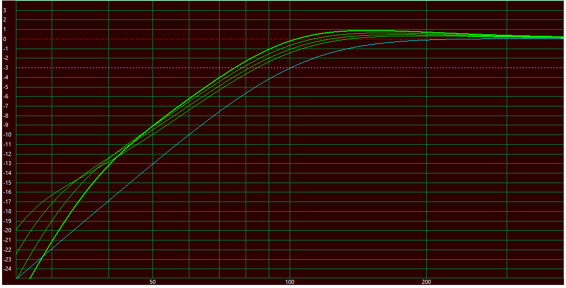

20L is rather too small for a pair of these to get particularly deep, it only gives you about 4dB more level than running them sealed. It also means that there's not too much difference between various tunings.
Here's 4 vented tunings compared to sealed:
The vented tunings are in green, with the top line being 55Hz, then 50Hz, 45Hz and 40Hz at the bottom. Note that there's only about 1dB more level at 40 Hz with the intermediate tunings, and that both 40Hz & 55Hz tunings have less level at 40Hz.
If you can afford to double the box size, there's quite a lot more bass available from the vented tunings, though not much improvement for the sealed. These are all 40L, same tunings as before:
IMO, 50Hz tuning gives the best balance between flatness in-band and extension, for both modelled box sizes.

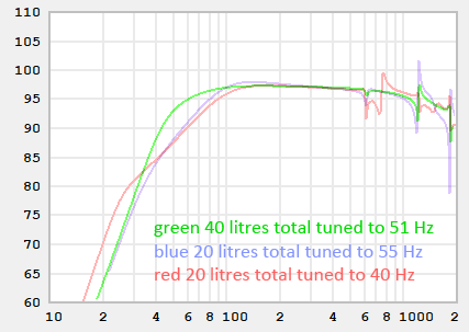

hello deric,
attached a very rough hornresp-simulation for two drivers in one box.
you can of course tune the box to 40 Hz but you can see in the simulation that the response is not very even and falls off towards deep frequencies.
my suggestion would be:
simulate the response, you can find plenty of tools, also very simple ones to get a feel what is possible with your drivers.
make the enclosure bigger to get better bass response. i suggest 40 litres for two drivers.
(oh, david was quicker!)

Sorry, I only included the sealed traces to illustrate that venting a small box doesn't gain as much LF as venting a bigger box. It wasn't meant to suggest you build sealed.
So, if box size, number of drivers & driver choice are fixed, go ahead and vent it. I'd probably stick with the 50Hz I suggested earlier, though you really don't lose anything important with 55Hz tuning either.
So I will change the box design to 50Hz as you said. Thanks a lot.😇

1. Technically, normally not a good plan to tune a driver lower than ~ 0.707x Fs = ~44.54 Hz in your case and ~ 63*0.42*0.5^-0.96 = ~51.47 Hz, so there's your max range without resorting to some form of horn.
