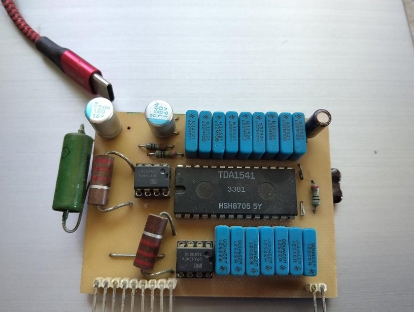

I've not heard 627's (they were too expensive for me too!). I've put OPA134's in mine, a better clock and a few PSU mods (diodes and cap upgrades). If you can put some heatsinks on the DAC chips and improve the cooling air throughput, that’s a good idea also. It's a very underated player (if a bit ugly) and a real giant killer.
PS.
I've put connectors on my DAC main board (the one that the 4 DAC boards fit onto) for ease of modding, they work well.

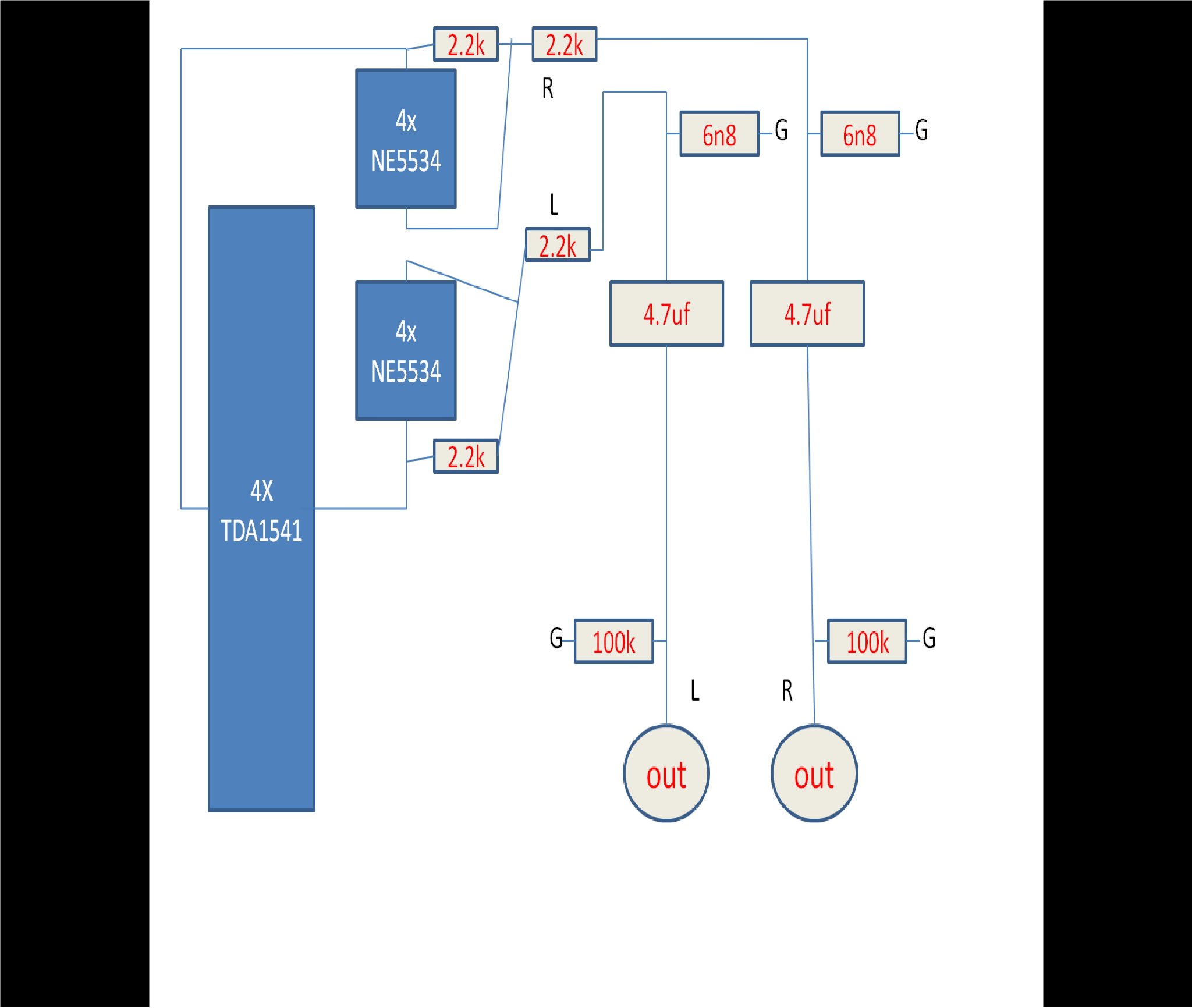

Very nice! I was looking into OPA1655 but I know already nothing beats OPA627, I've used them before. I was drooling over the possibility of wiring all the output together and using a discrete opamp at the end of it!
I created this and double checked it 5 times so I hope its correct but oddly look at the output of the DAC it goes straight to the output via 2.2k resistors parallel to the opamp output. This could be normal but its strange to me lol

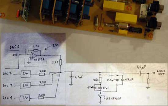

Don't mod it. It is not sure your shematic is rigth. Seems to me there is I/V + reconstruction filter (2k2 serie with 6n8 in between to ground?). Or maybe it is just one 5534 per TDA1541A. Without shematic don't play with it !
The Signetic 5534 are the best 5534 op amps made and keepers....ultra low noise. You could at least change the I/V for something that is drop replacement for the 5534 but much beter for the I/V task, but we don't know the shematic really, so...
op1655, op828 (better than the 627 for much less), or easier : LM6171, but on a socket it will oscillate. OP1655 is what I'd choose, it has some nice feature forthat I/V task and work fine here. Of course some needs soic8 to dip8 8 adaptators. You have to check the voltage compatibility as well...

Yes look at my drawings it's 4x ne5534 per channel. 8 in total. They are also Signetic.

The shematic seems again a little odd to me, a mistake when you draw it I surmise. I bet more for an I/V stage plus some reconstruction filter after.

For the I/V only and you keep the Signetics for the filter after (if I am rigth).

I studied the drawing for output several times already I'm 99.9% sure it accurate. It's without the de-emphasis.
