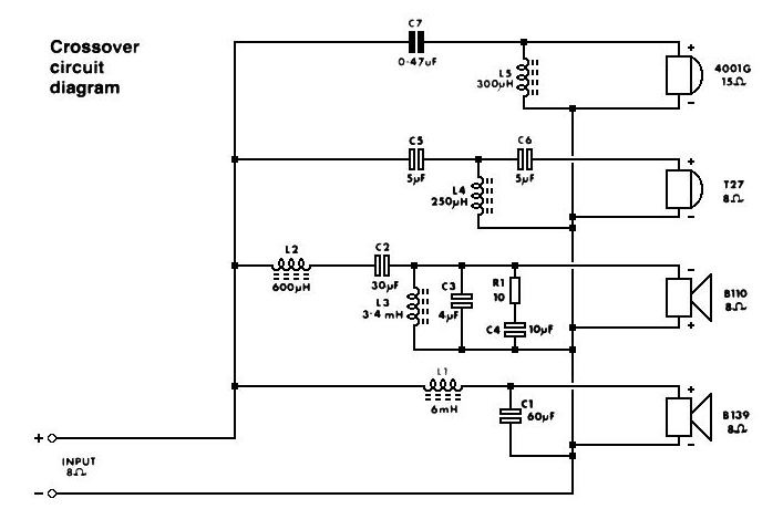

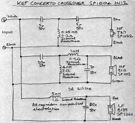

Also I’ve come across two circuit diagrams: the original R40 (R50 without the super tweeter section) and the Radford Kef Concerto XO of which looks quite different but is for the same drivers (Kef b139, b110, T27).
Is one better than the other? If so, why?

Here's the crossover (less the top tweeter). Many or all will be bipolar electrolytic types,
so replace those at a minimum, but film caps may not fit. Check the 10 ohm resistor
for value and overheating. http://i65.tinypic.com/2u5s1av.jpg

I think I prefer the Cambridge R40 implementation to the KEF Concerto. Impedance correction on the mid must help. But hardly a smidge between the two. The supertweeter is no bad thing either, but my battered old ears probably wouldn't hear it. 😱
