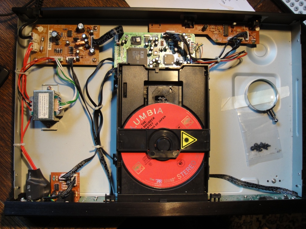

Since the only information anywhere about this player is false, here are a few facts. Tiny main board is all SMD and dominated by huge video chip. I guess CD video didn't really happen much, and there was a lot of surplus boards to be found in skips.
Mech: VAM1202/12
DAC: SAA7327 CD video processor with bitstream DAC 🙁
CL8830 video/audio processor with MP2 decoder 😕
headphone amp: TDA1308
can't find audio stage...need microscope maybe.
Sound is stark.
Facia plastic is delicious 🙂
All other plastic is Sino-functionalist, like my Maplin toaster 😀

Display driver is HT16512, which only has keyboard and microcontroller i/o. The only non-dedicated chip is an Atmel micro on the main board. As you can see I've found the protocol is probably NEC, but if it's inherited from a board with video functions it may not be the usual CD code I suppose.

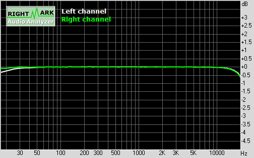

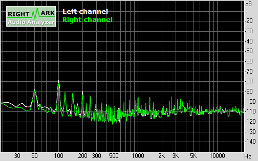

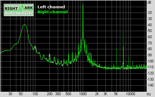

Not to be trusted absolutely, but a quick check shows both problems: mains and harmonics, and only odd harmonics of the 1k input. I've never seen 7H greater than 5H before. Perhaps some of it is a coincidental something else. THD measures .040% but some is due to the soundcard.
No ripples in the frequency response. It's a pity RightMark doesn't show phase.
Cambridge Audio don't published service manuals and schematics. OTOH this is necessary to understand the unwanted observations concerning THD.
According the image from post #10 the main PCB (green color) looks like a PCB from an extremly cheap DVD player or MP3 player.
At least it is not a pure decoder board for PCM, as usual by older CD player models.
What are the exact namings from that PCB and the used MPEG audio video processor units ?
With help of this informations would it be possible to find out a more known model like this model from cambridge audio so as the datasheets of the used ICs.
And the next step is to order or download the appropriate schematics from the actually manufacturer of the main PCB.
Hi tiefbassuebertr
The board is marked CD36 which is another Cambridge model. There's no sign of it's original manufacturer. The CL8830 processor is for VCD, this one's Chinese but the datasheet for the original c-cube chip is available.
Output stage features 741-type opamps. The power supply includes a switched-mode 5V, other voltages are unregulated and high impedance. I can't see a reference or regulator on the main board either. My eyes are sore from trying to follow tracks...
If it were mine, it would be in the bin by now...or rather taken to my nearest authorised electronic waste disposal facility...
A replacement cap for the switcher's output has reduced the noise coming through the mute and kill circuits to the headphone amp, but it's still audible and now I can hear the turntable motor when paused, so I guess there's a ground problem somewhere.
It's trash, basically. It'll be a lot easier and cheaper for me to give the owner one of my own players.
