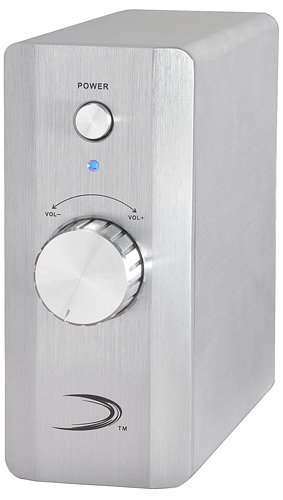

I am considering adding this tube buffer at the moment
http://www.audiodigit.com/index.php?section=81
There is plenty of space inside the case. I'm thinking that it may be easier for me to use this as an output instead of trying different opamps. Perhaps I could just bypass the output devices and avoid soldering surface mount stuff alltogether?

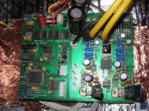

Here's an old picture from May this year showing the board with Audiocom super regs on the bottom for the Digital sections.
At the top of the picture just out of view (attached to the brown wires) is another Audiocom regulator feeding the clock circuit. (Can't remember the name but it was the best one they sold at the time.)
You can also see the Black Gate caps. I messed up a bit here I think. From memory I increased from 2200uF to 3300 but they are just a little too wide and just about touch the sides of the transport mech which I'm sure cannot be a good thing. Also they are now standing off the board more than I would like so I will have to sort this out sometime soon.
You can also see the (Pink) Elna cap that I parallelled with the original on the transport side. This seems to fit neatly under the transport mech but I doubt it has any sonic benefits but who knows?
And the Bitumen damping and the extra copper shielding on the base. Once again YMMV.

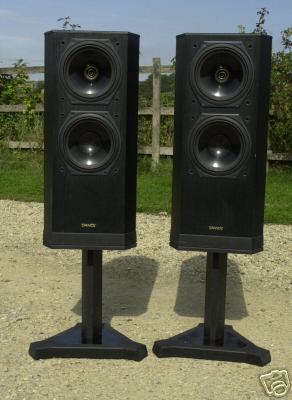

It's very interesting to hear that the CD4SE beat the Marantz in all but treble. I suspect that this could be system dependent?
In my system I have;
CD4SE ----> Cyrus2 & PSX ---->Tannoy 611 Mk1
The speakers and amp are both known for their forward treble so it is therefore difficult for me to comment. On lesser systems I have found the Cambridge a little too warm and lacking detail but with my kit I have too much of the very highest treble. :whazzat: I'm sure I'll get it sorted soon.

Finally my thoughts turn once again to the replacing the 711 with the "Tubalizer" I mentioned before. Technically this would seem like an easy substitution for someone of my ability. It only requires a simple +12 Volt supply which I can upgrade later on perhaps to a battery.
But the sound of this tube buffer is an unknown quantity and I would defintely be taking a risk. A £65 risk (96 Euros).
