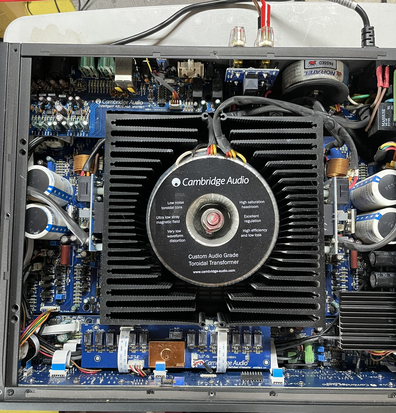

It appears you have two power transformers. Of the two the smaller one is more likely for the line stages where signal switching and perhaps output relay delays and dc output protection are to be powered. The latter relays should be large in size.
I am could not see where the toggle switch would be in your picture. You should check the wiring of the toggle switch to see where the wires lead. If this is not in the manual with a manufacturers name and part number. I think it was an add-on by the previous owner for some personal switching preference. If so you could arrange your wiring to reflect the circuit connections in the makers service manual
The switch is a standard feature from the factory. I'm in conversations with CA on the matter and I'll see what they say about this. I'll post more detailed pics when I take it apart.
