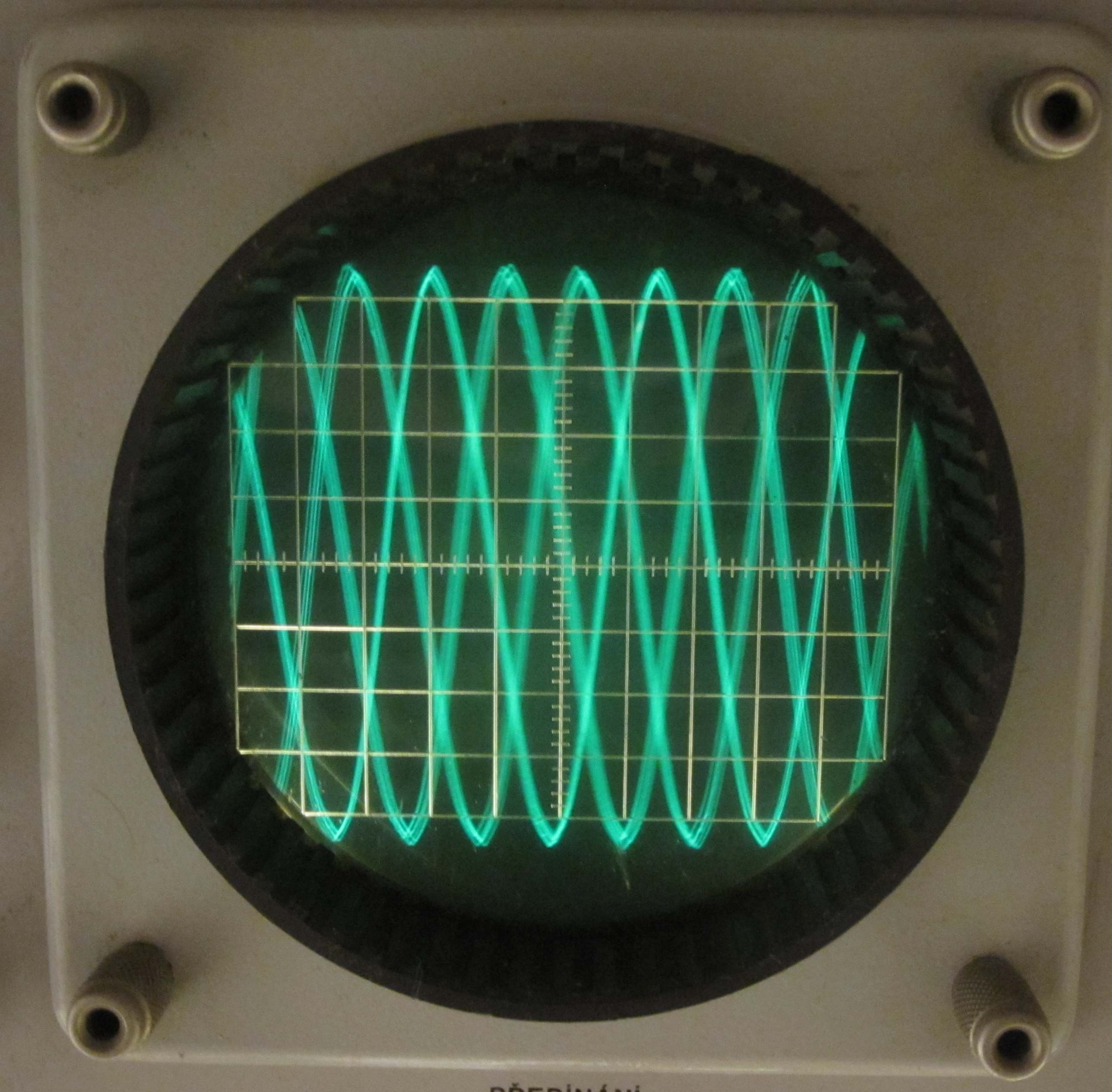

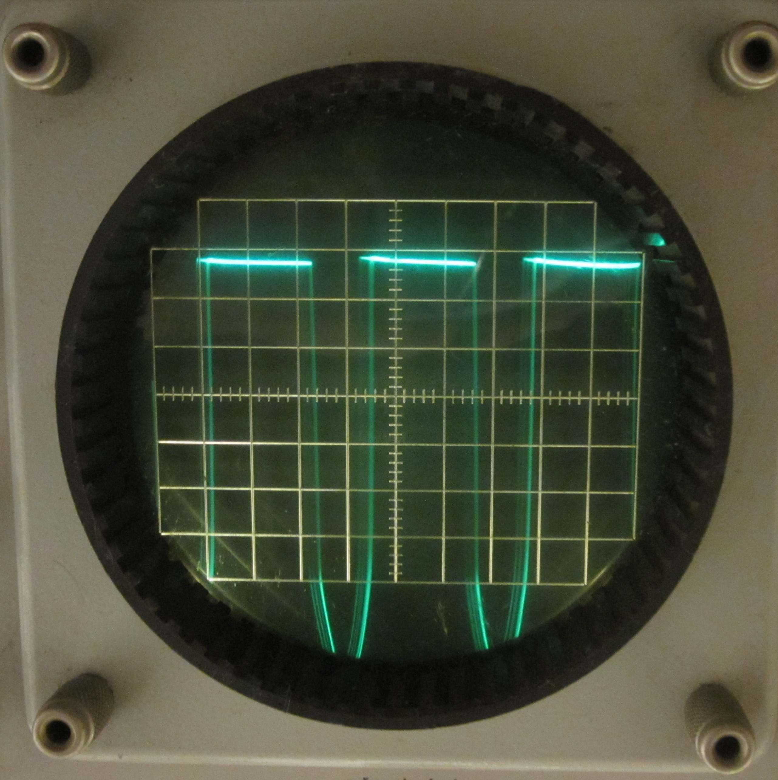

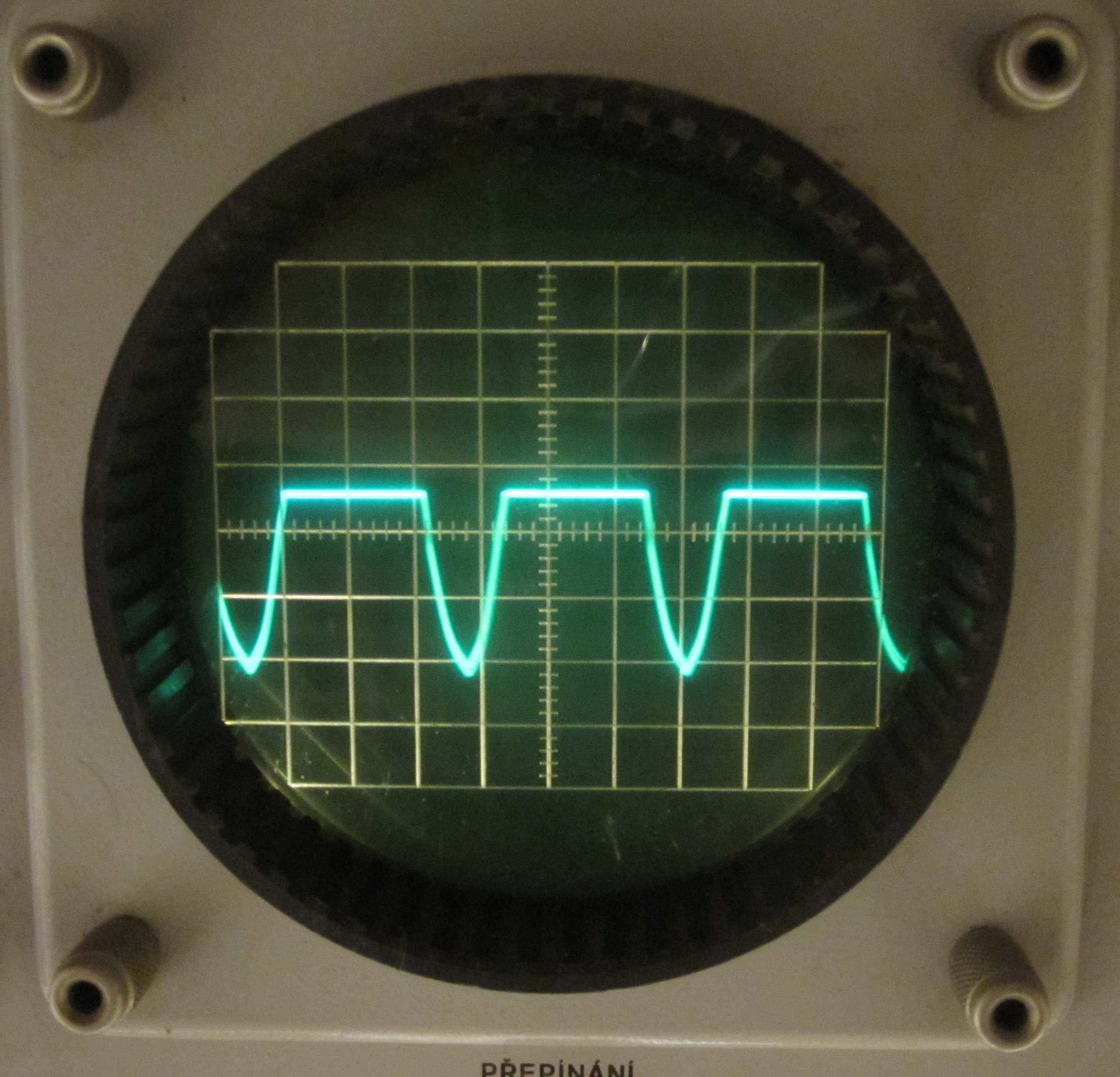

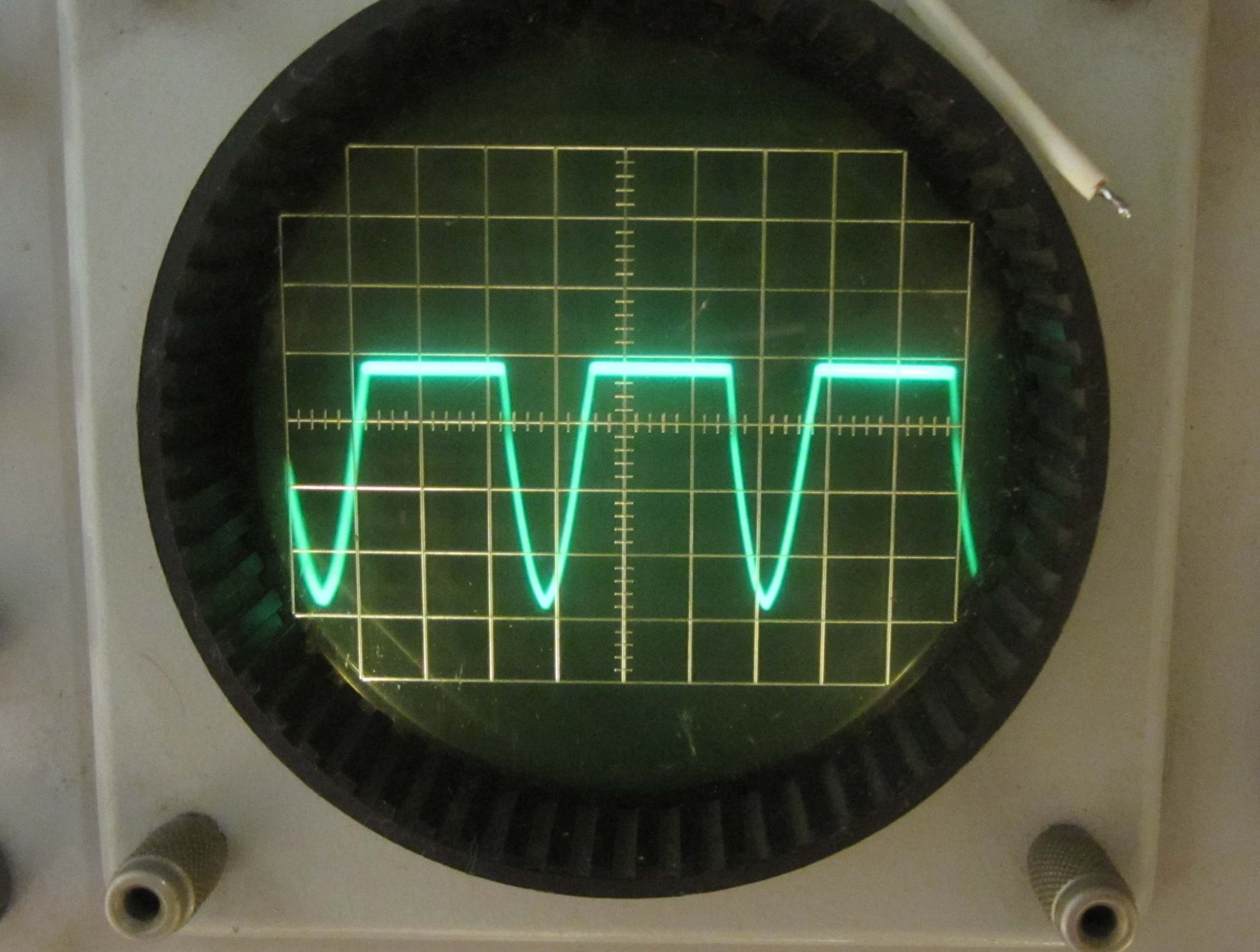

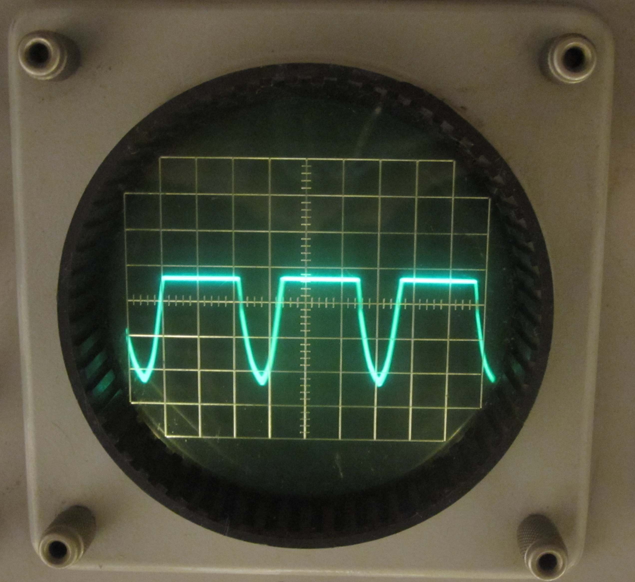

Hi, please, help me. I have Azur amplifier, one chanell is wrong. I send two pictures . Input signal goes to CN2. More input signal give more amplitude down but no up. The two tranzistors on the end are slightly warm. There is no speaker protection. (removed). Thank

Most faults on these amplifiers are down to the output transistors.
1. You need to tell us what the DC offset is (DC voltage at the output).
2. Are the 0.22 ohm resistors OK.
3. Is R99 OK.
4. What voltage do measure between pins 1 and 5 of the upper NPN transistor.

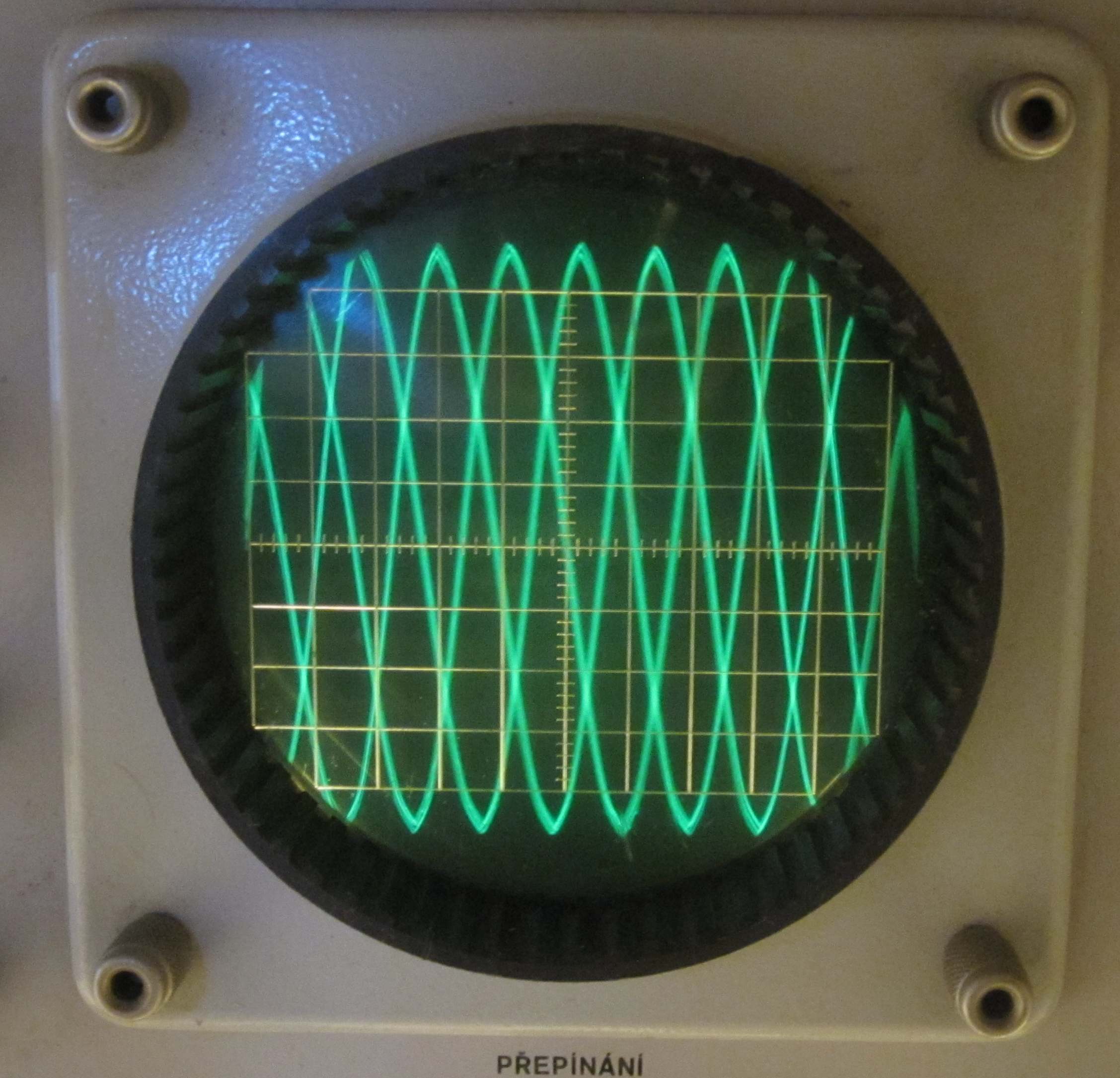

Note1: On the oscilloscope, the upper line stay on one position 0,5 Volt above default 0,0.
More input signal, more sinus Volt down.

Any pictures : Note: R70 (good channel) is the same R99. Input signal both channels identical Volt and Frequenz.
From left: Wrong speaker out, R99 pin1, R99 pin2, OK speaker out, R70 pin1, R70 pin2

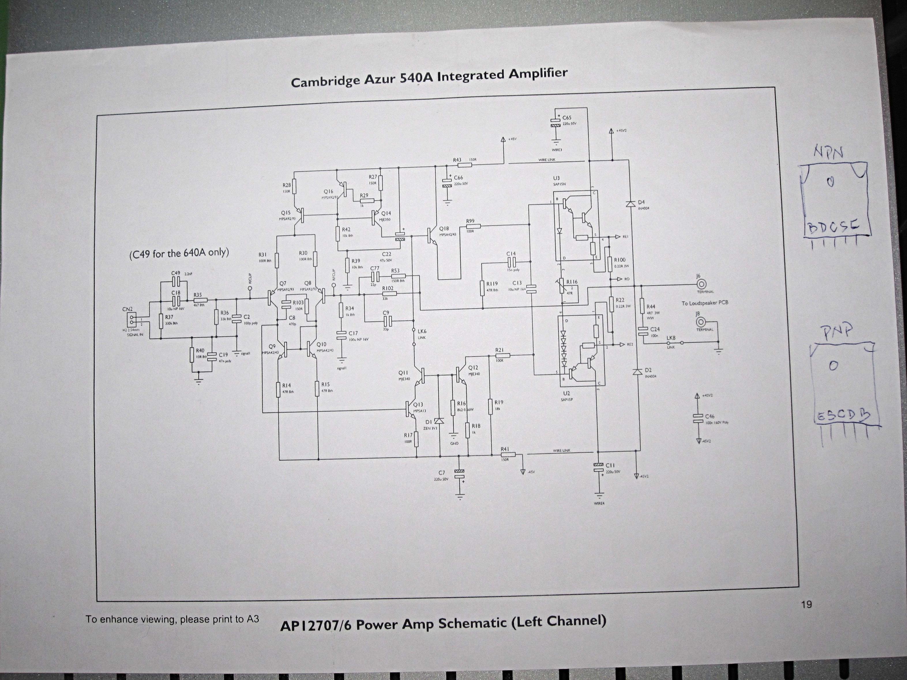

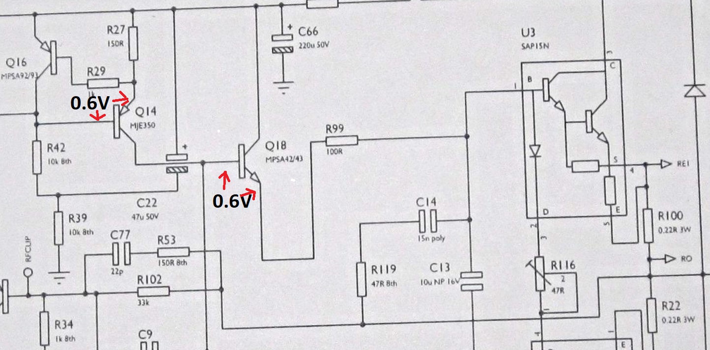

I'm afraid nothing very conclusive shows up there. The offset is OK and while the 1.14V between base and emitter of the Darlington sounds a little low (and it is possible the problem is here) it is in the right ballpark.
I have marked some expected voltages on the diagram. If these are OK then I think it would be worth swapping that upper NPN power Darlington transistor and seeing if the problem is fixed. The 0.6V marked is the voltage between base and emitter.

I have all tranzistors to exchange. I measured all 4 tranzistors in OK chanel and wrong channel before. By multimeter it seems ok to be. With old SAP and new Q18 , Q 18 still hot. I paid a lot of money for SAP. Definitely remove old SAP ? Thank.
We would normally recommend you to use a DBT (dim bulb tester) while working on something like this as it can save damage to parts if there are other problems.
It would also be a good idea to turn the bias preset (the 47 ohm) to give minimum bias before you power up with new transistors. Minimum bias is achieved when the preset is at minimum resistance i.e. when it is shorting pins 2 and 4 of the NPN and PNP outputs. If you look at the circuit it will become clear.
