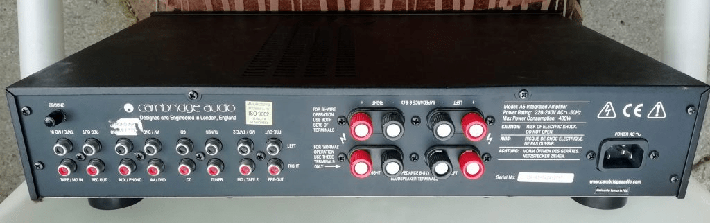

I have aquired a Cambridge Audio A5, it hasn't got an internal phono preamp fitted, is it possible to use an external preamp between the turntable and the amp phono input.
Thanks for any help
Thanks for any help
Yes. If you aquire a phonoRIAA pre amp, (many are available from HiFi shops and online), plug your deck into the pre amp and them connect to your line input of your amplifier.
The Pro-Ject Phono Box E moving magnet (MM) phono stage is both inexpensive at £45 and of guaranteed quality:

...is it possible to use an external preamp between the turntable and the amp [aux/] phono input.
Yes, the external preamp would be connected between the turntable and the amp AUX/PHONO input.
Since this is your first post I will add a tad more detail.
MD/TAPE2 would provide one of several alternative inputs should the AUX/PHONO input happen to be disconnected internally.
Note that that in order to prevent hum, the turntable ground wire should be connected to the ground (GND) post on the MM phono stage and a second wire should connect the phono stage ground to the amplifier GROUND post.
Me a bit confused - if it reads "phono" on one of the inputs (on the back panel) then it should contain a phono (RIAA amplifier) stage?
It reads AUX/PHONO.
Phono stages were often optional and could be included at extra cost.
When no phono stage was fitted, the input was simply aux.
Then the right way to go would be to buy a decent external phono amplifier.When no phono stage was fitted, the input was simply aux.

Cambridge Audio didn't fit an internal phono pre-amp as standard, it was an optional extra. However I have now got an external pre-amp on order
Cambridge Audio not fitting a phono stage as standard allowed users to fit an outboard stage optimised for the pickup cartridge in use.
It also saved some money at initial purchase for anyone with no intention of using a vinyl source with the amp.

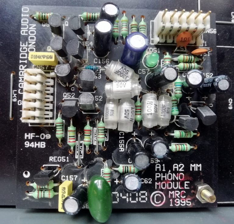

Yes, one cheap opamp and some cheap resistors and capacitors are huge saving for the customer 🙂It also saved some money at initial purchase
Looks to be a little more serious than that. 😉Yes, one cheap opamp and some cheap resistors and capacitors are huge saving for the customer
- Cambridge A5 without internal phono preamp
