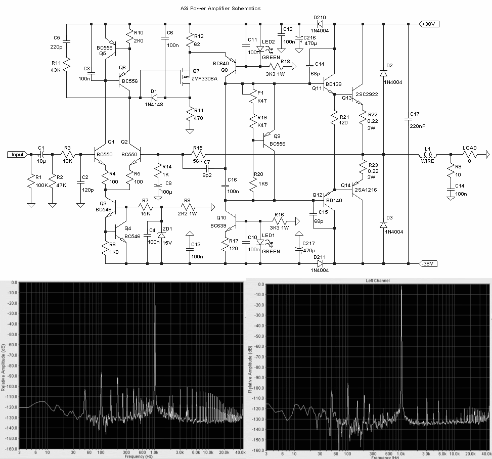

Finally fixed a3i such an easy fix
Kept blowing fuses output stage was fine various trannys replaced
The culprit was leds,just replace them all make sure they are green or orange not red,and make sure they stand off board about 10mm
