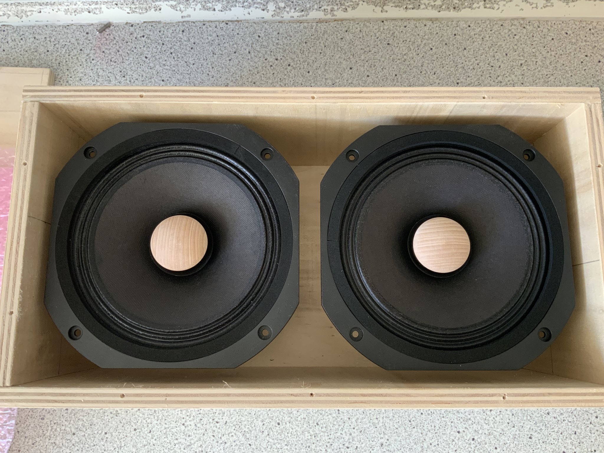

Hello Leif, I had the LB8EXmk2. Maybe they have decided to call it Mk3? Because I received my set with a wood phaseplug with the same design as the one found in their popular LB12 full range. The drivers came in a plywood cradle bolted to the bottom. This thread in the back can be used to experiment with massloading seen done by some quite competent japanese audiophiles. Can also be used to create a better support/fixation of the driver or part of building a “floating” cabinet. One of these “crazy” japanese audiophiles made me a powersupply that was easy to build and costed just a fraction of the price of the drivers. They claimed that the power supply would do the job 95% - the last 5% would be very expensive - not only in parts but also a possible investment in better gear….I builded this psu and I installed the driver in a open baffle. There is persons and manufactures who point out thet the benefit with a field coil is that you can adjust the voltage and by this play with efficency and QTS. I find that point useless. The sound I liked the most was at 12 volt and I had no current limit. I tried to lower the voltage to increase the QTS and lower the efficiency to match the LF driver. Didn’t work to my liking. 12 volt and playing with a L-pad did it. I also placed a capacitor close to the driver which is recommended by Michel Feertin of EMS. In my first attemp I skipped it but after I added it the diver sounded even more natural. Opening the field coil party with this EMS driver was for me a revelation compared to the many other drivers I have owned. With me I had a set 10” with Alnico magnets made in Ukraine. Pricewise, if you look around at the different brands, alnico and fieldcoils cost the same though the fieldcoils then cost extra due to the needed psu. The alnico driver did a tad better job in the low mid. A small changes on the baffle added this to the EMS- Amplifiers in my set up was from Linear Tube Audio (Semi OTL 40watt) Audio Music (Single ended 50 and 140 watt) and Clef Audio (50 watt solidstate). With all 3 amps the EMS presented a crispyness I missed with other drivers. The beaming I found from the other drivers was less apparent and the whizzer syndrom not existing. I am sure that the used phaseplug contribute to its nice behaviour of ease of listen to. The drivers were assisted by a 15” LF crossed at 140-60Hz/ 6dB. My next step was to cut the EMS a bit lower to add more headroom and avoid burning to much LF energy off in it voicecoil. Alone the fact that the driver was in a open baffle let the driver start to roll off soft around 200hz but still receiving full load on the voicecoil below 200Hz. For some of you who read my previous post you know already what happend next. But let me recap - We had to relocate and we could unfortunattely not bring most of our gear. We sold it and brught a small high quality headset system in our cabin luggage. We found our current home in August and is close to be settled and ready to persue our hobby 🙂
I would like to add from my experience that - yes - may of these small companies is not making to much noise and some of them miss the “train” so to speak and don’t get the attention they deserve. And if you sit down and calculate then they are not at all alarming expensive compared to some popular drivers from Asia. I just saw a new 10” where a set is sold by the EU importer for Euro 2950,-. A set of LB8EXmk2 cost app Euro 1700,- street price in France excl power supply.

Can you elaborate on this: “I also placed a capacitor close to the driver which is recommended by Michel Feertin of EMS”. is it a bypass… what value and what is the restult?
