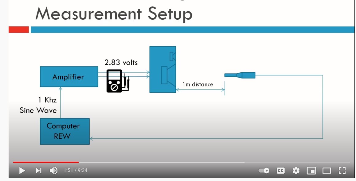

Since you are using the Umik-1 you should already have the SPL calibration built in, right? Does REW pick up absolute SPL from the Umik-1 calibration file?
For the amp, find output level settings for REW, your source and your power amp that give you an output voltage of 2.83 volts at the speaker terminals. That way you have level that is applicable to all your drivers. For many drivers that will be loud.
Published speaker driver measurements traditionally state the SPL at 1 watt and 1 meter distance. Obviously a 4 ohm, 6 ohm, 8 ohm and 16 ohm speaker will need different voltages for that 1 watt. Sticking to 2.83V give you a better idea of how the drivers will play against each other.
I found this on youtube which appears to answer my question. I was thrown off by the fact that the voltage measurement needed to be ac, but the signal is ac, so I think I'm good with this. Intuitively, I find it hard to be believe I'm going to be able to get to 90 SPL for a tweeter, seems awfully loud. And when I do the sweep, I am going to need to put a capacitor in line, what is the typical value for this?

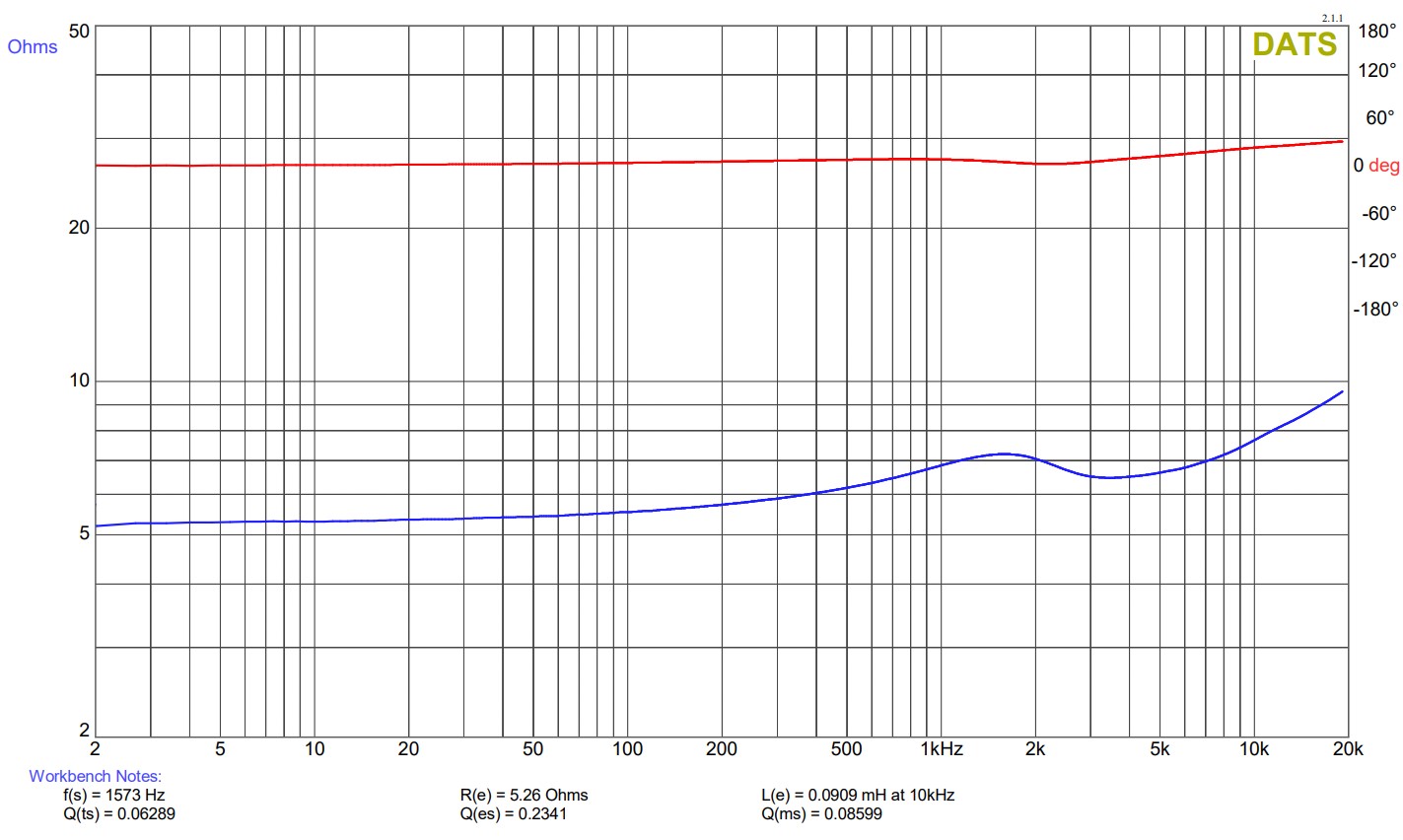

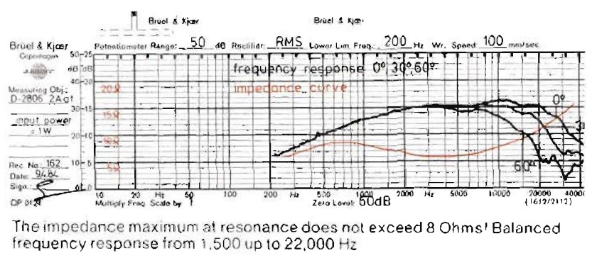

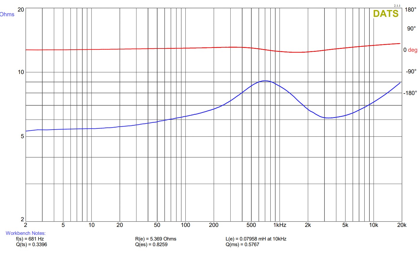

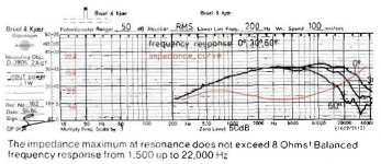

First up on my projects for this setup is to evaluate the improvement of changing the ferro fluid on a D28AF. I have posted the factory response curve, a curve from DATS on a good unit, and the curve for the candidate for fluid replacement. Plan on doing before and after, with hopefully the after curve showing good correspondence with the good unit, which is measuring well compared to factory.
