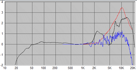

I compared my ECM8k to a calibrated mitey mike so I have a rough calibration above 1kHz. Mine is pretty flat (an older one).
I think the EMM-6 calibrations got better when people complained about them not matching Herb's results. I don't think they are necessarily better in any way wrt specs vs. the ECM's, but I haven't done a detailed comparison.
Older than about 2007? Could you describe roughly how 'flat'?
I bought mine on Jan 2, 2004
My cal file is attached. you could subtract whatever the magnitude at ~1000 Hz is to get a normalized file.
Roughly +1 at ~10k and -2 at 20k.

EMC8k - I dont remember exactly when I bought the mic perhaps the serial# might reveal when it was manufactured but I'd definitely say that even without calibration the responses of known drivers were quite close to what others had measured or the manufacturer's spec so I always looked at it as a pretty flat mic.
For a short while I used the curve here in black based on a wild guess. I have been using the red curve, partially fabricated after some research, using a conservative viewpoint (I've noticed I like my top end rolled off a little, but more so than the curve), compared to yours in blue.
I see I gave out the unsmoothed data - it would be best to smooth all that "grass" out before you use it 😉
