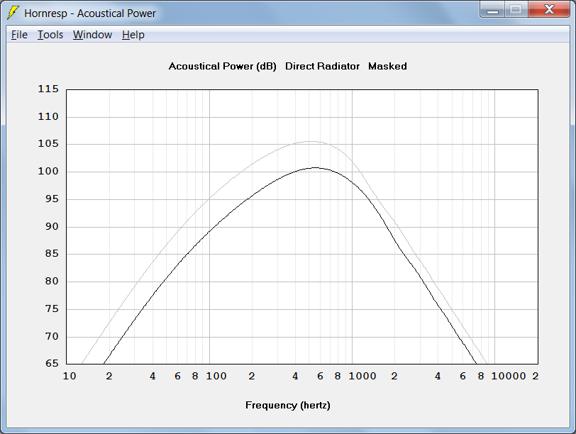

Attachment 1 - Black trace = 1 driver, grey trace = 2 drivers connected in parallel.

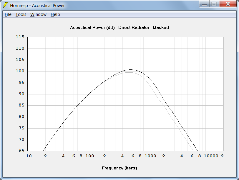

Attachment 2 - Black trace = 1 driver, grey trace = 2 drivers connected in series.
Constant amplifier output voltage, cabinet volume doubled for two drivers.
