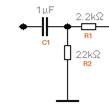

Officeboy,
Thanks for posting this question. I have asked this question in past in topics of amps I am interested with much the same response as you have had. I happened across your question as usual while searching for something completely different 🙁 🙂
Nisbeth,
Thanks so much for posting the formula and suggested target corner frequency. I am to assume "corner" means -3 db point?
I have a few example input circuits I will post to clarify what resistor is Zin as well as to clarify what the other elements of the input circuit are, purpose and any related formulas and/or variations to the formula Nisbeth posted that need to be considered.
The attached example input from an amp is the most basic input configuration I have found.
The first question is is R1 or R2 Zin for purpose of calculation Nisbeth noted?
The second question is what impact, if any, does the other resistor have on the formula Nisbeth provided?
The third question is what is the purpose/function of the other resistor?
