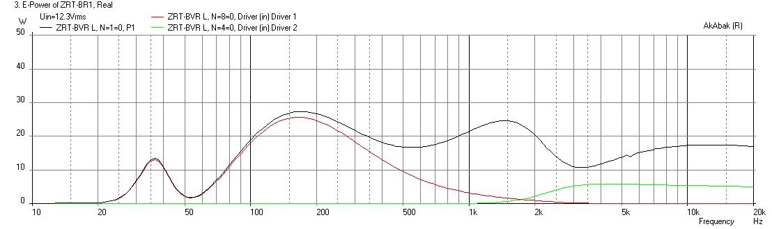

As an example of how the power can be calculated using a sim in Akabak, here is Zaph's ZRT speaker (zaph|audio - zrt - revelator tower) XO:

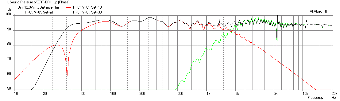

Here is the sim of the response in a slightly modified bass reflex I was working on for another member (includes reflections for floor bounce, rear wall, and diffraction effects):
448079d1415710030-calculating-power-division-through-crossover-network-zaph-xrt-br-1-freq-1m.png

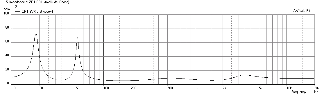

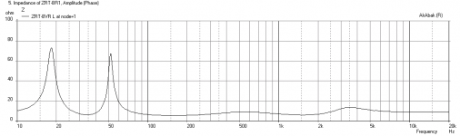

Here is the predicted impedance:
448081d1415710564-calculating-power-division-through-crossover-network-zaph-xrt-br-1-impedance.png
Here is the predicted electrical power input (for 12.3 volts corresponding to 6.5mm xmax on the woofer) to the speaker (black), and the woofer (red) and tweeter (green). You can see how it changes with frequency and how the bass reflex tuning near 35Hz affects the power there:
448080d1415710030-calculating-power-division-through-crossover-network-zaph-xrt-br-1-power.png

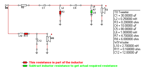

Here is the code that describes the XO as shown in the diagram above:
Code:
| *** Tweeter  ***
  Resistor  'R8'  Node=1=2  R=6.0ohm
  Capacitor 'C1' Node=2=3 C=30uF
  Coil    'L2'  Node=3=5  L=0.25mH
  Resistor  'R3'  Node=5=0  R=0.2ohm
  Capacitor 'C4' Node=3=4 C=10uF
  Coil    'L6'  Node=4=6  L=1.0mH
  Resistor  'R7'  Node=6=9  R=4.7ohm
  Capacitor 'C5' Node=9=0 C=80uF
| node=4 goes to tweeter +ve
| *** Woofer ***
  Coil    'L10'  Node=1=7  L=2.7mH
  Resistor  'R11'  Node=7=8  R=0.168ohm
  Capacitor 'C4' Node=8=0 C=12uF
| node=8 goes to woofer +ve
As usual, Zaph designed a very nice XO and speaker as evidenced by the sims. The sims are very useful for showing exactly how the power varies with freq content.
