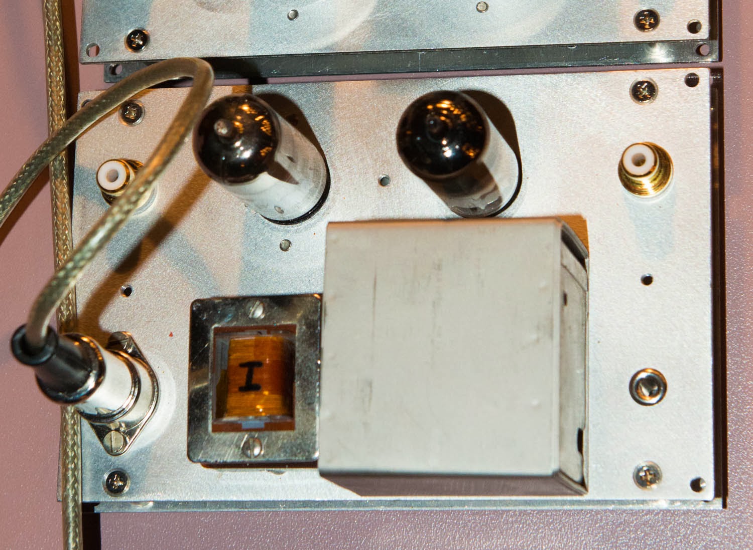

I was thinking about making a phono preamp without caps in RIAA circuit.
Will this topology be good?
If so, how to calculate the inductors and resistor values? (knowing the preceding stage output impedance and following stage grid resistor value).

Just because something is possible does not make it sensible. Realistic values of grid and output impedance will require very high inductance values
the right material, construction caps are some of the most linear, near ideal components in electronics for audio frequency
the best inductors are usually poor to very bad in nonlinearities, parasitics, frequency dependent losses...

Those who wish to use an unusual topology should understand it enough to know why they want to use it instead of the more common better topologies. As a side effect of this, they will know how to calculate it.
There are good reasons why people generally use C and R for RIAA networks.

I am fully aware of all limitations and difficulties related with this type of RIAA correction. But I'm willing to try it anyway, just for fun.
To be honest, I don't "understand" why I want to use it. But I also don't understand why I'm using turntables and single ended triode amplifiers in 2015 when there's class D amplification and high end digital audio equipment all around 😛. From what I know, there ARE some commercial RIAA preamps using L filters, so there are some people who might be preferring them.

The good reasons for building phono correction networks from rc networks is that it requires little thought, little space, little money and little courage.
The sound quality you get out of network copied from the RCA manual is the same: little.

"Nice" in what sense? More hum pickup, more expensive, more distortion, lower Q (so requiring circuit compensation) - all 'nice' features to have in a circuit.Pulatom said:I got bored of making them and LR seems a nice alternative

True, but I suspect that Pulatom does not yet realise just how much "fun" he is letting himself in for. For a start, his first diagram omits the resistance and capacitance of the inductors. Of course all components have parasitic impedances, but for C and R at audio frequencies these can usually be ignored. For L they must be included in the circuit design.
It will be an educational experience. 😀 Designing and implementing a good phono stage is perhaps the most difficult task in audio electronics, and having the handicap of LR makes it even harder.
