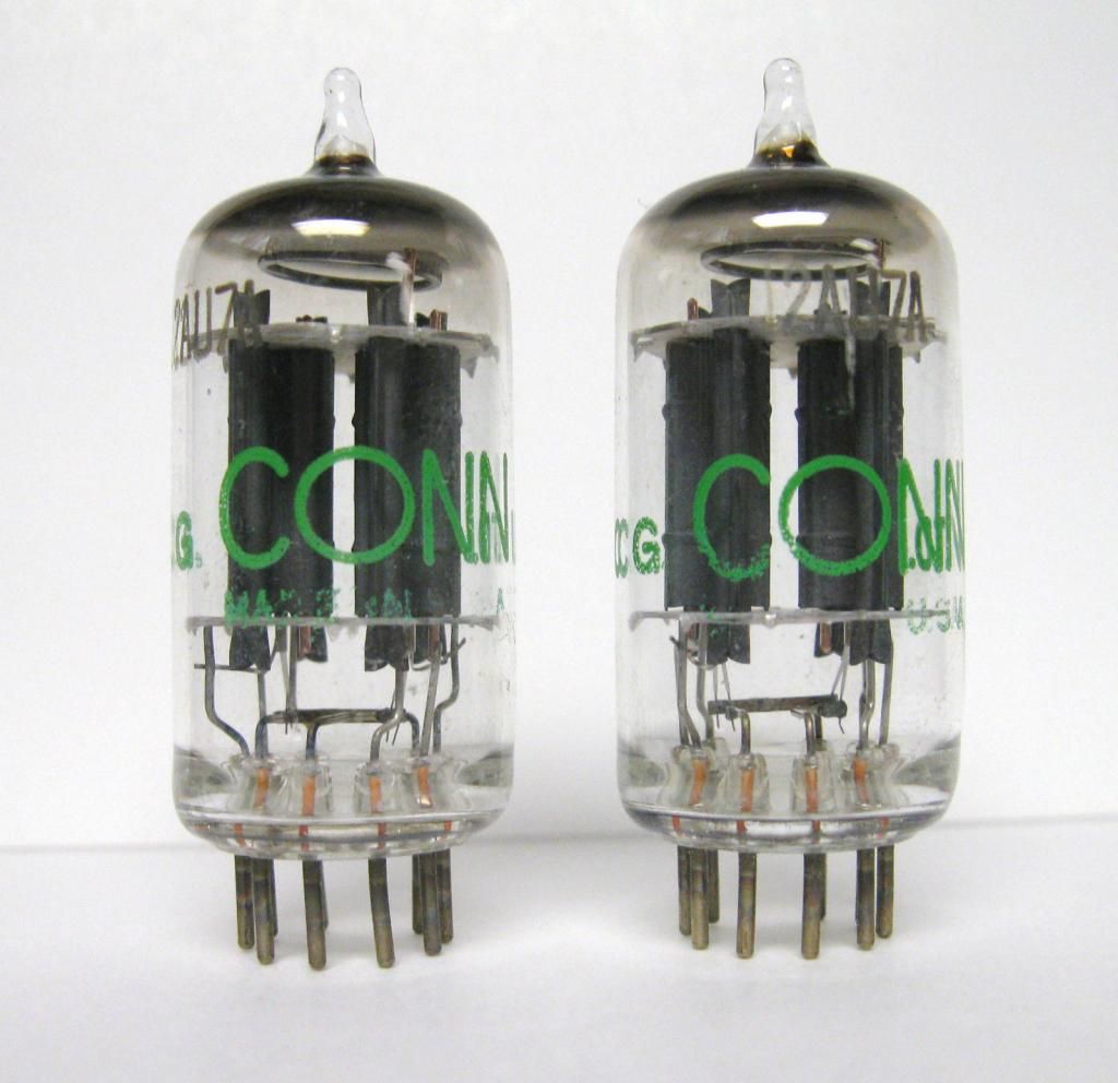

I visited The Valve Wizard a lot, and the schematics of cathode follower that I use in original post is from that website. Thats why I started with 12AU7, but then found ECC88 that I think is able to deliver output impedance of ~76R vs 12AU7 ~402R (according to Cathode Follower Output Impedance Calculator)
Second link is promising as well.
Looks like schematics that artosalo provided is identical to the one for 12AU7 in other thread that I started http://www.diyaudio.com/forums/tubes-valves/263190-calculating-cathode-follower-using-12au7-90v-supply.html. Except load impedance and Cout - they are different. Thats a good news to me since I can easily try both ECC88 and 12AU7.
The other great news is that I was able to get two 6922 JAN Sylvania for $10 each on eBay, and same tubes cost each $50 here: https://www.tubedepot.com/products/jan-sylvania-6922
For 12AU7 I got two from old organ I think. According to Joe's Tube Lore the 12AU7 will have average sound and 6922 will sound much nicer. When I get them, I want to listen for myself and see if I able to hear difference.
