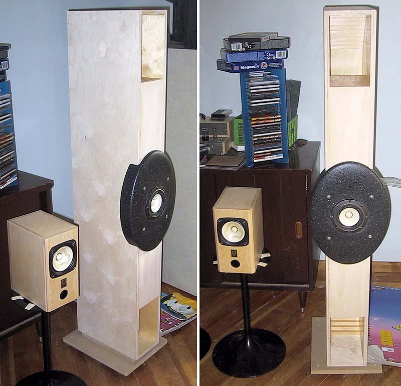

Yup, guilty as charged, I'm the lunatic responsible for the Spawn family designs (with Dave doing the CAD drawings). Of course we don't mind people using them -that's why they're there. Like everything on the site, they're completely open-source & free for the world to use, so people can do what they like, even produce them commercially on a cottage-industry basis, which we wholeheartedly encourage.
Anyway, you're right -Hiro will be closest to the I-BEN sonically -the stepped designs are more efficient than the BVRs & should have better dynamic capabilities. I've attached a picture wee were sent of a completed build. You should get a crisp presentation from this cabinet, with powerful mid & upper bass & a large image, with good depth perspective. They should be usable down to the mid-low 40Hz regions, in-room & still have some output (very quietly) in the low 30Hz regions. You can use any of the Fostex 6 1/2in units (166 or 168ESigma would be best) or the Audio Nirvana 6 1/2in drivers. I'd favour the Fostex myself -the AN units have a higher Vas & roll off a bit more in the LF.

Nice photo. What does the circular disk on the front do?
The extra baffle? It gives the driver a bit more room, and pushes the baffle-step point downward to a fequency where the cabinet itself compensates for the loss. And if you understand that, you're a heck of a lot more knowledgable than I was when I started out a few years back. 😉 (OK, showing mercy, you get a drop-off in sound-pressure levels at the listening position at a point that is determined by the width of the baffle. If you're interested in the technical side, this is the transition from 2pi to 4pi radiation space. If you engineer the horn to provide more gain, you can compensate for this loss. The additional width of the baffle lowers the point at which baffle-step loss occurs to the point where the extra gain from the horn kick in, and balance things out).
