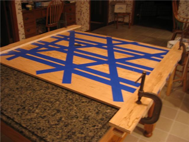

the 1" MDF carcasses for these were not just folded and masking-taped together

Ok
First:
Yeahhhhh!
I received the authorization from the owner to share the pictures, etc.
He kindly sent to me those a few weeks ago.
I know I could have just post the pics but, better ask first.
Here they are.
The speaker as a flat panel
