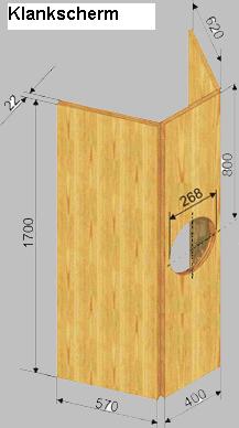

Some time ago, diyaudio-member "jaap" wrote:
"A good combination is the 9710 with the famous Philips Bombardon Woofer (AD5201 S77) in a closed box: see the philips booklet, number A13."
I tried to email him about this booklet, but I can't since I'm under moderation as a new member.
Maybe somebody has access to this "luidsprekerbehuizingen voor zelfbouw" booklet?

It all boils down to a box for the bombardon, ported or closed, and a smallish open baffle for the 9710 on top of that.

I am still very happy with my combination from the aforementioned Dutch booklet "luidsprekerbehuizingen voor zelfbouw".
I added one Philips dome tweeter and packed the 9710 in a small bucket full of Isover. Combination sounds a lot brighter.
