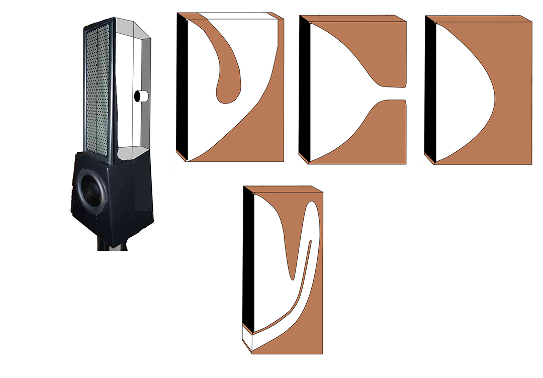

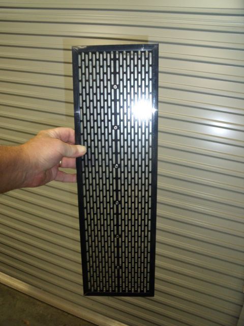

I have these nice little electrostatic mini panels. I like them as dipoles, very clear down to a respectable 250-300Hz, but I prefer them high-passed at 400Hz. Because between 250-400 hz I hear that I am missing something.
Sensitivity: 90dB at 2.83V.
Membrane size: 135 x 485 mm.
I am thinking about making a sealed or ported enclosure for them, to check if I can get down to 250Hz, because the 15" woofer is not great at midrange.
Almost everyone advice against using an electrostatic speaker other than as a dipole, but I wonder if many actually tried it. Is there anyone with some experience that would like to share it, before I just build one from guessing?
One guess for a sealed cabinet would be to use the lowest wavelength which could be 300Hz, which translates to about 110cm in length. Then make the back chamber a third of this which is about 36 cm. So the back chamber will be 13.5 x 48.5 mm and 36cm deep. For ported I have no idea.

You talk as if a box brought some benefits. Aside from sequestering the rear wave, which is what you'd be talking about if you had an elementary grasp of the subject, there's not much good about a box behind the cell and various that's bad.
But sticking with your idiosyncratic line of thought, what you want is an open back box filled with sound absorbent. That will provide you with what you are asking for.
Ben
one of the most prominent advantages of an esl is its mass-freeness.
A classic CB modifies the mass-spring system of a dynamic driver so that the typically insufficient LF-response is pimped to an acceptable response.
With an ESL the tuning frequency may easily become too high, which on the other hand means, that comparatively huge cabinet volumes are required, prefferably not closed, to not raise the fundamental resonance too high.
A second point is that one needs to ensure that no reflected sounds pass the ESL membrane from the cabinet's inners.
This requires efficient damping of the panels rear sounds.
Mr. Walker suggested a rather shallow deep cabinet with decreasing crosssection, ending in a small slot, dampened with loads of damping material.
In other words, a classic transmissionline.
The easiest would probabely be to build a stuffed-with-wadding, trapezoidal shaped casing with an open backside.
The required depth to be effective will be large though, maybe requiring to roll up the casing (similar to B&Ws Nautikus) or to fold it.
As practical Transmissionlines behave rather similar to BR-Boxes the dimensions of the TL need to be tuned to fit the panel-cabinet fundamental resonance (built-in resonance fb).
You could maybe solve the problem of acoustic phase cancellation (that starts already below ~1kHz with such a thin panel), but You'll need to equalize the panels response anyway.
So, equalizing slightly more but driving the panel as dipole will imho lead to a more satisfying result with less building effort.
As sreten pointed out already, it'll be almost impossible to xover a 15" to such a small, thin panel without massive problems regarding homogenity of sound.
Seamless transition from woofer to panel is imo impossible here, regardless of the panel beeing boxed or a open dipole.

Thanks you for the information. The manufacturer had not provided any such data,but I can ask. Is there any way I can simulate this as a regular driver? I could get the Dayton Audio speaker measuring device to tune a TL or BR correctly.
I am thinking that a sealed design might put more strain on the thin membrane.
Again, for the third time, I already know that many people prefer to use elctrostatic speakers as dipoles. No need to point out that I am a beginner at the English language, audio engineering and electrostatic drivers. I stiIl would still like to try this and see how it turns out.

How about this enclosure made for the Feastrex 5" as a starting point? It would follow the edges of the panel, and then continue behind, depth unknown, and inside shape unknown.
I was trying to think hard what could work but I have no idea with such a driver. Nautilus could work, but so much work. I might try it if I like it in a regular box where I test ported and sealed. I was even thinking about back loaded horn like a Frugelhorn, but it might sound weird and take up space. I just need 250Hz, which I already get with EQ. To get a 5" high efficiancy speaker driver to play down to 250Hz does not take much at all. A few litres maybe.

But the key point to remember is that early sealed ESL boxes had multiple cells spreading the beam. So, you can make a sealed box (or better, leaky box) but not if using a single cell.
B.
Well young folks, I remember well the early Jantzens (spelling?). Striking sound indeed. I think his issue was hiding all the HV circuitry and the garbage look of his ESL backsides (with damping from paper towel material?). Also, how else could he pass safety inspections?
B.
Thanks Ben, good idea. I will put all the electronics inside. There are already a few subs around to take care of the low end, and under the ESL panel will be a mid-bass driver to cover 100 Hz to whatever I feel like.
The spelling is "JansZen". Some of their current speakers use single cell - like JansZen Electrostatic Active Hybrid Speakers.
Did you get the MFB subwoofers working well? I may get into this if I get in troubles transitioning to ESL panels.
Off topic. Yes, for several decades with a Klipschorn bass (prolly speaker that needs it the least in the world). If my clients will let me retire, I may make progress on a new accelerometer method.Did you get the MFB subwoofers working well
On-topic. While I've never fussed about "matching" ESL sound to woofer sound, when you think about the aural charms of ESLs, MFB sounds like the right match.... and why those of us who favour dipole mounting think it is more natural to ESL sound than a box.*
B.
*if you really want a box, stuff with wool and leave the back off.
