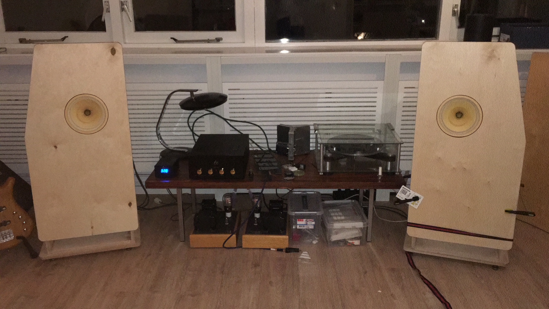

So I have acquired a pair of coral beta 8 drivers. I'm now looking for cabinet for them. My goal is to build a not too wide, not too deep cabinet for them. Could be a floor standing box design. Anybody tried such design (bass reflex?) with good results? I don't really want a horn, since I have other horn designs built earlier, but for other drivers (fostex and lowther), and want to try some simple design.

Voigt pipe (sometimes called Voigt horn) ?
Or bass reflex along Heco Direct Einklang. Fullrange driver, wide baffle speaker and floor loaded bass reflex ports

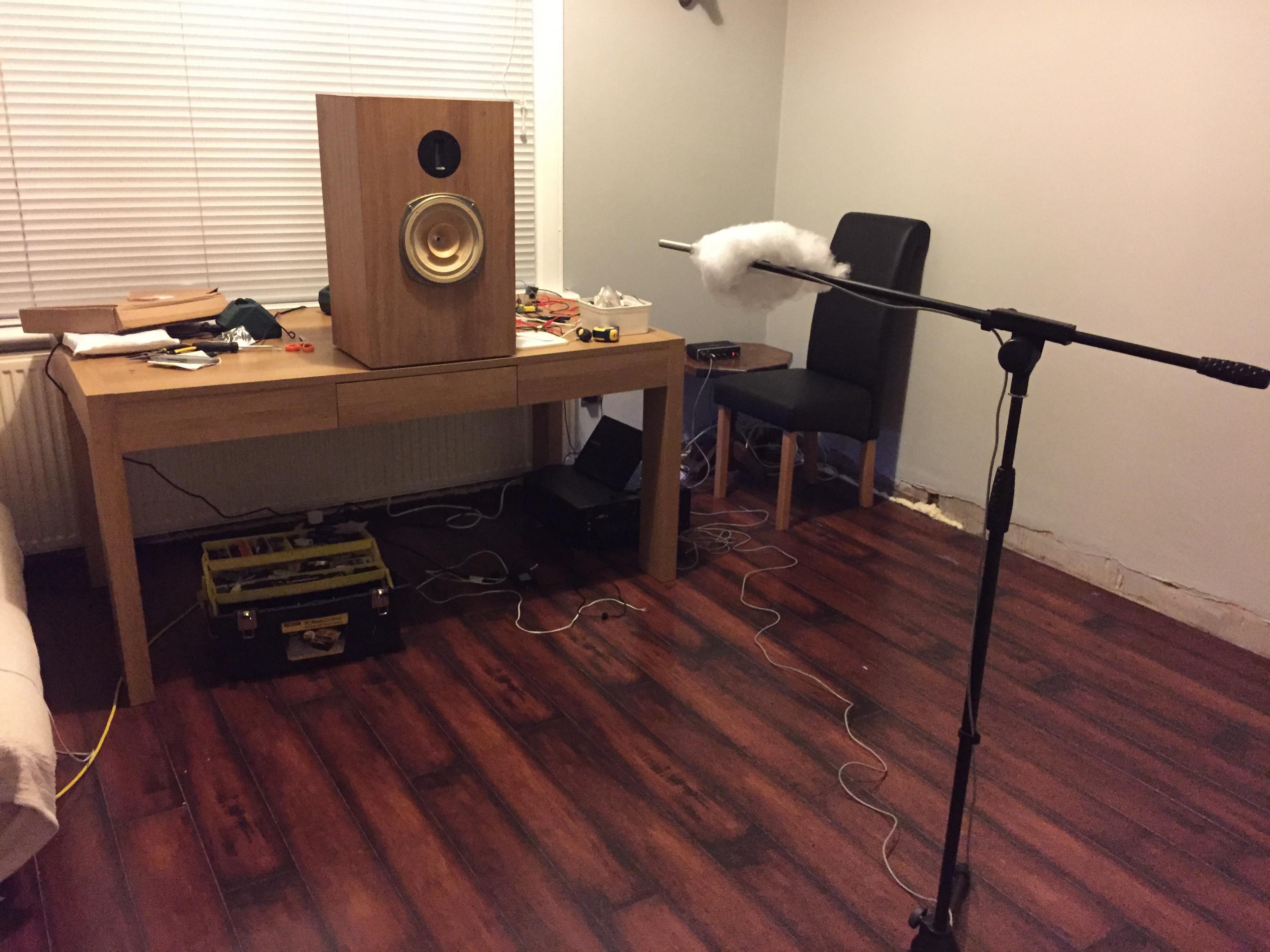

Not sure how close the T/S parameters of the Beta 8 are to the Flat 8II, but I have my Flat 8 II's in 45 litre bass reflex cabinets with two 75mm diameter ports tuning the box to 41Hz.
A nearfield measurement shows an "early gradual rolloff" alignment vaguely like a QB3 which is -3dB at 50Hz and -6dB at 40Hz, however in room they have good solid, well balanced bass down to about 40Hz in a typical British size living room.
In fact I have -6dB 1/3rd octave PEQ notches at 41Hz, 71Hz and 108Hz to compensate for room modes and there is still plenty of bass down to 40Hz. (By coincidence the lowest room mode is at the same frequency as the port tuning)

I'm currently using them as a midbass driver crossed over at 3Khz with an Aurum Cantus G2 ribbon using a passive crossover. Here is a not very good picture taken recently while I was taking measurements for the crossover design:
Two 75mm ports are on the rear at the bottom and top. Previously the bottom port was on the front panel but when I re-veneered the outside I decided to move the front port to the rear panel as front mounted ports on 2 way systems put out a lot of spurious midrange. (There is a large port resonance at about 700Hz which was easily audible and measurable when it was on the front)
The crossover (designed in Vituixcad) ended up fairly complex but I'm extremely happy with the results and while the crossovers are still outside the cabinets and having minor tweaking done over a long period of time they are otherwise finished and in daily use in the living room.

Like Lowthers, Coral Beta 8 don't like bass reflex. May be Voigh pipe...

I liked it very much in BLH!

do you have maybe the drawings of this cabinet optimised for beta 8?
