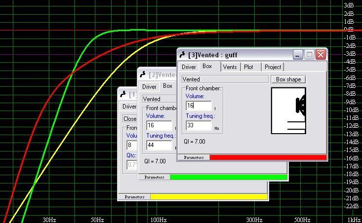

Hmmm........
The cabinets are even more inane than the crossover design.
😉/sreten.

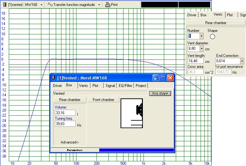

I used this specs instead.
Morel MW168
http://www.morelhifi.com/products/raw_woofers.html
Morel MDT30S
http://www.morelhifi.com/products/raw_tweeters.html

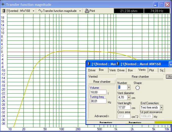

note: please ckwong, don't get confused because of the use of different softwares, each one has it's own number crunching so that results can be a little different. here is WinISD.

Hi Coil,
Sorry for my typo error it should be 33L . But this volume is quite large for me .
Last Saturday I found a finished box internal volume about 18L vented type. Not sure what low frequency can it be sounded installed this driver ?

From 18L we need to know how much is for speakers (+ inside braces) + Vent Area x Lenght (volume).
Also the type of the vent? (for End Correction variable), some have a flanged end.
It looks good. Anyway, this woofer behaves very well.

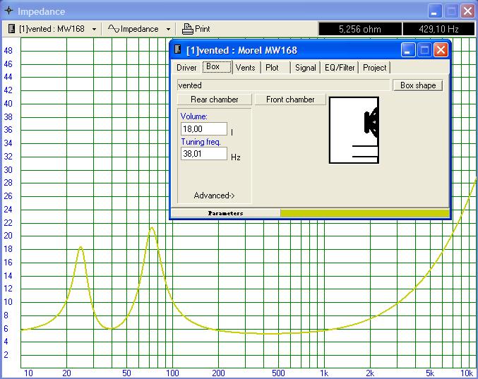

Hi Coil,
According to your attached spectrum diagram found the -3db roll-off point at 50Hz and 2KHz.
So Is it a reason of the xover designed for 2K point ?
What is the tuning frequency (the roll-off level in -6db) ? How to determine it ?
The spectrum diagram highlighted 21.2 ohm and 74 Hz. What these two parameters used for ?
Thanks for your patience in advance :>
CK

Tuning frequency is at 38Hz. Do you mean you want to know the formula? Or do you mean you want to know the formula for the xover components?
For your last question I am not sure (but it would help if you would use WinISD or another software, are you using it already?)
The graph for impedance is here (woofer/box + port)
18.5 Ohm@25Hz
21 Ohm@73Hz.
These two parameters are the resonance as in a Helmholz resonator due to the compliance of the enclosed air and the inductance of the air-mass in the vent.
