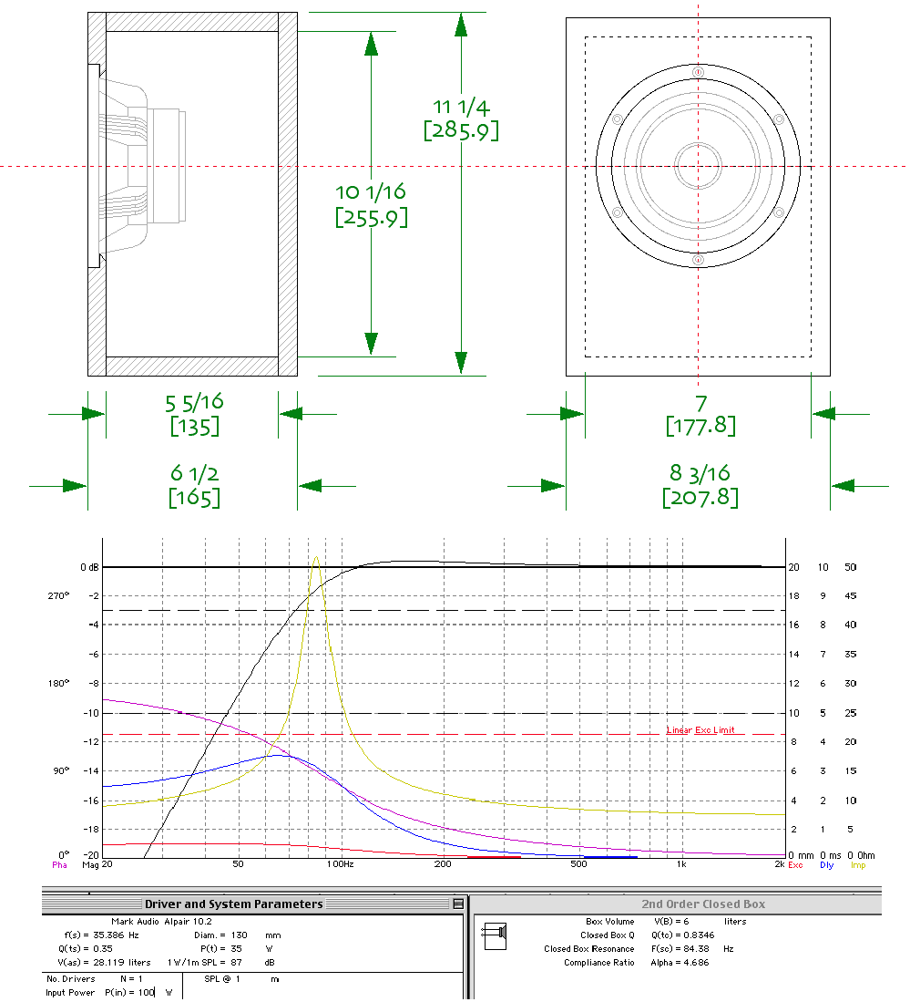

thanks for clearing that up so quickly 🙂
The design looks good, you think the 84 Hz (-3db) is enough to use without a sub ?
TV is a 42inch, approx 1 meter wide.
84 Hz would work (really) well with a sub, you might find it a bit lacking without.
My 42" TV is 62 cm tall. If you could live with a spaker the same height as your TV, i could likely come up with a box that would get you another ocatve on the bottom, and the same depth of the TV (mounted on the wall).

If you could squeeze them in, I'd sure look at the Mar-Ken10 cabs. i doubt you'd need a sub!
Best, Don

You don't want to split the box up. You could use the 18 litre into a woofer box thou.
What is constraining you to 6 litre? Can we go back to where exactly (in detail) you need to put the speakers.
