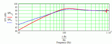

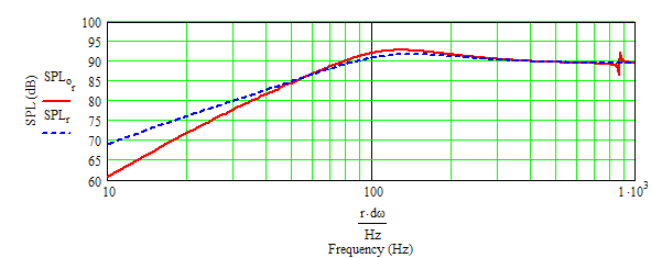

Using Hornresp to 'iron out' T/S discrepancies yields a 0.54 Qtc in ~0.502634 ft^3 net with a calc'd ~78.5 Hz F3, 50.5 Hz Fb.
A much more realistic half space [2pi] sim done using MJK's MathCad software [zero stuffing density since it's an acoustically tiny, ~golden ratio cab]:
GM
GM
It seems designed to be vented or to go with a passive radiator.
Right, 'vented' as in some type of TL or PR due to the excessively long vent required otherwise.
GM
