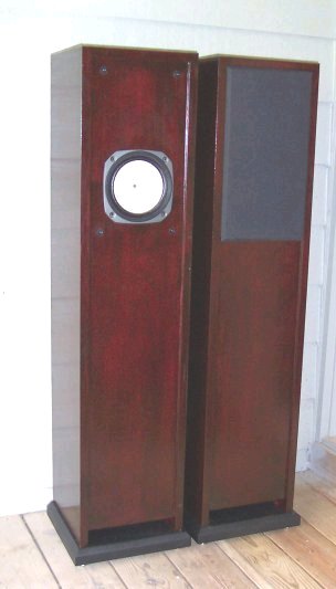

1. When I started building speakers, I had nothing but a saber saw, a corded drill and a plane. With these tools, I built the attached. The techniques used are HERE.
A circular saw will allow dead straight cuts. The simplest guide is the manufactured edge of a piece of MDF/plywood. When making identical panels, cut one to final dimensions, then cut the other(s) slightly large and plane it to match the first one. A table saw allows exact replicas in width. With panels longer than ~24", you will need an outrun table/support.
Cutting to length is a major problem. With panels >12", a miter/chop saw is the best bet. Next best is a circular saw and an accurate guide. A table saw can be used, but requires a crosscut slide that runs in both miter guage slots.
In short, anything that can be done with power tools can be done with hand tools. It just takes more time. A lot more time.

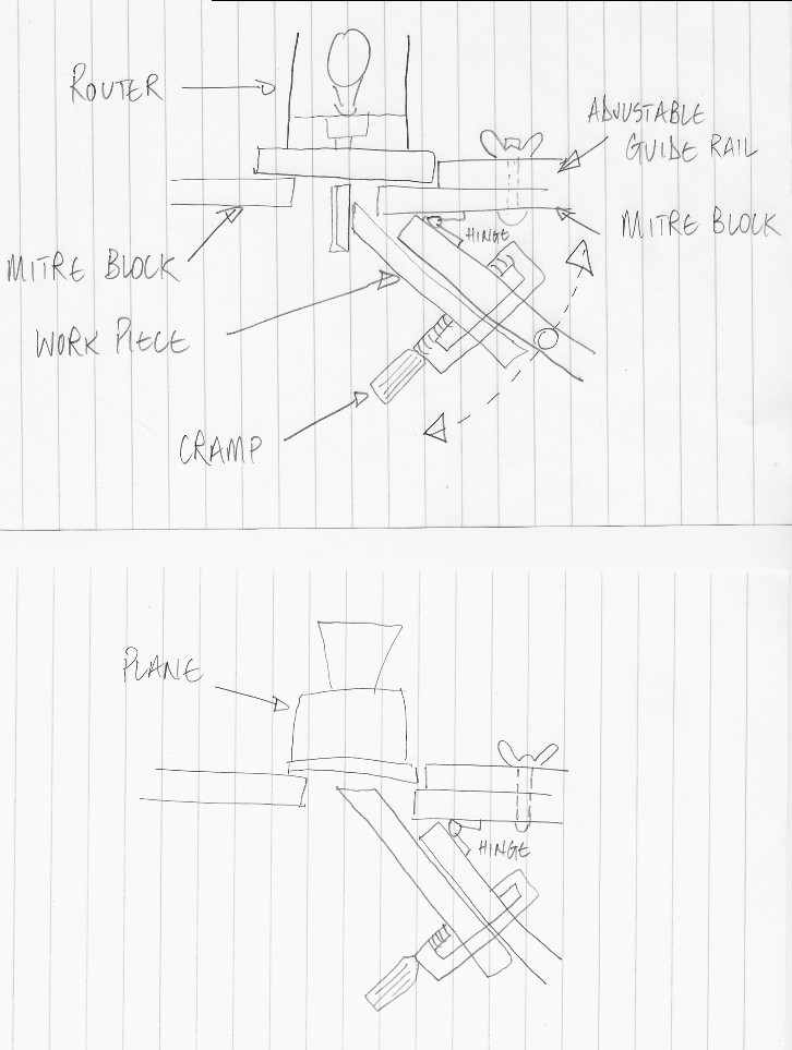

Hi Zottinger
hopefully this will explain...
using the router method its possible to get some really sharp angles...the only restriction is the length of the cutter used.
regards
Ed
regards
Ed
