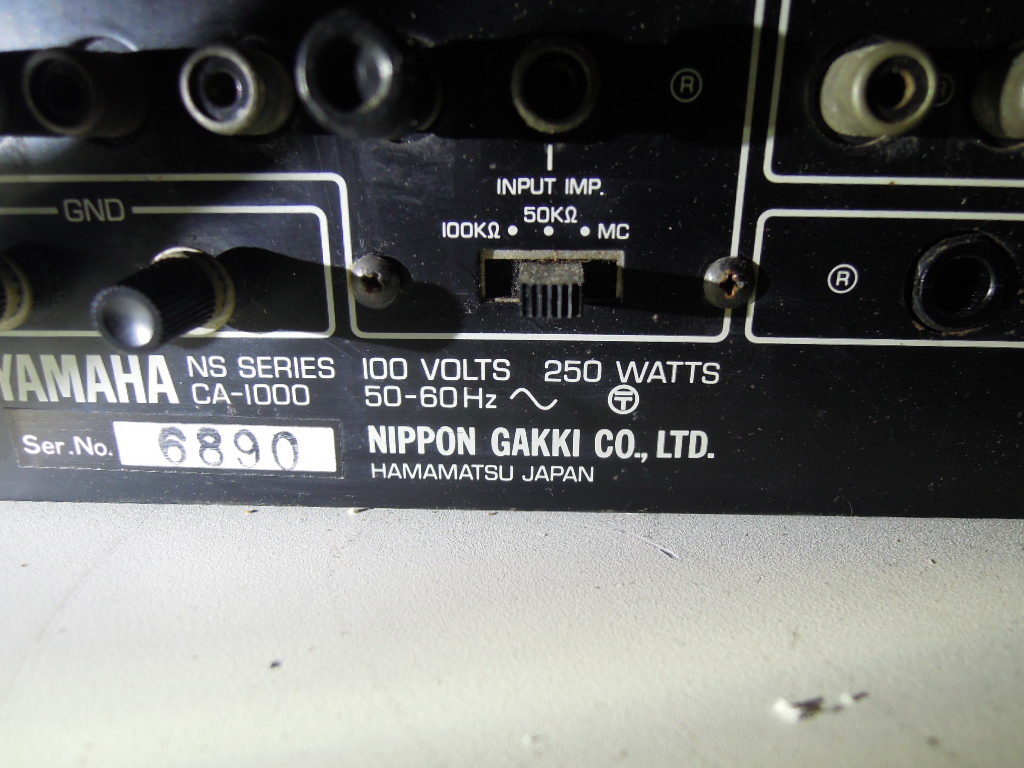

I have purchased a 100v ac Yamaha Ca-1000 from Japan and I intend to use it in Australia which supplies 230v ac
Rather than purchase a step down transformer I was wondering if it were possible to reconfigure and modify the transformer to run on 230v.
The repair manual states that this is the same transformer for all countries.

I would not recommend this type of repair for you, due to your inexperience. 220 vac is not to be played with. You can really get in enough trouble with 12 vdc!!!!
The frequency of electric current is 50 Hertz in Eastern Japan (including Tokyo, Yokohama, Tohoku, Hokkaido) and 60 Hertz in Western Japan (including Nagoya, Osaka, Kyoto, Hiroshima, Shikoku, Kyushu)
You can only use the CA1000 (in OZ) if it has a 50hz transformer.
If it was a Japanese home market product, it will be 100V only, there will be no tappings inside to change the primary to other voltages.
Just buy a stepdown, but get a Japanese model, sold in Japan for Japanese people to take with them to 220v/240v countries. Decent ones have an internal twin primary (220/240) and sometimes a switchable secondary (100/110/120) so the transformer can be trimmed to the mains voltage more accurately.
Bear in mind, we are officially 'nominally' 230v now in Australia (with a greater tolerance), but no infrastructure has changed from the nominal 240v we have had for decades. I sit at 241v here right now and at peak times, it may be 230v. At low load periods, it may be 254v.
What does that matter? Well, when you are stepping down to 100v, the difference is 10v, so be careful the stepdown is actually sitting on 100v when at a typical line voltage.

Not all Yamaha are able to run on 50hz.
Unless it has a 50hz transformer, it cannot be run on 50hz, even if you step the voltage down.

Anyway, his Japanese amplifier will have 100V XXHz on the back. If it's 50Hz, he's good to go with a stepdown.

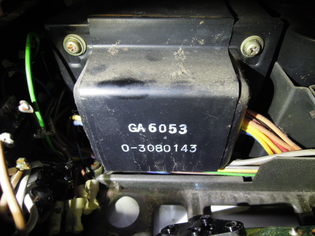

The Service manual linked in post2 states:
GENERAL
Power Source AC110, 117, 130, 220, 240V
50~60Hz
Power Consumption
Rated
European model 560W
That tells me that the European model used a universal transformer that worked everywhere except the 100Vac Japanese regions.
Just check which transformer is actually inside the unit.
A technician will recognise a universal transformer in an instant, if you have taken the cover off for them.
