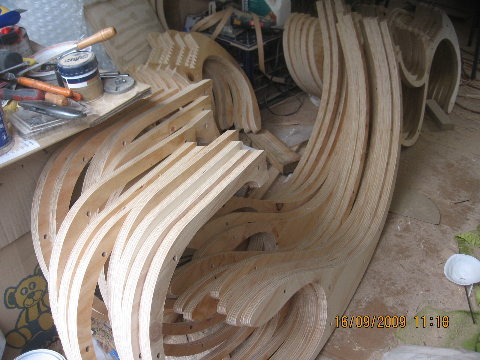

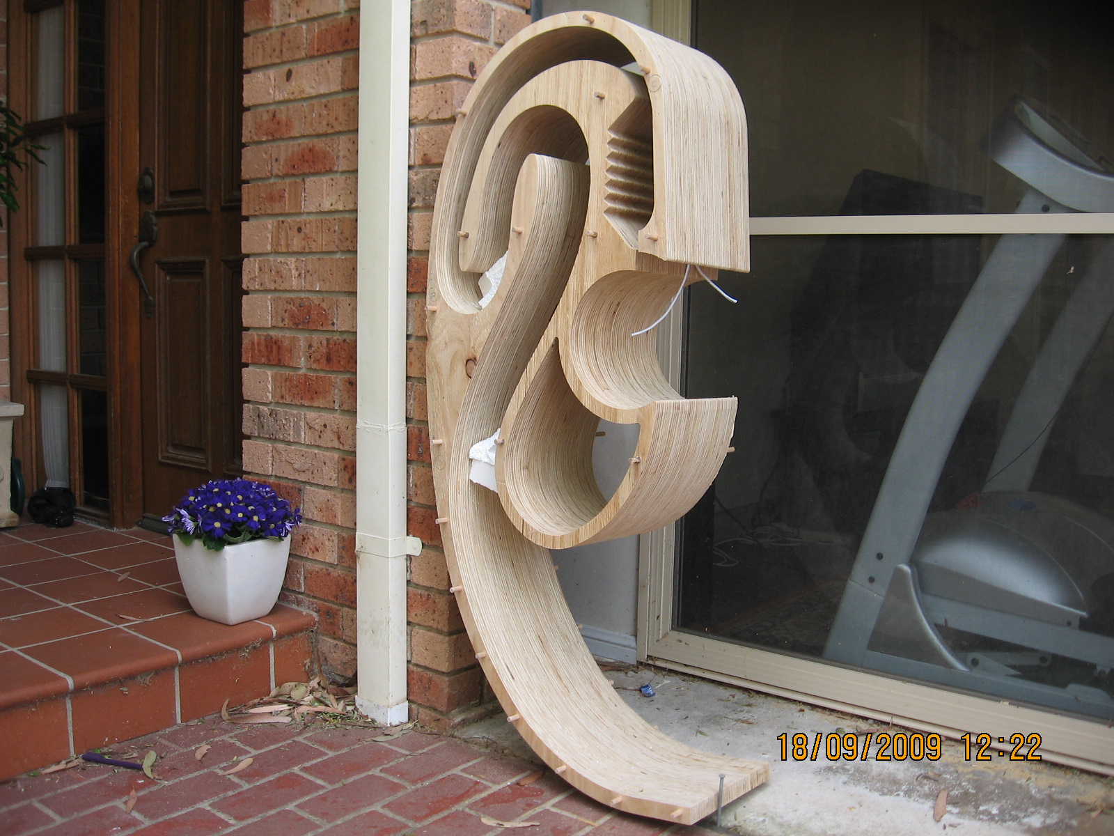

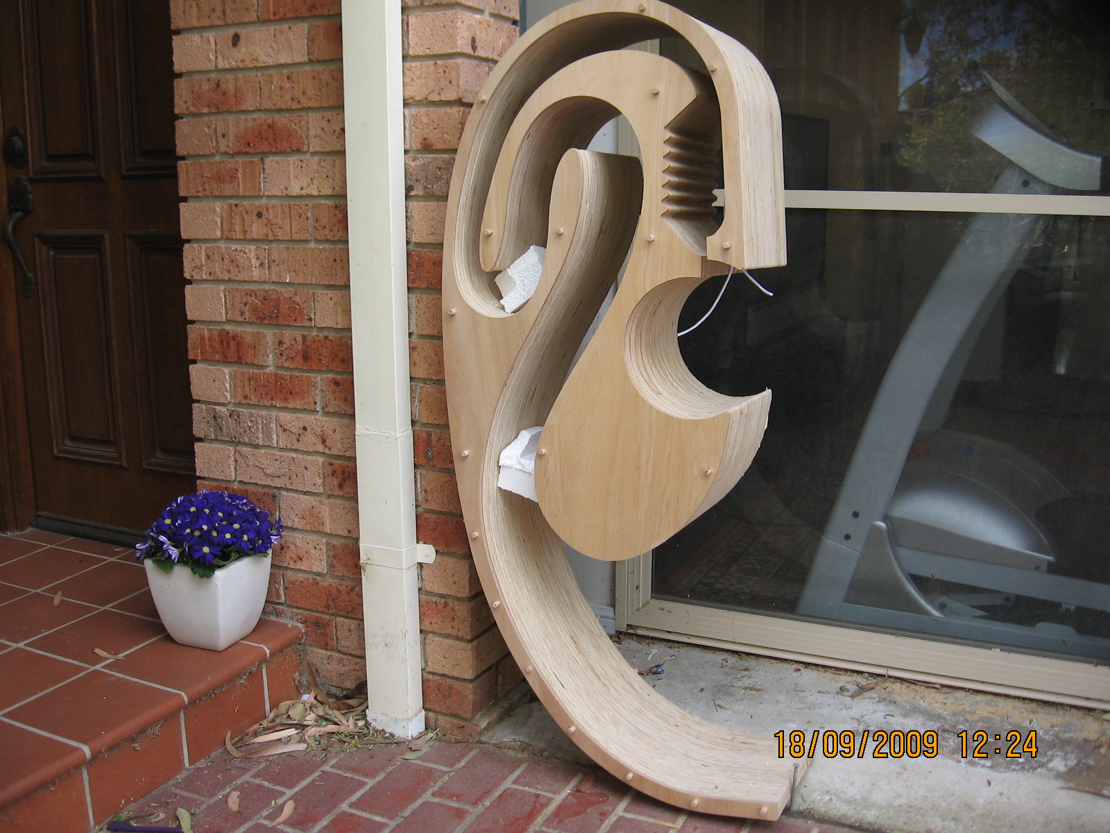

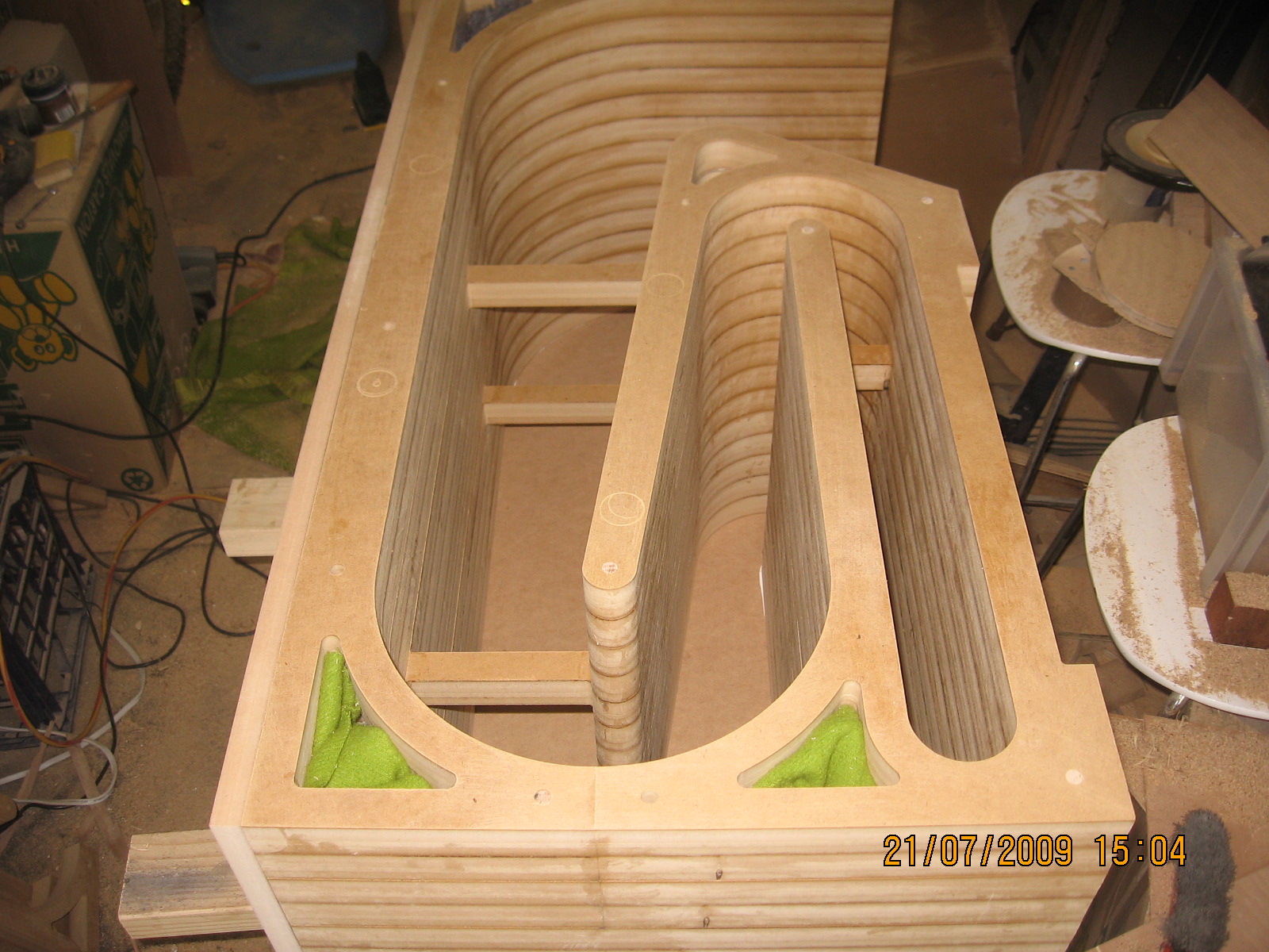

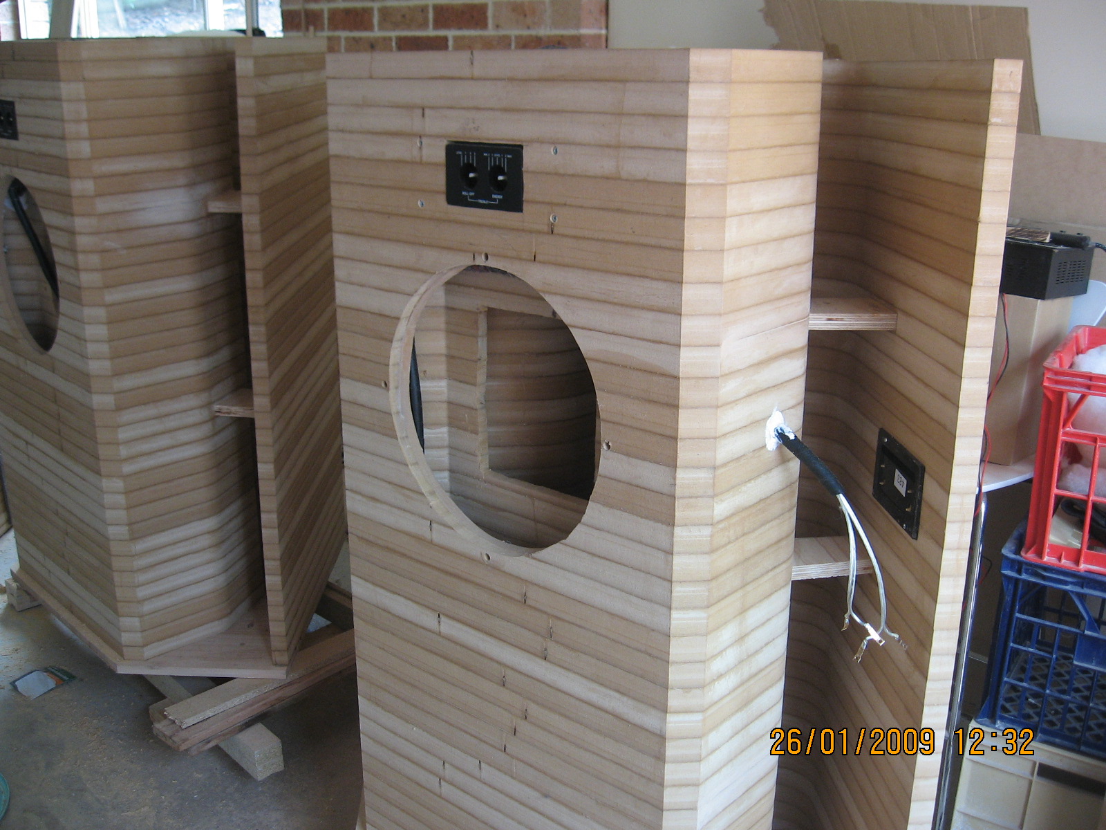

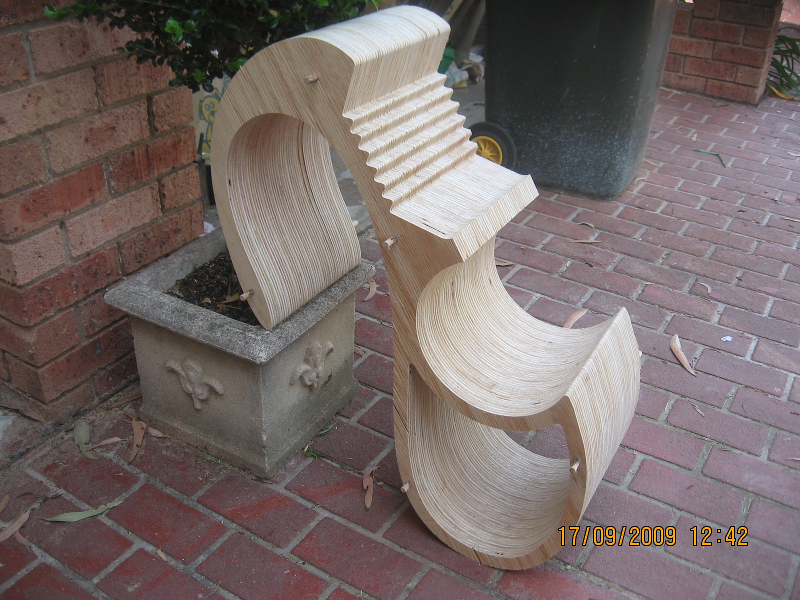

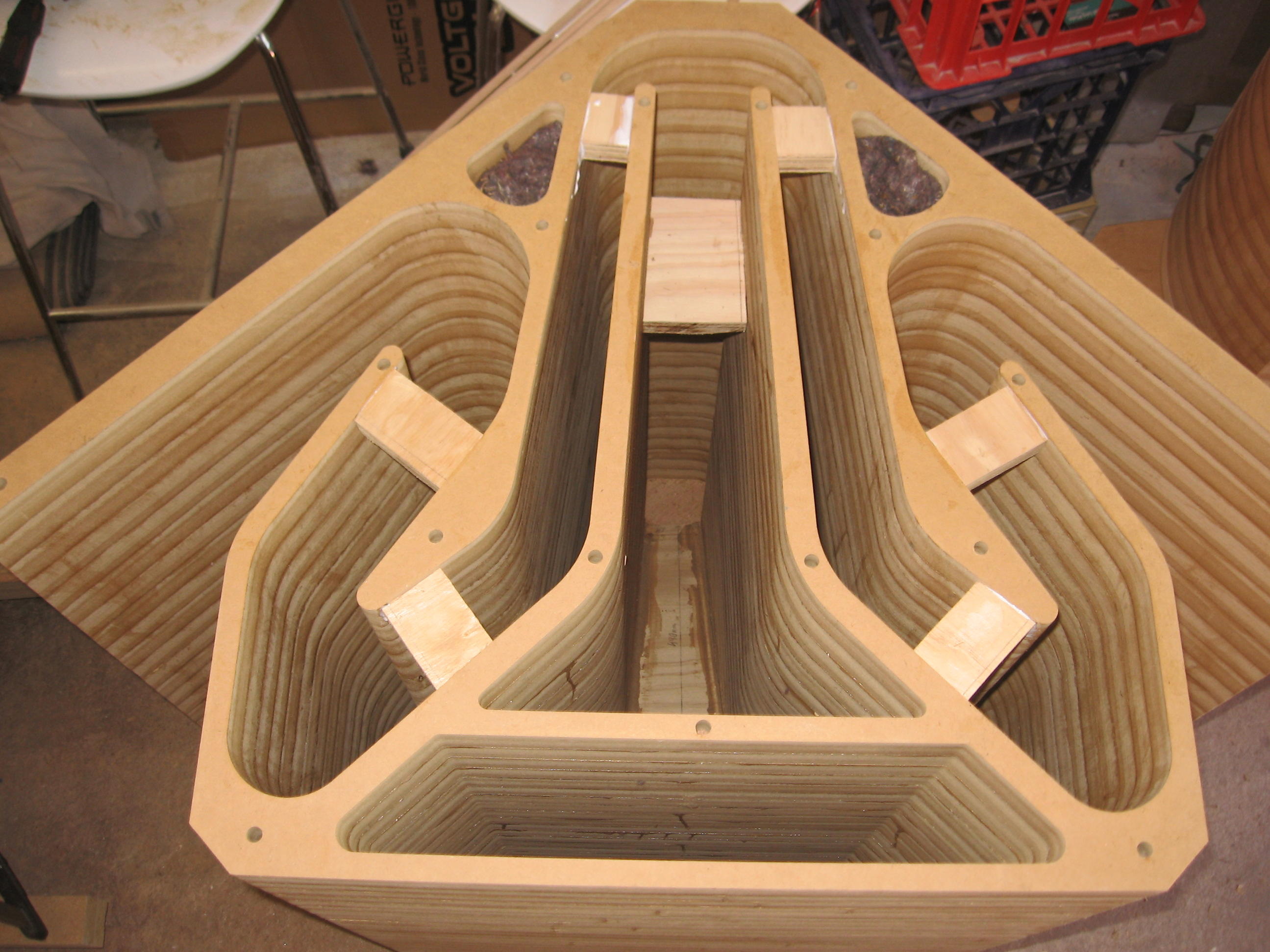

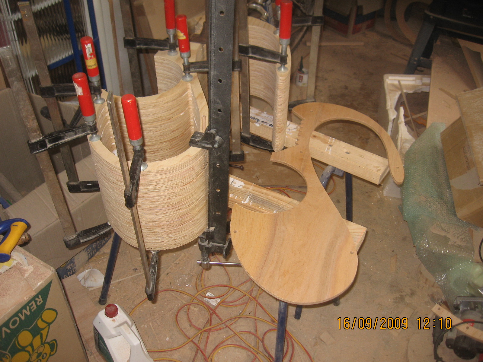

I started this all-ply version of the C-Horn today, using 25mm standard ply for the internals, plus a nice 12mm Kauri Pine ply outer panel. The 25mm acrylic side panels will still be used per my normal C-Horns.
Likely finish will be a light stain, plus a satin clear spray varnish. Sould look smart....a bit like the Clearaudio turntables using Panzerholz.

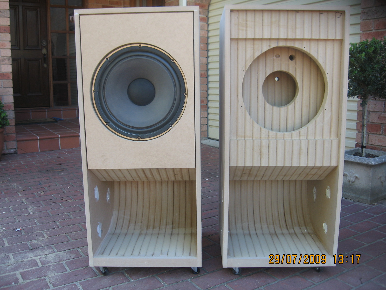

Working with ply is SO MUCH nicer than MDF!!...lighter too. The wieght should come down from about 95Kg each to a much more manageable 75Kg each (165 pounds).

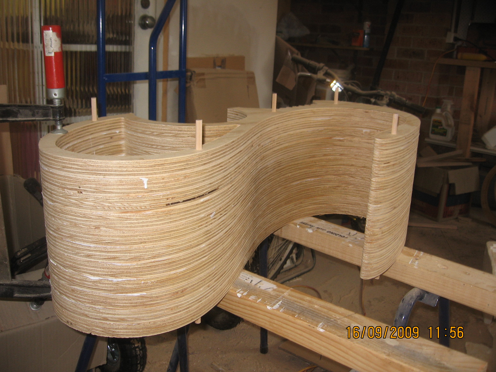

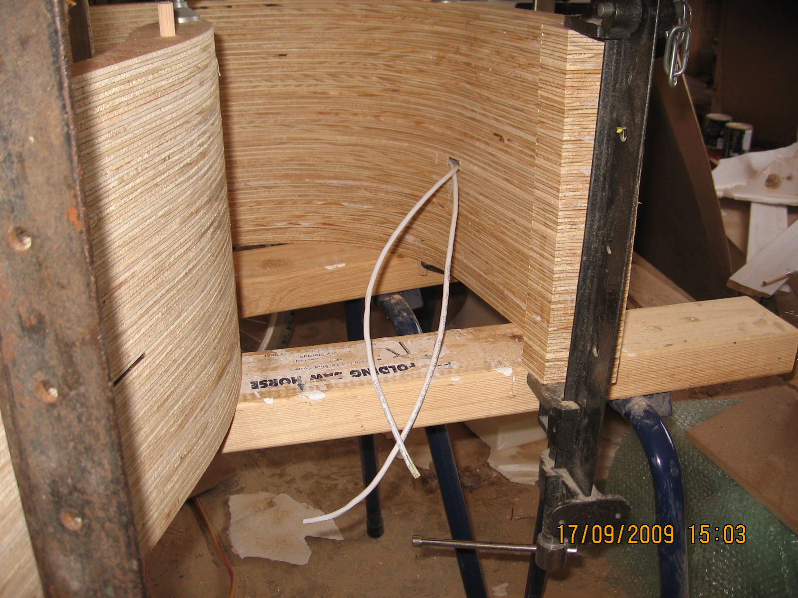

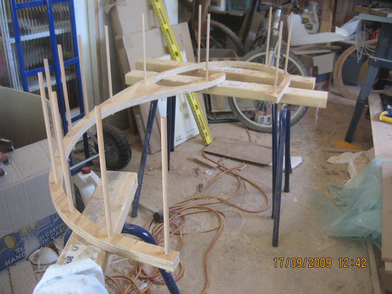

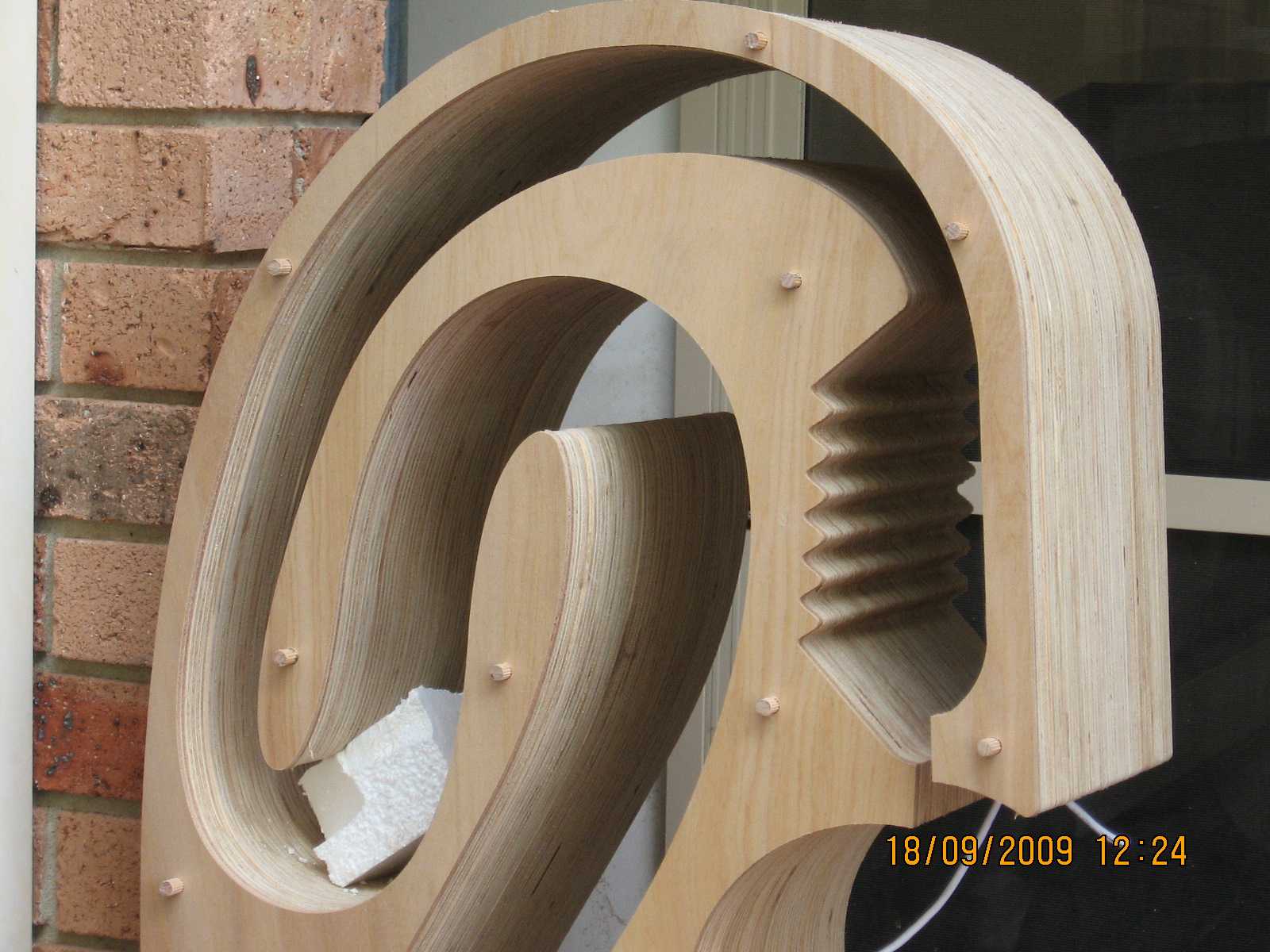

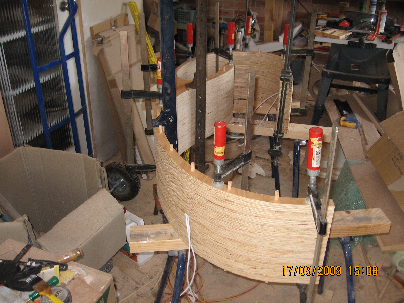

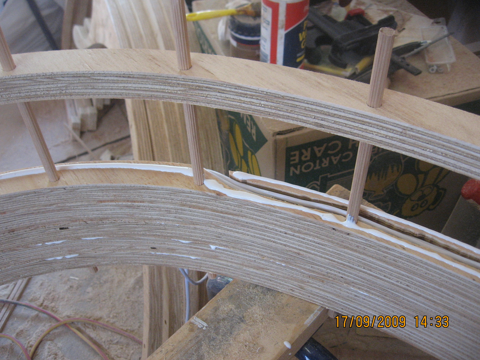

I've tweaked the design to incorporate the cabinet being made in 2 pieces each side. This is much easier for sanding/finishing. The dowels will protrude from the ply internals and slot into the matching dowel holes on the acrylic sides to help with alignment, especially as the wood sections flex a little.
Large 75mm hex screws are used via the Oak dowels to secure the side panels....then plastic caps are fitted.
My friend who's getting these will be using the Fostex 206E driver....but we're going to router an extra channel into the horn slices to accommodate a possible Field Coil driver later on.
A fun project....

My CNC guy uses Mister Plywood normally. Note, the outer slices are the pricey Kauri furniture-grade ply.
To save on costs, we use the large 3.6m sheets. Heavy though....

What do those cost to build? How long do they take? Compared to this curvy horn, they're a weekend and a couple sheets, vs. hundreds worth of ply and a ton of either CNC or tracing time.
My point, and this was obvious, was that given the extremes taken to make a smooth flare in the vertical domain, it would have made sense to make it a 3 dimensional flare. I'm quite certain the side-side resonance is visible on the impedance curve, FR, and CSD, and in all likelihood quite audible once one is alerted to it. It's like hot-rodding a car and leaving stock tires on.
They're beautiful, but what a shame, that the last little bit, that would have been easy (within the context of such a time-consuming, expensive build) was left out.

From the look of these, which are relatively wide (about 2x as wide as an equivalent "Spawn"), I'm pretty confident that the side-side mode will be plentifully excited.
Badman, my CNC slicing technique means I can build a cabint easily on a weekend...so that argument is not entirely valid. Also, all of my designs can be bought by DIY enthusiasts, who wish to build something a little different, and can do so in hours, not weeks per normal manufacturing techniques. (Try building a Tannoy GRF in one weekend....!) If this means parallel walls, so be it.
The waste argument has some validity, but I nest the smaller section of the horn in he mouth of the larger piece...so waste is reduced considerably. But, I consider this waste to be perfectly acceptable in order to create such an exotic scultpure. The speaker is as much a talking piece as listening....especially in this new all-ply version.
On the non parallel walls, I guess I just have to leave your concerns to you. But please remember, I'm using a 2-dimensional cutting process, not a multi-axis router....so saying that I've just failed to complete the last part of the project properly is a little unfair. To build a horn as you've suggested would require a completely different approach. As I said earlier, I commend those folk who do such work.
