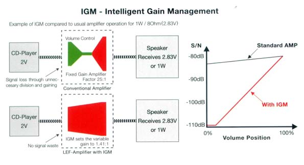

From pdf
But in the only one published test with measurement was distortion about 1,5 % near full power, so it seems, something is wrong...
The main influence of sonic character comes not from the distortion value but from the kind of distortion. 1,5% low order components is less critical than lower values of high order/complex components created by class b.
Until now most employers by test reviews don't understand this fact - unfortunately until now there are additional no THD/IM measuring line up exist, that privide results so I know, how an amp sounds without carry out an own listening test.
P.S. by post #10 about
http://www.diyaudio.com/forums/pass-labs/5808-cec-amp71.html#post3435797
there is my circuit describtion according a CEC schematic, which I have receive in the meantime. However I doubt, that it is the so called LEF topology.
Thus I am still looking for CEC's LEF schematics.
