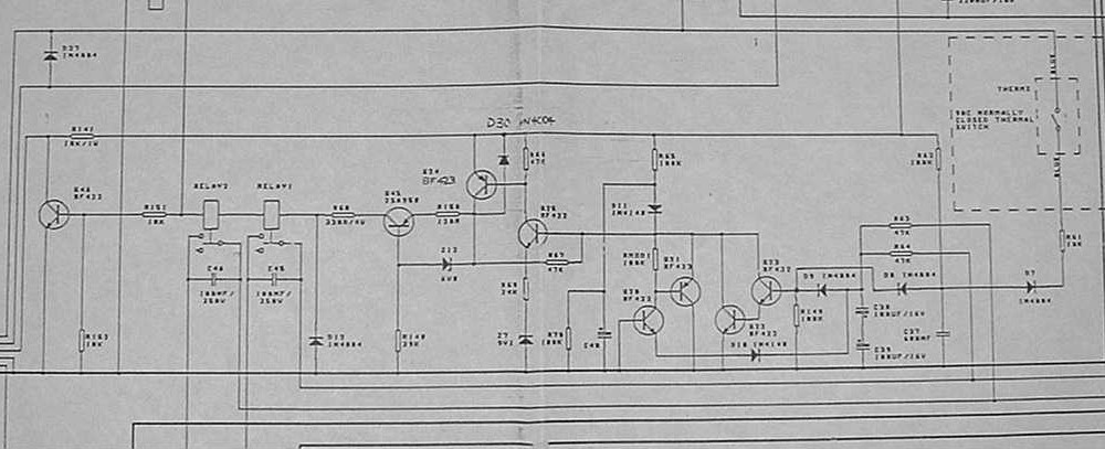

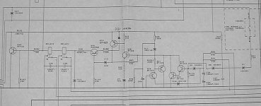

Hi Again Hugo,
I've been working on this amp today again. It must be similar to the ones you remember as the FETs are indeed J50 and K135... I've desoldered one leg of each device and tested it and they all appear to be fine - no shorts..
When I apply power the protect light comes on instantly - None of the relays switch. I've also noticed that the VU meters for both channels light up to the second mark (So Green '-40' and Amber '-20' are illuminated). I'm wondering if there's something happend to the input stage that's causing this - Given that it's both channels I have to suspect power as I believe that's about the only thing they have in common.
I still haven't got round to taking any photos yet.
Theres a pair of 16v 2200uF Electrolytics at the front of the amp that I'm a little wary of. They connect between the AC output which drives the FETs and the AC output which gets send to power the input stage.
Also, I previosly mentioned the 110v 4700uF caps which are all bulging - What's the chance that these are actually causing the problem? As much are they've bulged they all give pretty consistant readings out of the board.
Any other advice would be great because I'm struggling to find anything that has failed in an obvious way.
N.B. I've not gone hunting for 22k resistors yet - Will do that tomorrow.
Jonathan

Jonathan,
At least we need some decent pictures (caps). That will hopefully give an overall impression of the state of the amp. Some clear photos of the solder side would be nice too.

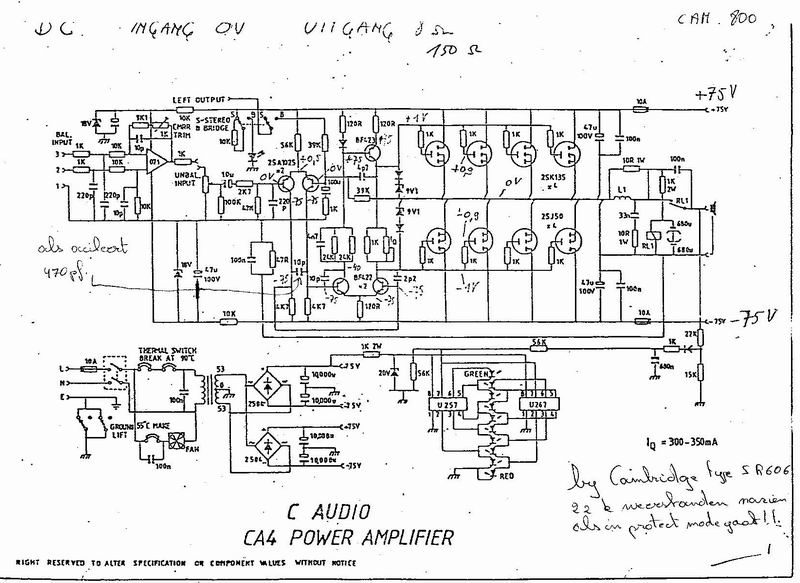

The schematic attached is from an old CA4 but it gives an idea of how the mosfets are wired. Note that the metal cases (sources) are the output. If you measure DC on these, the output protection will kick in. Also, the gates should have +/- 0.9V with respect to ground.
/Hugo

Thanks for the schematic - that's helps a bit...
I've just realised that I've been a real dimwit ... Don't quite know what I was thinking, but somehow I've invented mosfets that have only a Gate and a Drain!!!
So I'd better test between Gate/Drain and the 'SOURCE'! Doh!
Given that I kinda missed the 'source' even though it's obvious, I reckon there's still a chance of a failed mosfet causing all my grief!
I'll check that, plus look for spurious DC and will report back!

I any significant DC is present at the output, you will need to take out every mosfet to test properly.
At least temporarily remove the rail fuses. Any remaining DC -from the big caps- will influence the measurements.

Hi Hugo,
It looks like I've got + and - 0.4vdc on the Gates, and no DC (>0.01v) on the sources.
I'm still puzzled by this.. I don't want to leave the amp on to long at any one time as the Soft-Start Resistor starts to get quite hot...
I'll keep working on this - I need to look at the diagram in more detail and test some more points.

So the Amp's going into protect mode, but there's no DC on the output and the main power stage appears to be fine. Regardless of what source I feed into the Amp, the VU meters remain permanently with two leds lit per channel.
None of the relays ever switch over - I can understand the output relays, but what about the Soft-Start resistor relay? Surely once the amp has come on, that should still switch over to bypass the resistor? (I presume that soft start doens't actually reduce the voltage sent to caps/mosfets, but simply provides a bit of 'ballast' to help avoid spikes on start up?)
Do you have some other ideas because I'm definitely getting out of my depth with this amp.
Many Thanks
Jonathan
Hi Dave,
Thanks for the input on this....
Interestingly enough I'm pretty certiain that the TO220 transistor (if it's Q45 in the following photo - http://dynamicdiscos.co.uk/AMP_Pics/Large/DSCF0203.JPG ) has already been worked on in the past as the soldering is clearly different.
(You can see flux left round the pins in this pic: http://dynamicdiscos.co.uk/AMP_Pics/Large/DSCF0184.JPG )
I did test it for shorts a while back and it seemed fine, I'll test it again though and I haven't checked the coils on the ouput relays yet...
Do you by any chance have a higher resolution picture of the circuit? The one you sent is useable enough, but none of the text is readable :-(
Do you have the entire schematic available for this Amp? It would be nice to get hold of it so I can perform future repairs on this amp, and perhaps help other people if they have the same series.
Many Thanks
Jonathan
