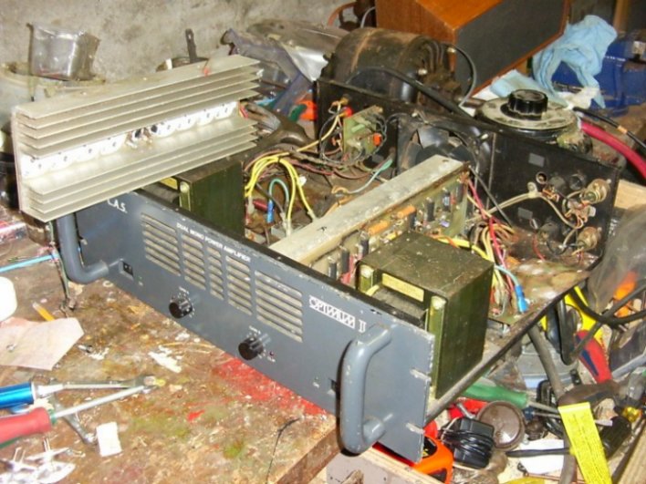

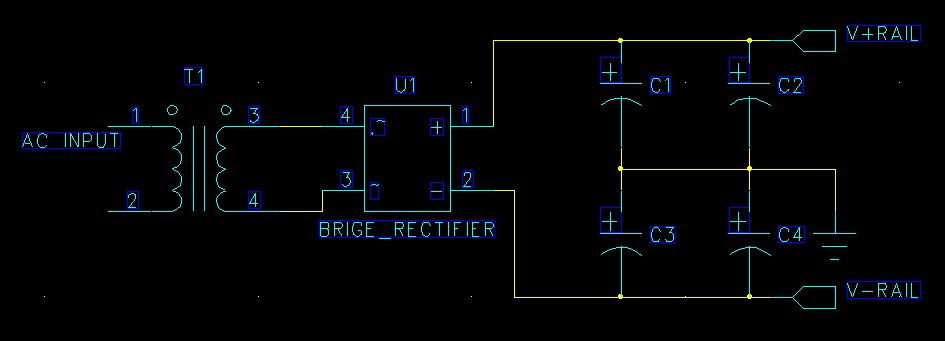

Hi group.
A friend just gave me one hell of a heavy power amp. It is a C.A.S Optimum II. I do believe it is a Canadian made amp.
Rear of casing says it is capable of 1200wrms in 8 ohm bridged. It is in fact a double mono block amp. Very heavy and big. It uses several MJ15025/24 outputs.
It needs care, few outputs and capacitors.
And my question:
The power supply seems unusual. The transfo dont have a center tap at its output. The ground is taken from the mid tap of 2 bank of capacitors (see my attached short schematic).
Also, all the T03 outputs dont have any mica isolators. I tought at first it was wrong since a lot of peoples played in it before me. But after i realised the power supply, it makes me wonder what is its design.
If you have any idea, let me know, id like to fix it !!
thanks

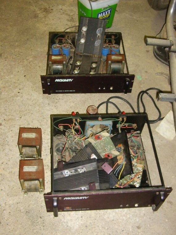

wow, super interesting !!
the schematics look a lot like what i have...

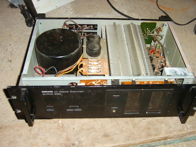

in the lot he gave me there is 2 Proximity model 500 and a Nikko Alpha 220, all dead, with missing outputs or main caps, but all fixeable with patience.
Any of these amps worth the time to fix them ? (inlcuding the QSC clone ) ?
thanks.
Ok, thanks.
One question remains...i do believe the transistor needs to be "matched " ?
all the base of the transistors are common, there is 6 npn/pnp per channel.
thanks for any other inputs.
btw, i will do a complete reverse of this amp.
Hi Pat,
What I am going to say is very important. Those Proximity amps are fire hazards. Don't even think about repairing them! They were made in Quebec. Count those as chassis for future projects.
The Nikko Alpha 220 should be rebuilt as something else. I have two and they don't sound great. The original outputs would be expensive to source. Main caps may have leaked. Alpha 440 and 450 are famous for doing exactly that. Someone here on teh forum built a leach clone in a 220 I think. The reports were that they turned out well. PCB layouts for your chassis too.

anatech said:
Hi Pat,
-Chris
Thanks for the advices for the Proximity amps, yes they were made in Quebec, well, in Montreal to be precise, which is 1 hour away from me. Those 2 amps were used in a disco mobile long time ago and they did the job well then, and yes, it looks like they turned into huge mess, nothing is good in them but the chassis, heat sinks and transfo. The guy who gave them to me is the original owner, he told me he used them for at least 10 years before they literaly melted :hot: That is back into the 80's :xeye:
I am defenitively rebuilding the QSC clone because it is far more simpler, and later the Nikko.
Thanks again.

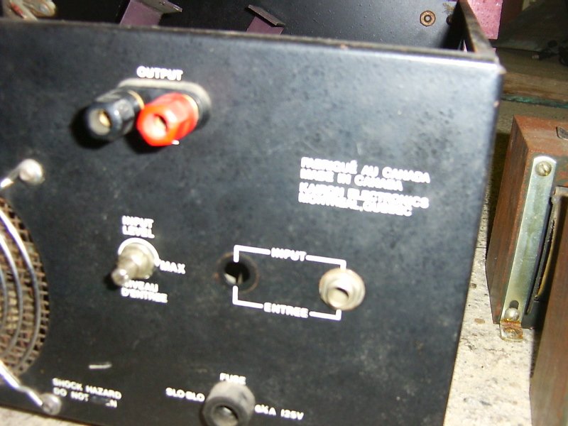

The back of the proximity, where we can see that they are manufactured in Montreal.
"KAIRON ELECTRONIC, MONTREAL" it says...
Also, there was a CSA sticker with " special approbation"
go figure...😉 :hot:

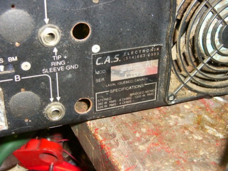

The back of the QSC clone (CAS)...yes, another amp made in Quebec (laval to be precise).
You can see also far left the bridging switch, and its optimistic power ratings...
Spec of the transfo are, for each channel, 110v in 130v out, 4amp.:smash: :dead: :att'n:
And, to finish...

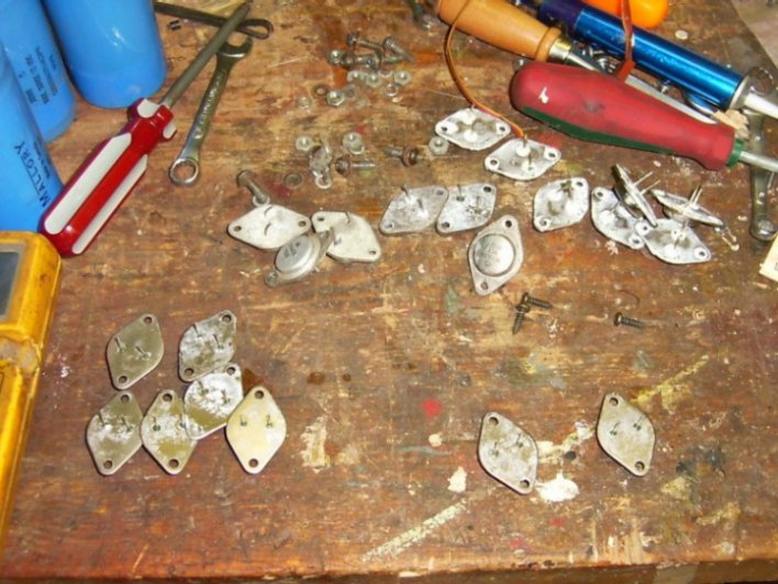

I made one channel of the C.A.S work, since none of its outputs are dead.
Sounds fair, no bad noises or bad smell. I will put it to test with resistive load to see if it can handle something.
We will see. I will downgrade it a bit, with the transfo of the Prox 500.
My plans are to use this amp in bridged mode with an Alpine dual voice coil 12 inch subwoofer (rated at 1000 wrms/3000peak), and a huge transmission line (know about El Pipo ?)
Thats gona be cool i think.

Hi Pat,
Those Proximities bring back a few nightmares! I kept one for it's chassis but lost it. Don't ask.
The little Nikko is a nifty little amp. I might try to fix it. As I said, they didn't sound great, but they looked neat.
-Chris
I have enough stuff to bring back to life the Prox 250 for free, i will try and if it works, i will see if i can add some active protections or any others improvement. But for now, i am focussed on the C.A.S for my El Pipo project 😀
