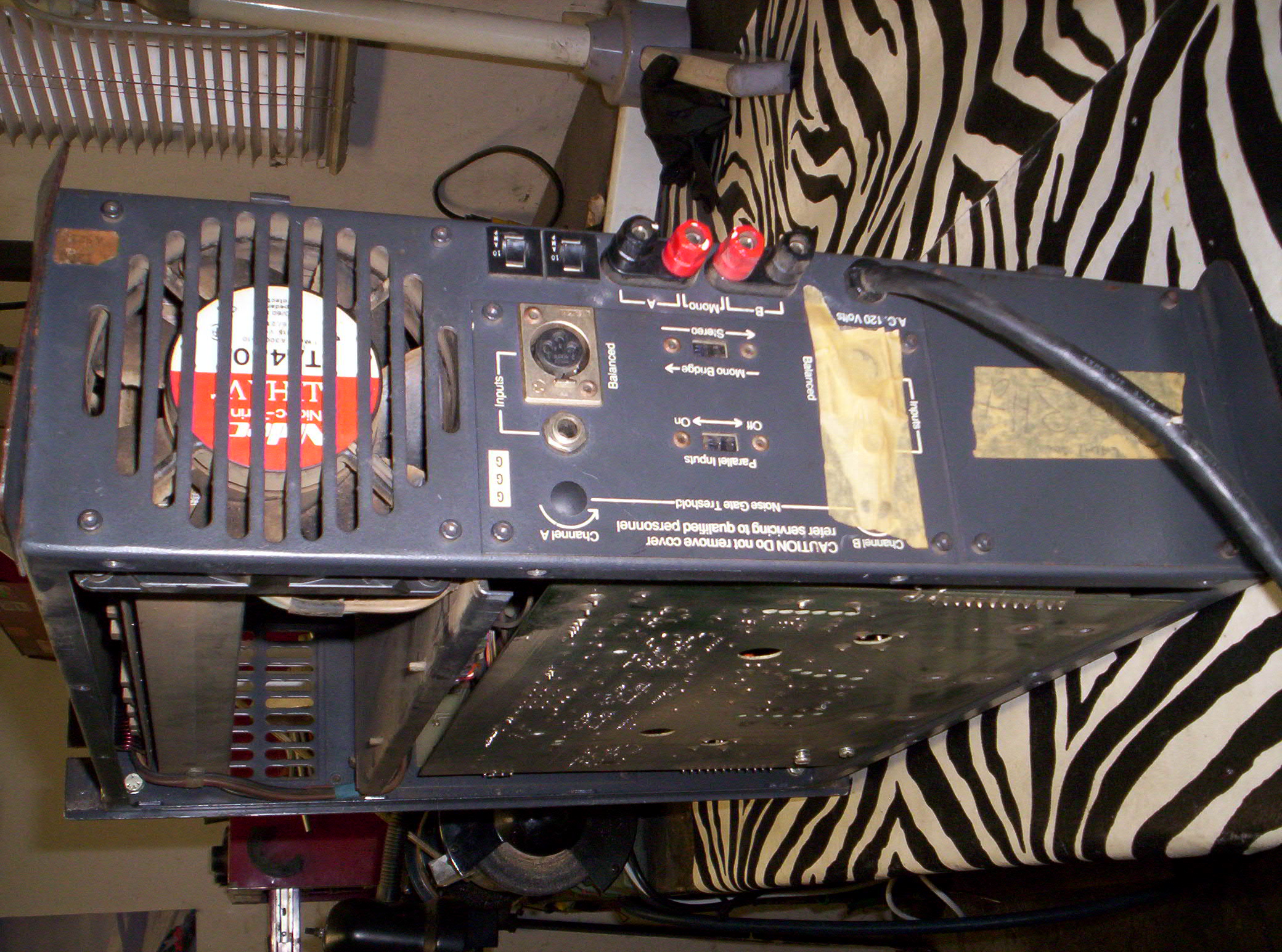

Guys, this pro PA amp. landed home, with a complete, missing output stage!...
I've looked everywhere, for even specs on those and, no joy.
This was aparently made in Quebec, Canada, but there are no man. date or address or anything else on the back.
It's a 600WPC rack mount beast, that's built like a tank Destroyer!...
Weights maybe around 60lbs, has forced-fan cooling.
Anybody knows this brand?!?

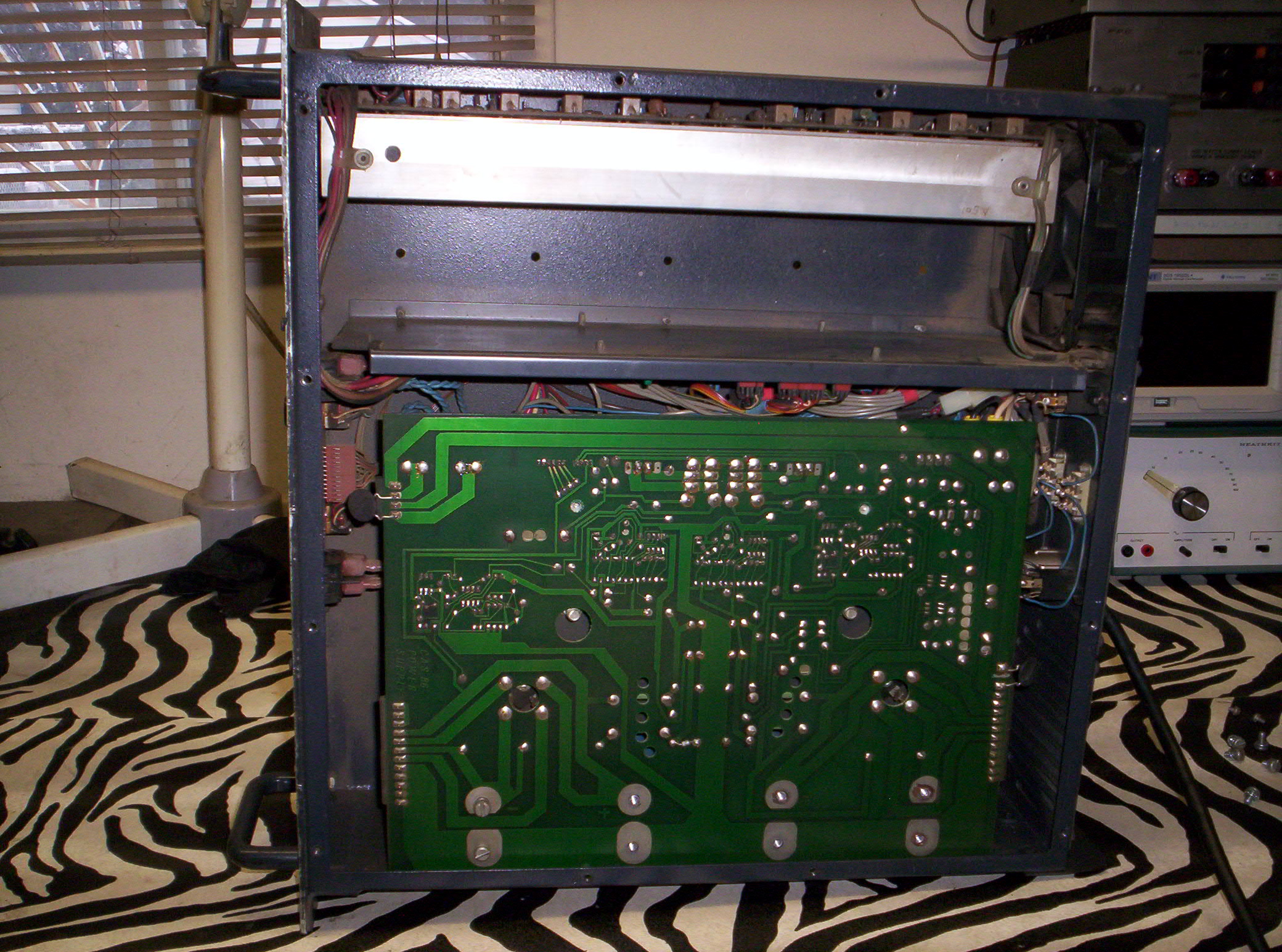

That's a lot more than an output stage. Those 24 pin dip patterns look irreplaceable.
Depending on power transformer (should be +- 60 v) you should be able to stuff a honey badger board in there on aluminum angle and some heat sinks with fins aligned with the air flow from front to back. But that is only 150 Watts. Probably you have +-80 v.
I can tell you now, PV-1.3k, PV2000 boards won't fit.

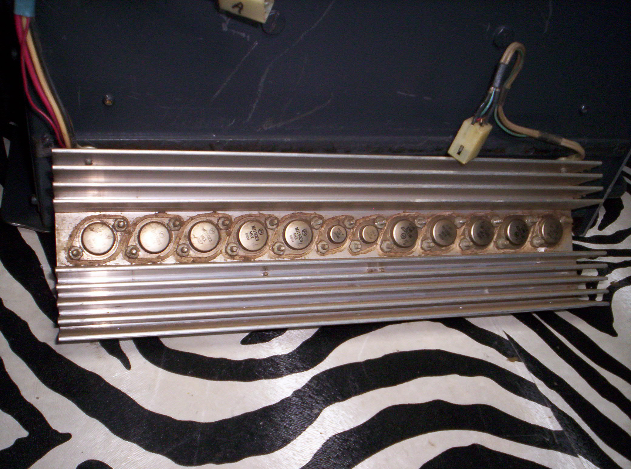

TO-220 ? are you referring to the RHS photo ?
The smaller ones are more like TO-66 .
The bigger ones are early version TO3,s . (domed )
TO-3= 30mm between fixing holes .
TO-66=24mm between fixing holes.
I would put it no later than the 80,s --probably 70,s .
Possibly movie theater amplifiers.

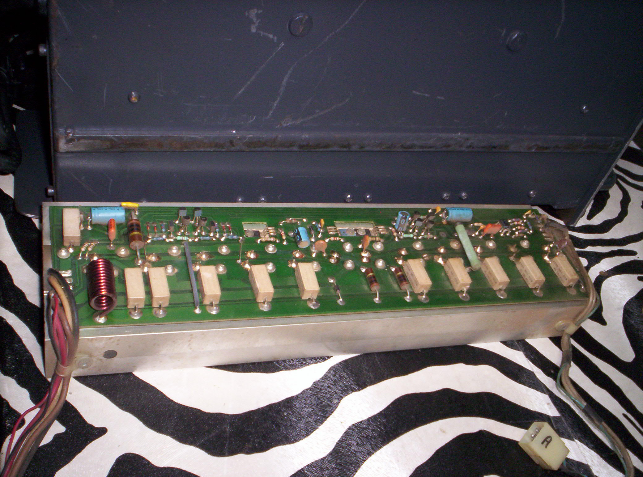

If you look at the center of the board, each side of this blue cap, there are those; JE340 JE350 and JE 182.
MJE340/350 are a On semi TO225 part that's been around for decades. Still in production. Good predriver. Download the datasheet from datasheetcatalog.com
Don't know about a MJE182
Well, at least the parts are all discrete transistors, resistors, capacitors.
Nothing exotic. You could trace the pcb artwork and copy it with a photo-etch process. Schematic black on transparent copier film. Disposing of the etch chemical legally is what keeps me from doing that. Only legal way, a 55 gal haz waste drum from Safetyklean, $450 down payment and $30 a month rental while you store it. Just handling a full 55 gal drum requires a forklift I don't have. To import a PCB from a vendor requires a eagle file, which means porting the layout to a computer.
But finding that huge heatsink with a flat in the middle, I don't know. heatsinksamerica doesn't list them I don't think. Plus accurately drilling four hole TO3 or even TO66 package patterns is beyond my skill with a hand drill motor. Drill bit tends to walk a bit in small sizes, go off the centerpunch location.
I suggest you look at the mains cap rating. 100 v is a tip off for +-80 or +-85 rails, which requires 5 pairs TO3 O.T. to last any time at full wattage - 600 it says.

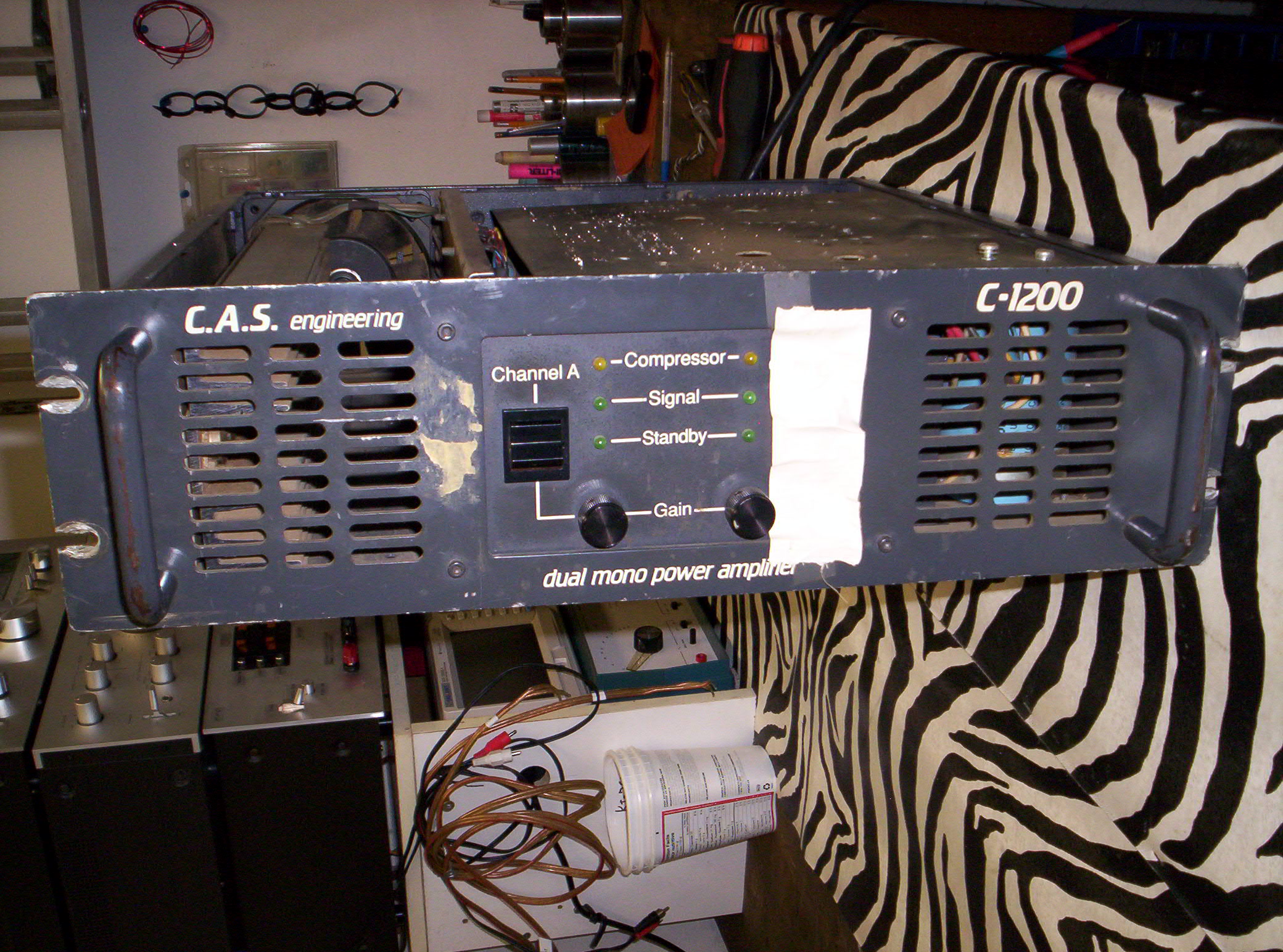

I was mostly wondering if there are doner amps or if you guys even know that brand?, there is absolutely nothing on the net regarding that amp.
Turboyam --I looked through Quebec,s electronic engineering data base ,no sign of that company but several larger companies have taken over smaller engineering companies but not all take-overs are listed .
- C.A.S. Engineering C-1200 pro. power amp???
